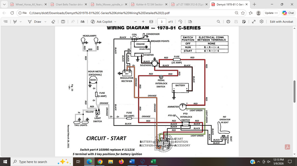

953 nut 69,475 #2 Posted May 9 I would ditch the Ammeter and just use a volt meter. Join the two wires going to the old ammeter and power the volt meter from the wire to the hour meter. Share this post Link to post Share on other sites
Razorback 1,370 #3 Posted May 9 2 minutes ago, 953 nut said: I would ditch the Ammeter and just use a volt meter. Join the two wires going to the old ammeter and power the volt meter from the wire to the hour meter. I'll consider that. Thank you. My C160 doesn't have an hour meter, but I would like to add one of those, too. Where would I tap to power that? (I could figure it out, but thought I'd ask....) Share this post Link to post Share on other sites
953 nut 69,475 #4 Posted May 9 Come off the "A" terminal of the ignition switch as shown in the drawing. If you have lights they should be coming from the "A" terminal and you can connect a wire to the light switch for power to the volt meter. 1 Share this post Link to post Share on other sites
