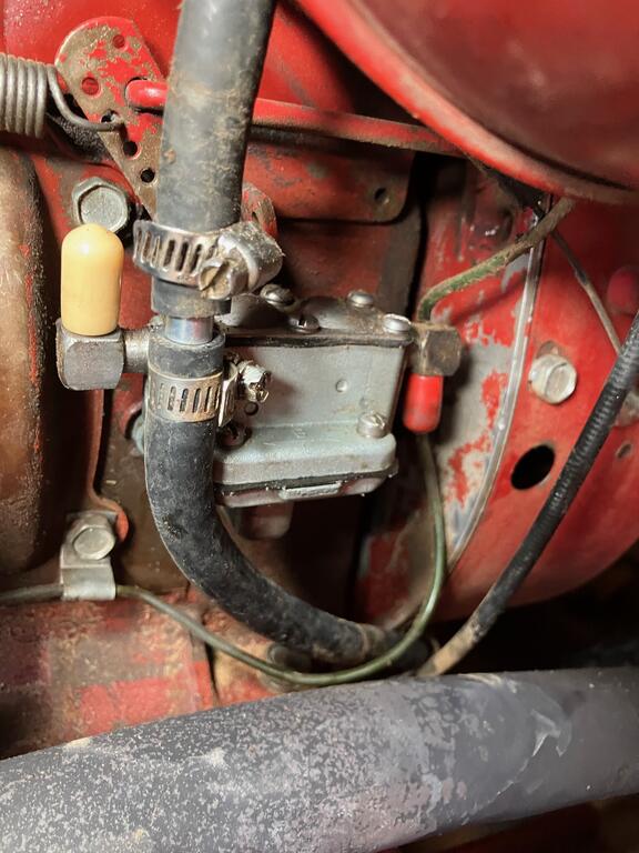

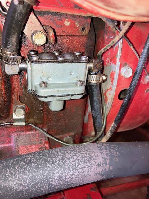

Razorback 1,370 #1 Posted May 5 I noticed that the fuel pump on my C160 is leaking. The attached pic is after I had wiped it with a rag. But it looked to me like it was leaking from the top cover area. In and out hoses are good. The pump has the letter B casted into it. I would appreciate suggestions for repairing what I have….. not real interested in converting to an electric pump, but I guess I could if necessary. Thank you! Share this post Link to post Share on other sites

ri702bill 12,583 #4 Posted May 5 (edited) Leaking oil or gas?? DO check your oil - pull the dipstick and smell it for raw gas... If present - fix the pump & change the oil before starting it.! Edited May 5 by ri702bill 2 Share this post Link to post Share on other sites

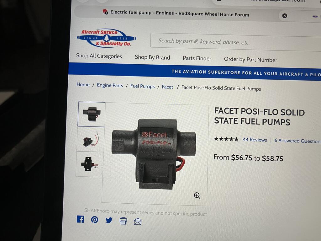

squonk 47,485 #5 Posted May 5 Better off with a Facet posit too electric. Easy to do. 1 2 Share this post Link to post Share on other sites

Razorback 1,370 #8 Posted May 6 (edited) 3 hours ago, ri702bill said: Leaking oil or gas?? DO check your oil - pull the dipstick and smell it for raw gas... If present - fix the pump & change the oil before starting it.! Leaking gas..... and it doesn't appear to be getting in the oil. It's running down the front of the block. Not pouring down, but wet and noticable gas smell in the shed. OK, OK..... please point me to a good how-to for the electric pump........ then I can compare and weigh the options. Thank you for the pointers. Edited May 6 by Razorback Share this post Link to post Share on other sites

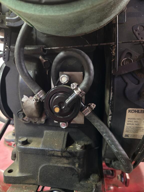

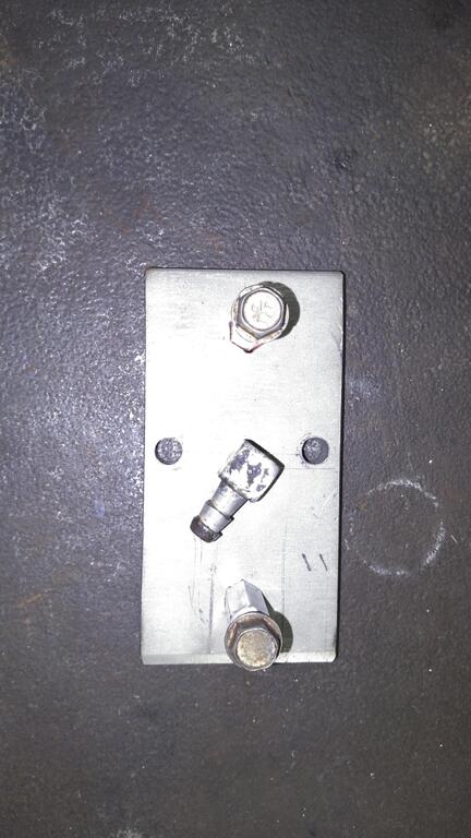

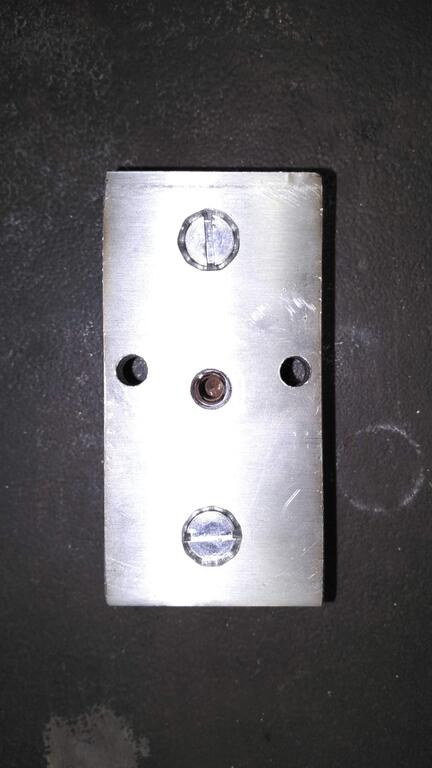

Bill D 3,014 #9 Posted May 6 I went this route. Kawasaki fuel pump. Homemade mounting plate. 3 2 Share this post Link to post Share on other sites

squonk 47,485 #12 Posted May 6 4 hours ago, Razorback said: Maybe I could consider this?? Electric fuel pump from O'Reilly No. This is the pump you want. https://www.dbelectrical.com/products/posi-flo-solid-state-fuel-pump-12v-1-5-4psi-12-min-dry-lift-23-gph-fpf-60104n.html 2 Share this post Link to post Share on other sites

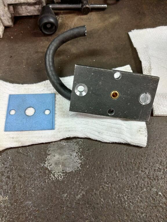

Bill D 3,014 #14 Posted May 6 Here's some better pictures of the mounting plate I made. If you go this route use a genuine Kawasaki pump. They are made in Japan by Mikuni. Much better quality than the Chinese knock off pumps. 1 1 Share this post Link to post Share on other sites
