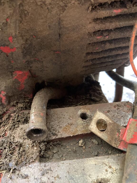

jhillbergen 8 #1 Posted May 4 My lift cable broke today at the end that threads into the trunion. The problem is that when it broke the cable recoiled (or something) and the remaining threaded portion got lodged into the raceway conduit in the curved portion. I've pushed and pulled but the cable won't budge. Does anyone know if there is a way to pull out the conduit for the lift cable without removing the transmission? Have attached a few pics Share this post Link to post Share on other sites
Ed Kennell 47,944 #2 Posted May 4 (edited) Could you make a flexible punch by threading a hand full of small nuts on a piece of wire and use that to drive out the obstruction? Did you clamp on the cable with a vise grip and use a flat pry bar to pull on the vise grip? Edited May 4 by Ed Kennell 2 Share this post Link to post Share on other sites
953 nut 70,652 #3 Posted May 4 Probably worth a call to Lowell to replace the conduit and cable. Gotta get a new cable anyway. https://wheelhorsepartsandmore.com/product/toro-wheel-horse-lift-cable-tube-108144-lift-cable-hydro-transmission/ 1 Share this post Link to post Share on other sites
Handy Don 17,735 #4 Posted May 4 (edited) I can see why you’d like to have the tube out to work on it. The tube is held in place by: 1. The clamp 2. The friction fit where it wedges into a stepped-diameter hole in the forward end of the transaxle housing (The stepped diameter makes it very difficult to use a punch to catch the edge of the tube. It is possible, though, and I’ve done it.) My first attempt would be to get some penetrant involved initially (both inside and outside the tube) and then a heavier lubricant inside. Following @Ed Kennell's thoughts, I’d look to using a tightly-coiled spring or other flexible but incompressible tool fed from the forward end. The tools used to prevent kinking when bending tubing come to mind. If you can get a firm grip on the tube without crushing it (maybe with a smooth end of a drill bit that fills the inner diameter and then vise-grips?), wriggling with the penetrant and pulling rearward will eventually free it. Edited May 4 by Handy Don Share this post Link to post Share on other sites

c-series don 12,752 #10 Posted May 5 I could be wrong, but I think the bolt hole in the picture goes right through into the transmission? If so it’s imperative that you do not get any dirt, grim or anything in that hole. 2 Share this post Link to post Share on other sites
DLF 74 #11 Posted May 5 (edited) I replace the tube on my 520-H when I got it. Cables cost too much to try and used a rusted tube, Lee1977 Edited May 5 by DLF 5 Share this post Link to post Share on other sites
oliver2-44 11,847 #12 Posted May 5 10 hours ago, jhillbergen said: While you have the seat pan off temporarily plug that threaded hole (that goes into the transmission and give that Eaton transmission a good cleaning. It helps them dissipate heat which helps extend their life. Also give the area where the transmission control linkage on top a good gentle cleaning. 1 2 Share this post Link to post Share on other sites
lynnmor 9,081 #13 Posted May 5 7 hours ago, c-series don said: I could be wrong, but I think the bolt hole in the picture goes right through into the transmission? If so it’s imperative that you do not get any dirt, grim or anything in that hole. The bolts on top of the transmission should never be removed till after a thorough cleaning, and then brush away debris as bolts are removed. Wheel Horse suggests removing a bolt to aid filling the transmission but I always thought that they were asking for trouble. 3 Share this post Link to post Share on other sites

jhillbergen 8 #15 Posted May 5 3 hours ago, lynnmor said: The bolts on top of the transmission should never be removed till after a thorough cleaning, and then brush away debris as bolts are removed. Wheel Horse suggests removing a bolt to aid filling the transmission but I always thought that they were asking for trouble. Thanks for the advise I didn"t realize that the holes went all the way through! Hope debris didn"t fall down in 1 Share this post Link to post Share on other sites
jhillbergen 8 #17 Posted May 5 Thought I'd give everyone an update. Using the advise from Handy Don, I was able to put a drill bit into the end of the conduit and grab it with a pair of vise grips. After a ten minute tug of war with my wheelhorse, I was able pull out the conduit (with the remaining cable still wedge inside). A new conduit was ordered (along with a new lift cable) after I spent another 20 minutes farting around trying to get the wedged cable out. Thanks for all of your suggestions 3 3 Share this post Link to post Share on other sites
