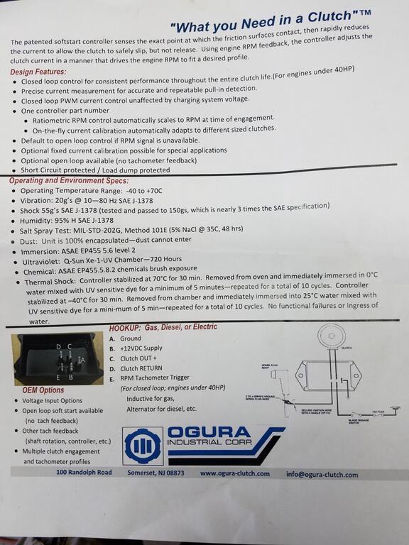

midpack 1,148 #30 Posted May 3 12 hours ago, ineedanother said: I've not seen that and would be interested if you have any current insight... Search electric pto engagement mod. Here's what I used 2 1 1 Share this post Link to post Share on other sites
kpinnc 18,960 #31 Posted May 4 15 hours ago, midpack said: Here's what I used I have used these as well. Mine has been working great on my zero turn for 5+ years with no issues. They are more expensive than they used to be, but worth it. Share this post Link to post Share on other sites
Bill D 3,156 #32 Posted May 4 What do you hook up to the tach input? Is there an additional part you need? Share this post Link to post Share on other sites

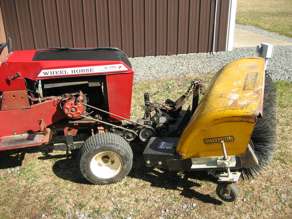

pfrederi 21,150 #34 Posted May 4 25 minutes ago, WHX?? said: Another question for you electric PTO guys. When you engage it what is your throttle setting? idle? half throttle? Mine about bucks me off when i flip the switch. I have to use an electric PTO with my sweepster as the C-175 she is on has a very tired out KT-17 from a JD 317. Just above idle and it is still a bit rough 2 1 Share this post Link to post Share on other sites

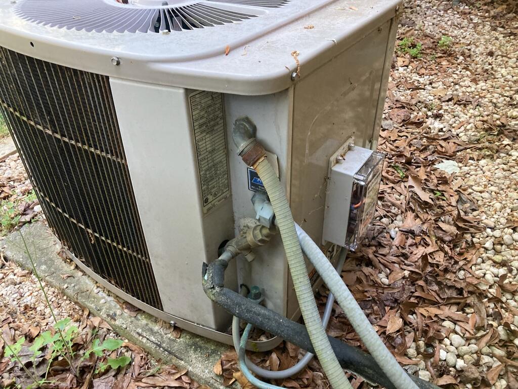

ineedanother 2,864 #35 Posted May 4 (edited) 23 hours ago, midpack said: Here's what I used Definitely worth considering. I know I'm talking apples to oranges here, but I installed a soft-start on my older air conditioning unit on my house in order to run on generator and the LRA went from over 90A to under 10! Not cheap but worth it. Opinions regarding extending the life of the unit vary but I can't imagine it not being positive. 35 y/o 2 ton Carrier. Edited May 4 by ineedanother 1 Share this post Link to post Share on other sites

kpinnc 18,960 #37 Posted May 4 2 hours ago, WHX?? said: Another question for you electric PTO guys. When you engage it what is your throttle setting? idle? half throttle? The soft start controller senses engine RPM and engages accordingly. It's like antilock brakes. Engages with pulses beforehand. 2 Share this post Link to post Share on other sites
