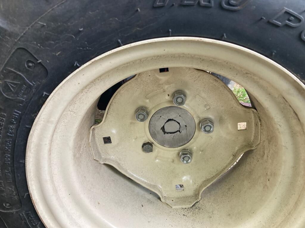

ineedanother 2,864 #1 Posted May 2 I figured I would start a new thread here since I've never seen this before. This 16 auto came in a package deal as a bit of a bonus IMO. It's nearly original, smoke-free k341, straight metal, hydraulics work but the lift cylinder leaks and I haven't investigated that yet. The biggest issue is that a slipping hub was welded to the axle . It should be a 10 pinion LSD and has 1 1/8" axles. I have a spare gearbox on the shelf but want to see how bad this axle actually is... Share this post Link to post Share on other sites
ebinmaine 80,695 #2 Posted May 2 4 minutes ago, ineedanother said: 10 pinion LSD That was the changeover year. Might have a standard 8 speed open differential. 5 minutes ago, ineedanother said: biggest issue is that a slipping hub was welded to the axle Carefully cut your existing hub off. Get a clamp on hub from Lincoln at A to Z Tractor in PA. 3 Share this post Link to post Share on other sites

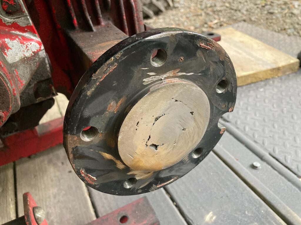

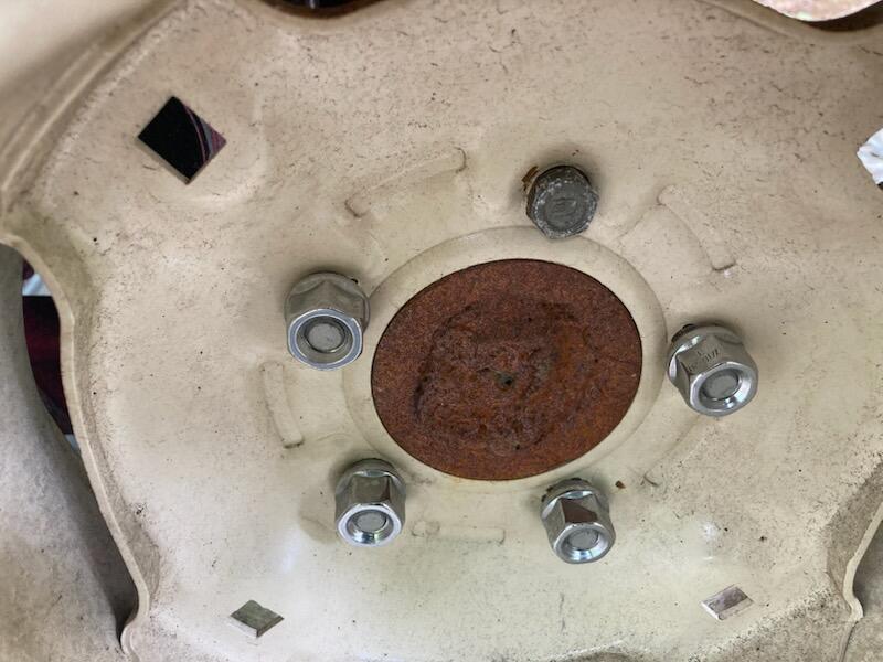

ineedanother 2,864 #7 Posted May 2 Some 24 grit grinding got me down to the axle but whoever did this evidently did quite a bit to chamfer the inside of the hub to lay a bunch of weld in there. I'm about to put the puller on it and see what gives. I'm thinking there won't be much to save given what I see at this point. 3 Share this post Link to post Share on other sites
ineedanother 2,864 #8 Posted May 2 I don't have my big impact driver here so I might just put the wheels back on and go pop some wheelies 3 Share this post Link to post Share on other sites
ebinmaine 80,695 #9 Posted May 2 Get a metal blade in ya sawzall and go at it. Share this post Link to post Share on other sites

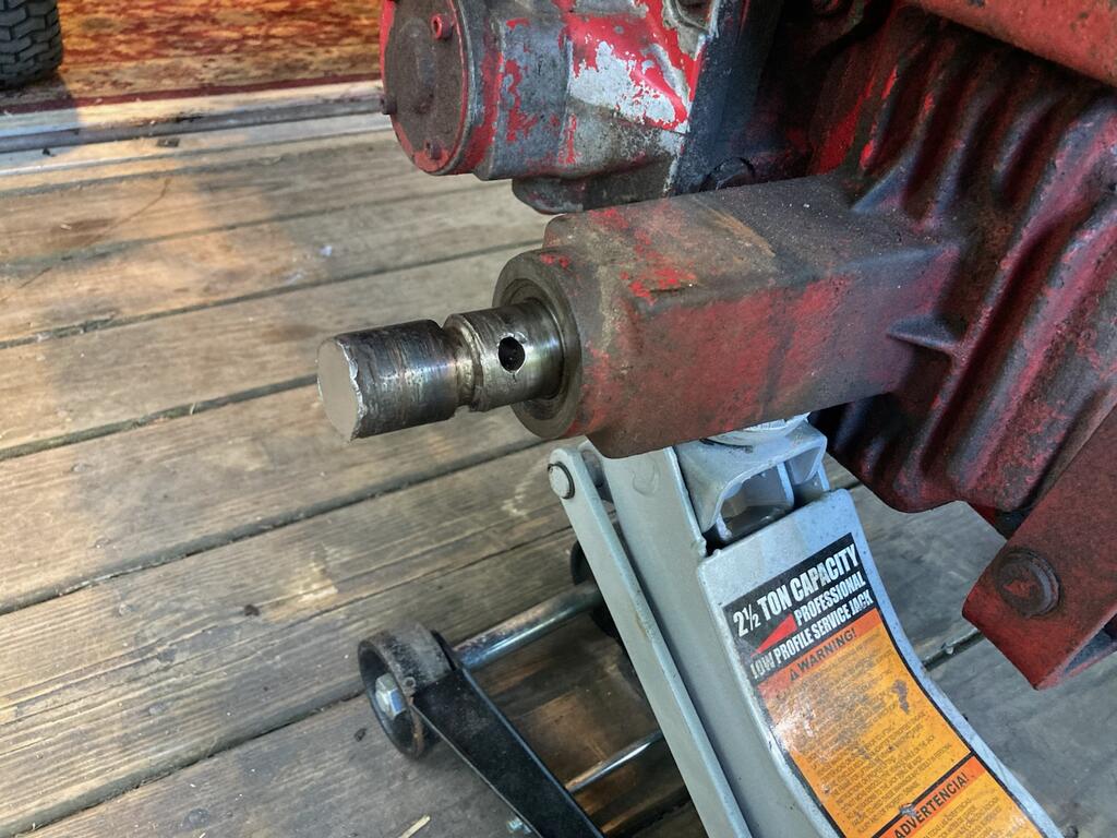

ineedanother 2,864 #10 Posted May 2 (edited) Well, I pulled the set screw, there was no key there so I spun the wheels and it broke loose. Now to look and see what I've got... Edited May 2 by ineedanother 3 Share this post Link to post Share on other sites
ineedanother 2,864 #11 Posted May 2 It cam right off once it was broken loose and is pretty much what I expected, but was hoping I wouldn't find. Unsalvageable axle. 8 Share this post Link to post Share on other sites
ebinmaine 80,695 #12 Posted May 2 10 minutes ago, ineedanother said: Unsalvageable axle 2 hours ago, ebinmaine said: Get a clamp on hub from Lincoln at A to Z Tractor in PA. Share this post Link to post Share on other sites
WHX?? 58,120 #13 Posted May 2 I would think a A-Z clamp on might work on that. Sure he don't give them away but you figure by the time you find a replacement and taking it all apart??? Weld the hole shut file smooth?? 1 Share this post Link to post Share on other sites
ineedanother 2,864 #14 Posted May 3 15 minutes ago, WHX?? said: I would think a A-Z clamp on might work on that. Sure he don't give them away but you figure by the time you find a replacement and taking it all apart??? Weld the hole shut file smooth?? I think I would give A-Z a shot if I didn't have another one sitting right here but swapping it out is hard to argue against since that one has been rebuilt. I know what I have now which was today's exercise. 2 Share this post Link to post Share on other sites
Bar Nuthin 3,223 #15 Posted May 3 (edited) I had bad axles on my C-120 Auto. I used the clamp on hubs as a repair, but they too eventually began to slip - while doing some heavy plowing. I ended up replacing the differential assembly (w/good axles). A member here had some spares and made me a good deal. Was an easy fix. You can remove the RH transaxle casing (on the tractor) while leaving all the gears in place. I went ahead and installed new axle seals while I was at it. And, of course, you'll need to replace at least one hub. Edited May 3 by Bar Nuthin 2 Share this post Link to post Share on other sites

ineedanother 2,864 #17 Posted May 3 2 minutes ago, Bar Nuthin said: I had bad axles on my C-120 Auto. I used the clamp on hubs as a repair, but they too eventually began to slip - while doing some heavy plowing. I ended up replacing the differential assembly (w/good axles). A member here had some spares and made me a good deal. Was an easy fix. You can remove the RH transaxle casing without while leaving all the gears in place. I went ahead and installed new axle seals while I was at it. And, of course, you'll need to replace at least one hub. Yeah, I think I actually have bearings and seals here which is why I was hoping the axle was salvageable. I have a milling machine at work and could have cut a new keyway in that axle had it not been butchered to this extent. 2 Share this post Link to post Share on other sites

WHX?? 58,120 #19 Posted May 3 12 minutes ago, Bar Nuthin said: I used the clamp on hubs as a repair, but they too eventually began to slip I was under the understanding they were bullet proof? Maybe not?? 10 minutes ago, ineedanother said: have a milling machine at work and could have cut a new keyway in that axle You stlll could ... remove it build it back up with weld, turn it to size and cut keyway. Course all that work I have Sunnys I was gonna damn near give away at the BS. Share this post Link to post Share on other sites

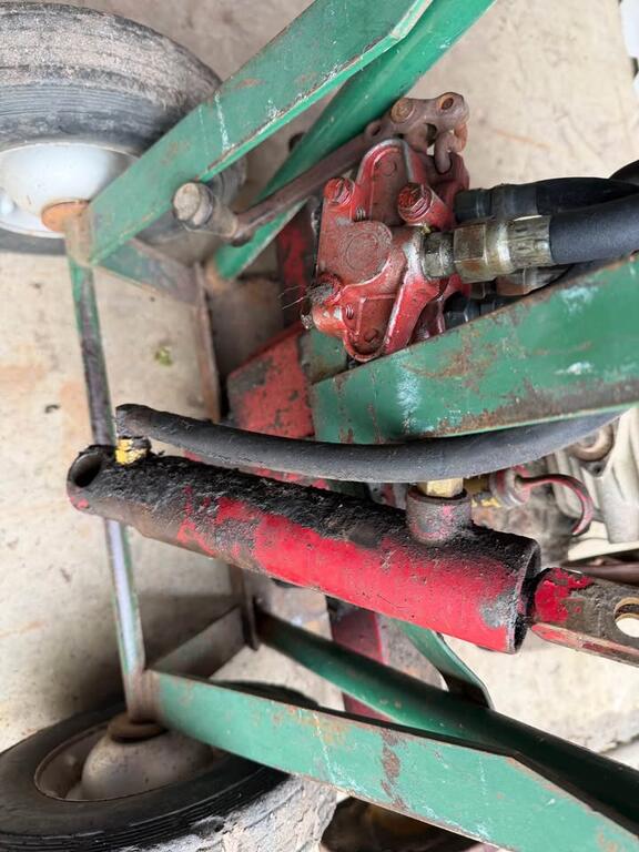

ineedanother 2,864 #20 Posted May 3 1 minute ago, Bar Nuthin said: Too bad you're not closer. I just picked up a rear end from a C-160 that looks to have good axles. I bought it for the hydraulic lift components. That's a good find and somewhat rare here in NC. I have a couple and really like them. I've torn them down and cleaned them up so I understand the engineering and physics. That welded cylinder is a challenge now for me. I think at this point there is good value in the cylinders with the threaded end to make rebuilds easier, not requiring cutting and re-welding. 4 Share this post Link to post Share on other sites
ineedanother 2,864 #21 Posted May 3 9 minutes ago, Bar Nuthin said: Too bad you're not closer. I just picked up a rear end from a C-160 that looks to have good axles. I bought it for the hydraulic lift components. I'll tear this one down at some point and look for an axle if everything else checks out. Not sure I'll go to the extent of welding and turning. We don't have a lathe big enough in our shop at work (not a machine shop, just maintenance). 3 Share this post Link to post Share on other sites
Bar Nuthin 3,223 #22 Posted May 3 3 minutes ago, ineedanother said: That welded cylinder is a challenge now for me. I think at this point there is good value in the cylinders with the threaded end to make rebuilds easier, not requiring cutting and re-welding. I sent one of the welded cylinders to Lowell at wheelhorse parts and more. He cuts them open and refurbishes them. Came back good as new, maybe better. I now have a few of each type. I just ordered two seal kits for the serviceable type. 2 Share this post Link to post Share on other sites

WHX?? 58,120 #24 Posted May 3 1 minute ago, ineedanother said: I'll tear this one down at some point and look for an axle Prolly your best bet if your not afraid to tear into it. What kinda shape is the hub in. Guessing trashed?? 3 Share this post Link to post Share on other sites
ineedanother 2,864 #25 Posted May 3 4 minutes ago, Bar Nuthin said: I sent one of the welded cylinders to Lowell at wheelhorse parts and more. He cuts them open and refurbishes them. Came back good as new, maybe better. I now have a few of each type. I just ordered two seal kits for the serviceable type. Yeah, that's great that he does that. I sent one to him but he felt like the pitting on the rod was too much so I just replaced it. Not many places will touch that for what he charges so huge kudos to him for doing that for us. 3 Share this post Link to post Share on other sites
