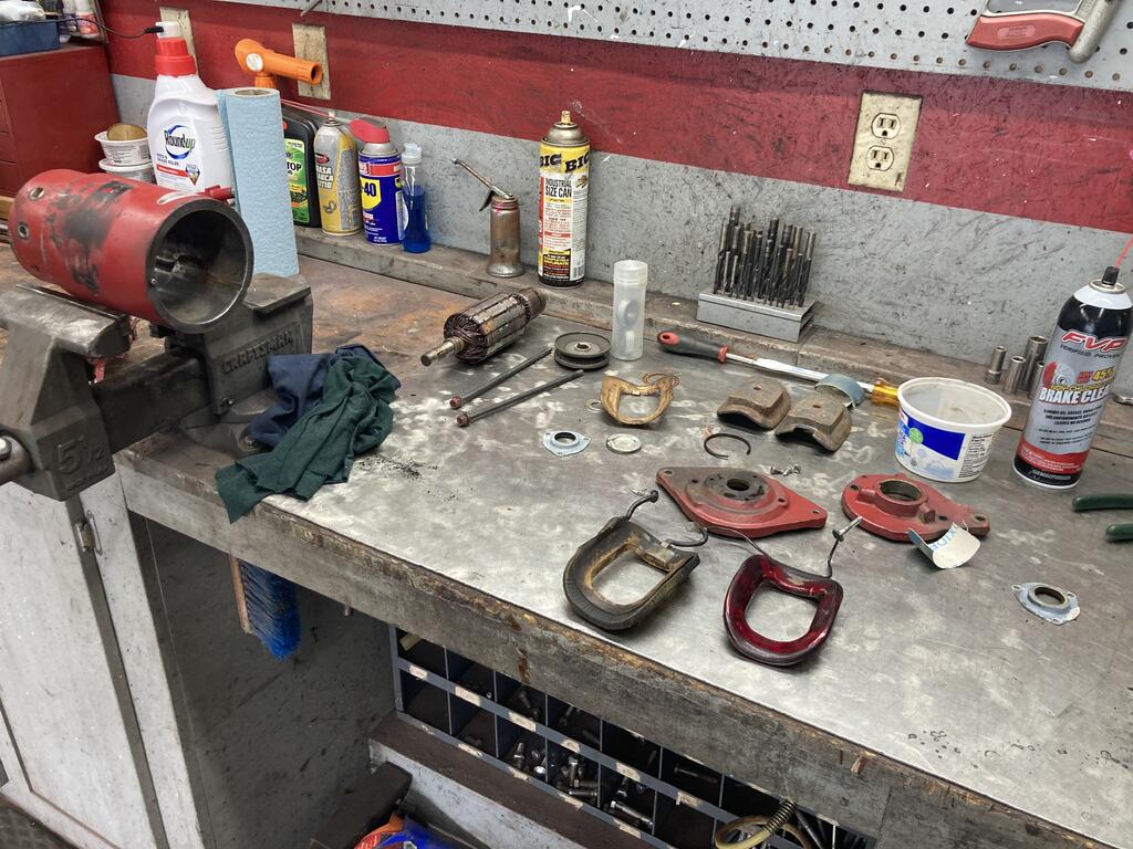

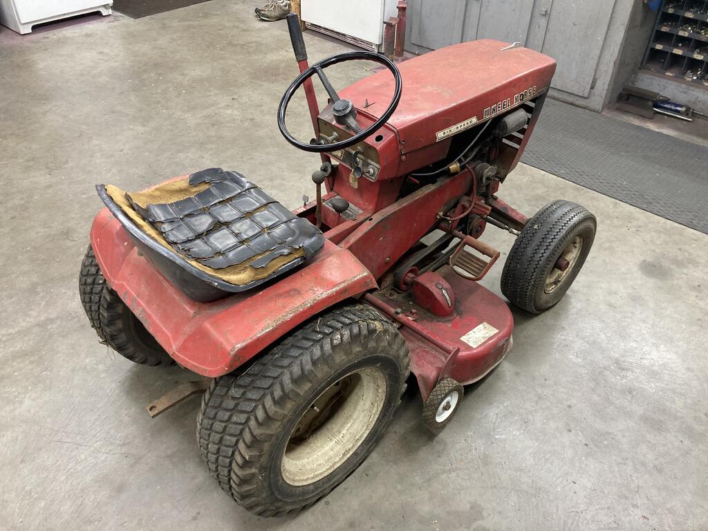

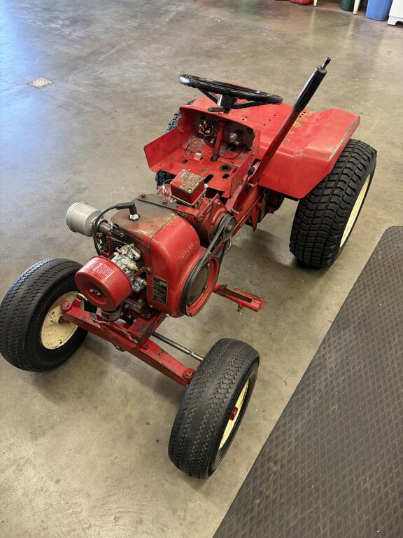

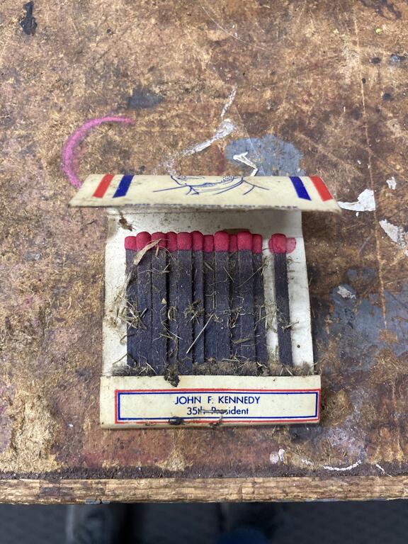

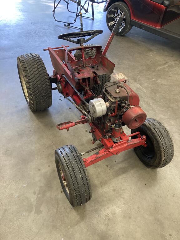

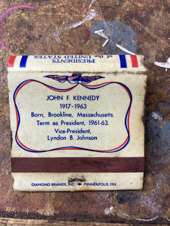

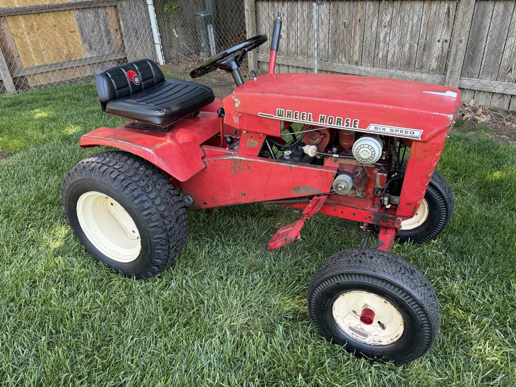

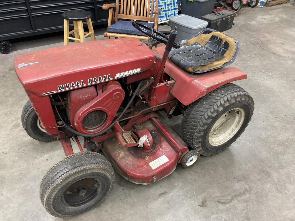

dclarke 4,274 #1 Posted May 1 I picked up a well worn 867 several months ago. Took it apart to determine what I had to work with and started a list of parts I’d need to bring it back to life. I Found the matches under the fender pan. 8 6 1 2 Share this post Link to post Share on other sites
sqrlgtr 3,736 #2 Posted May 1 That's pretty cool find to go along with a cool tractor. 2 Share this post Link to post Share on other sites

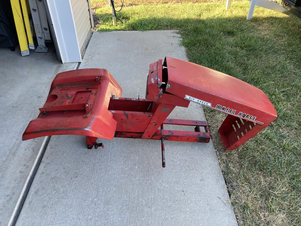

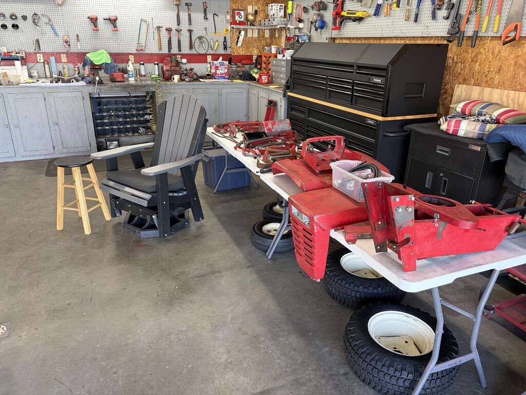

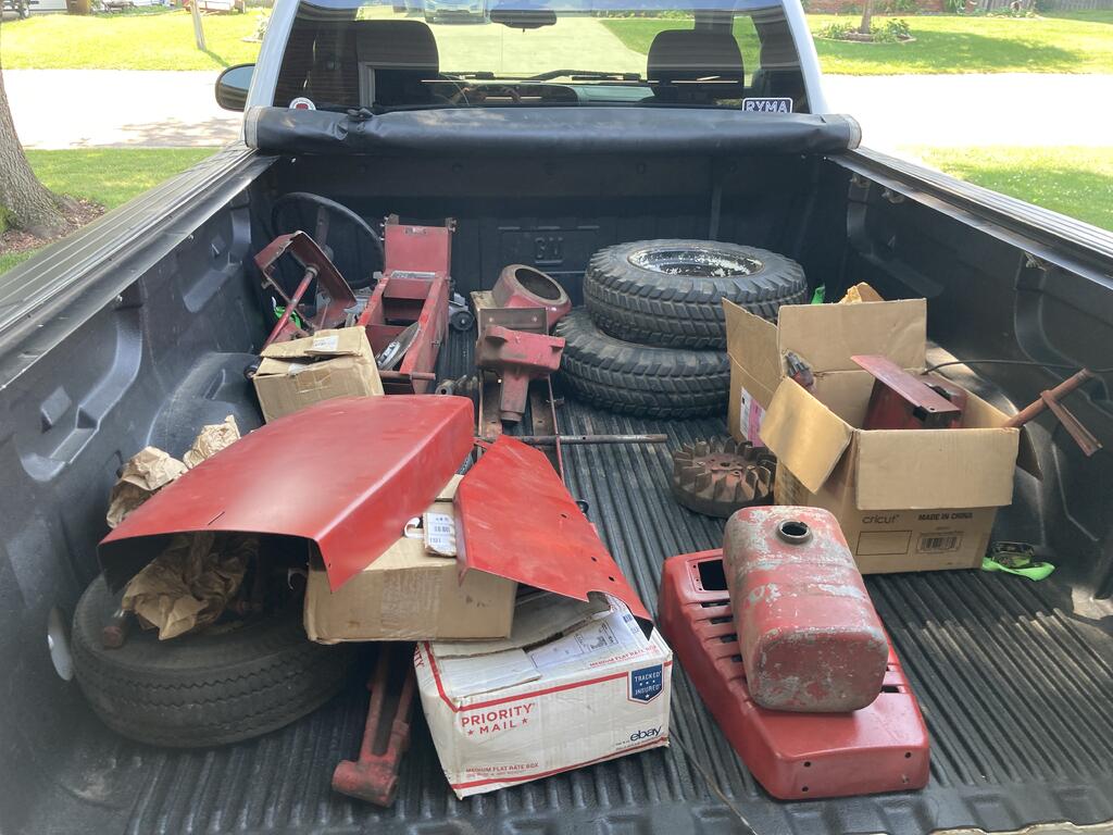

dclarke 4,274 #3 Posted May 1 This tractor needed a lot of repair or replacement parts so I met up with a buddy who supplied me with most all the parts needed to put a nice tractor together. 1 14 Share this post Link to post Share on other sites

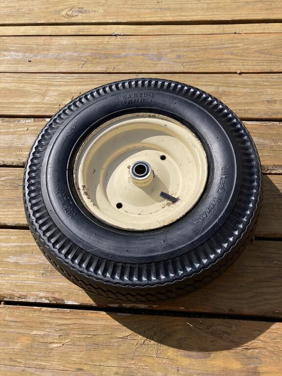

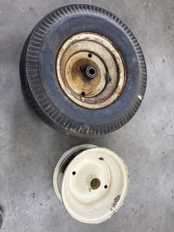

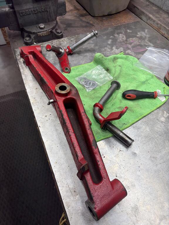

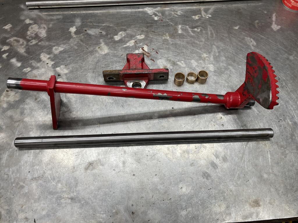

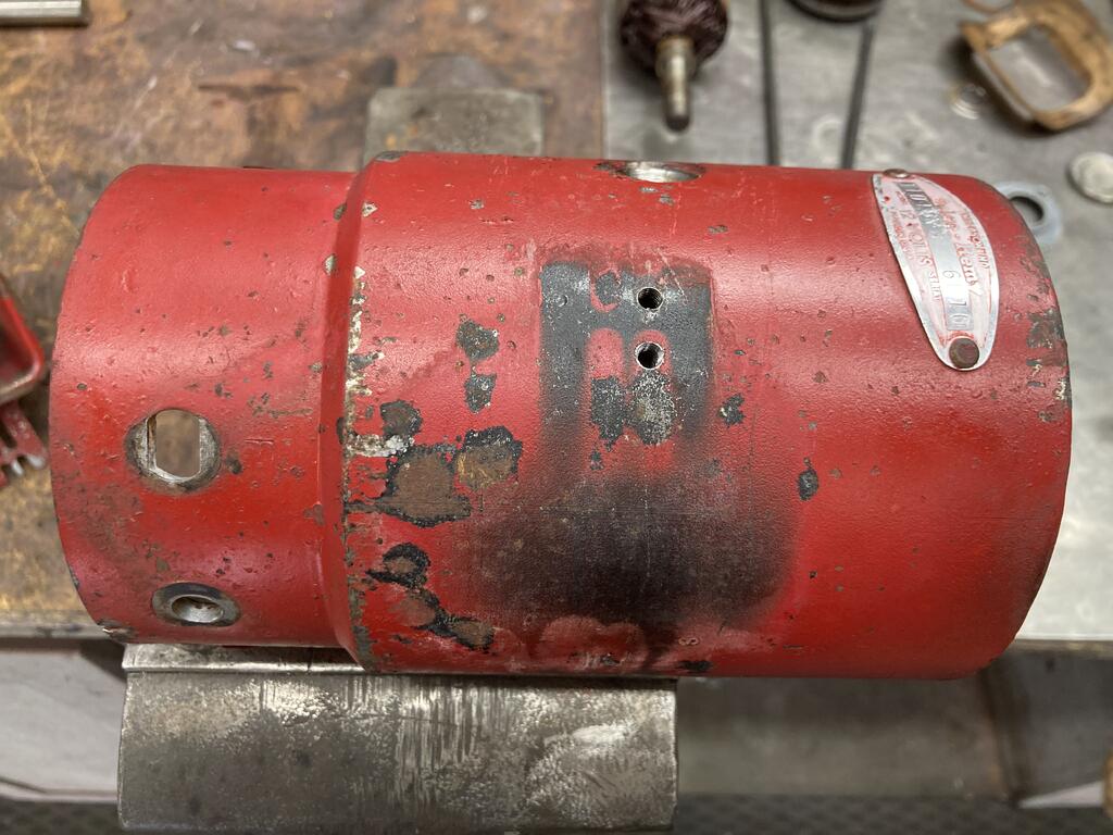

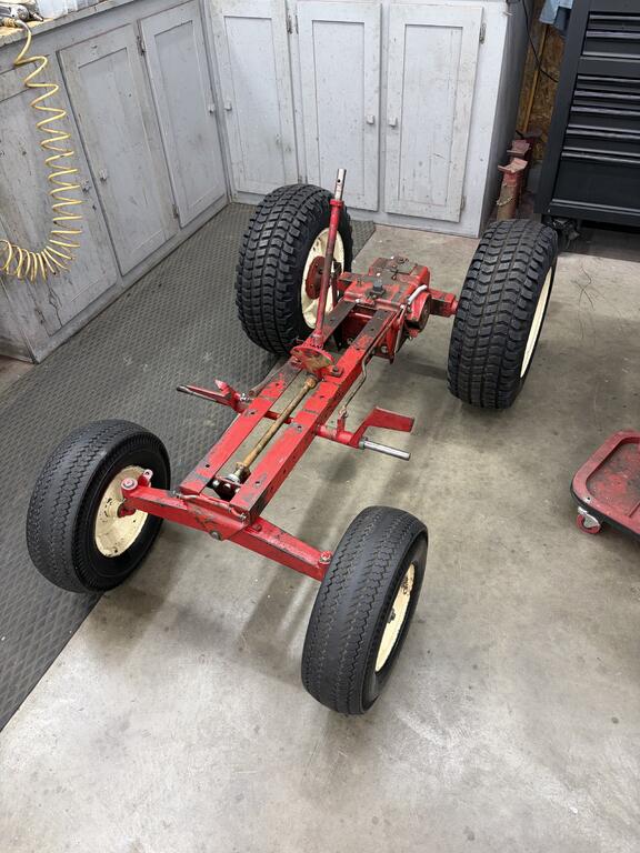

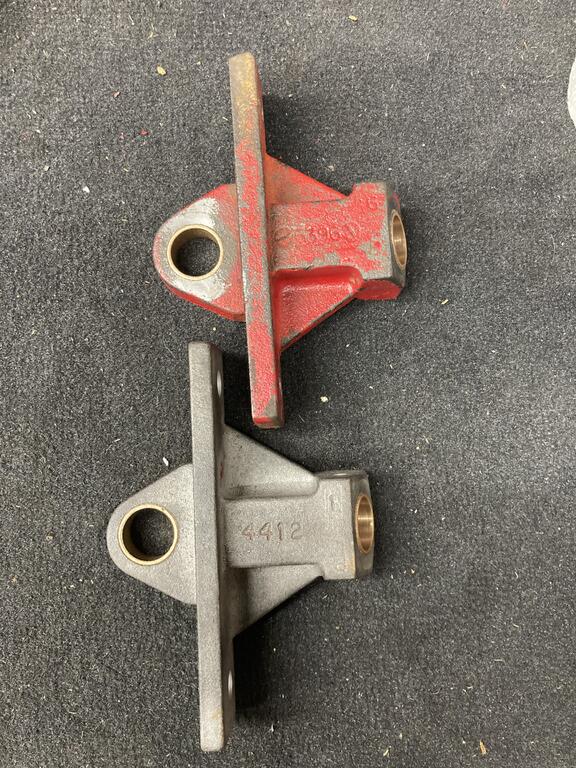

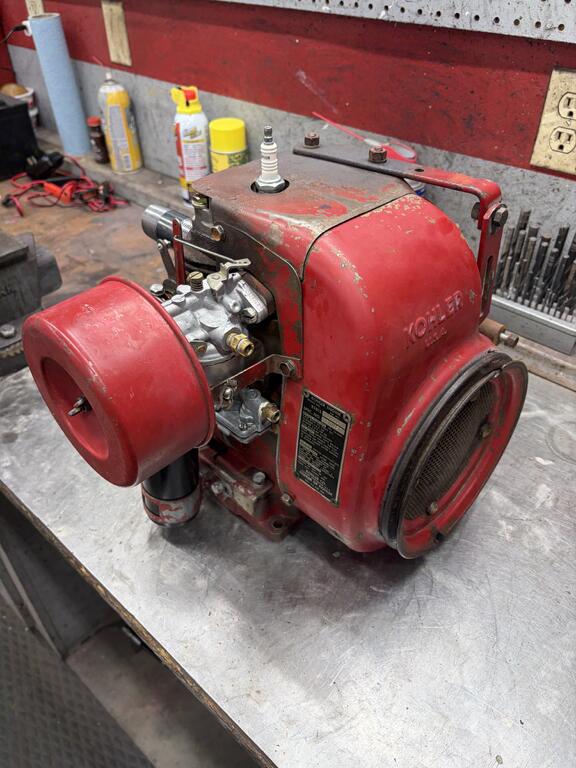

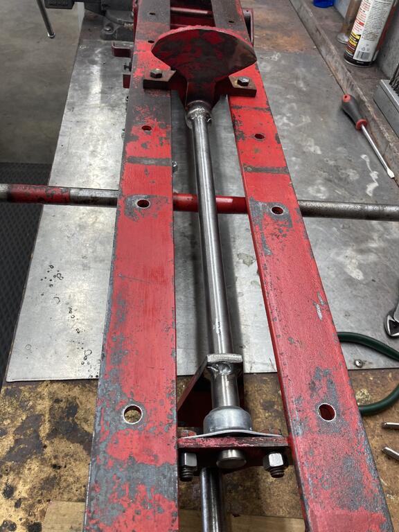

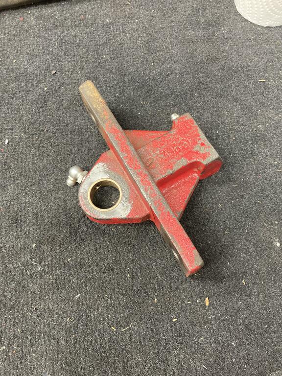

dclarke 4,274 #4 Posted May 1 (edited) Last fall I found a decent set of 5.50 front tires, I got all 4 rims cleaned up, new tubes and a coat of Miller’s tire paint and got those ready to go. I was also able to make any repairs to the tins and frame before winter set in, the lower steering shaft was replaced and I had new bushings installed in a couple lower supports and added a zerk to the bottom bushing on the support I used on this project. I got the motor generator refreshed, while it was apart I drilled & tapped new regulator mounting holes to move the regulator terminals a bit farther away from the gas tank then filled the original holes with epoxy. Edited May 1 by dclarke 2 11 Share this post Link to post Share on other sites

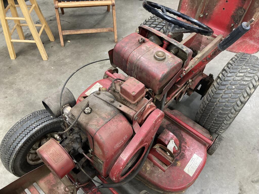

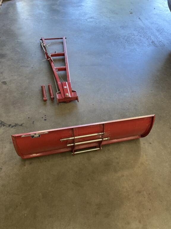

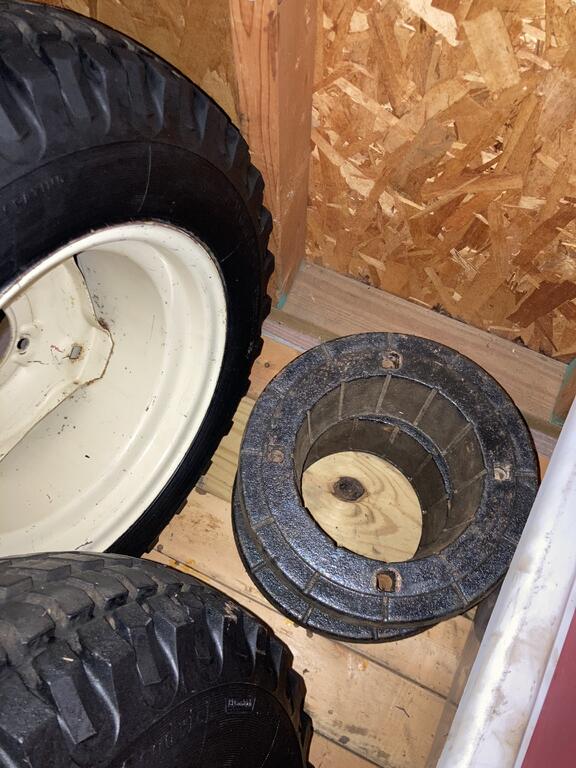

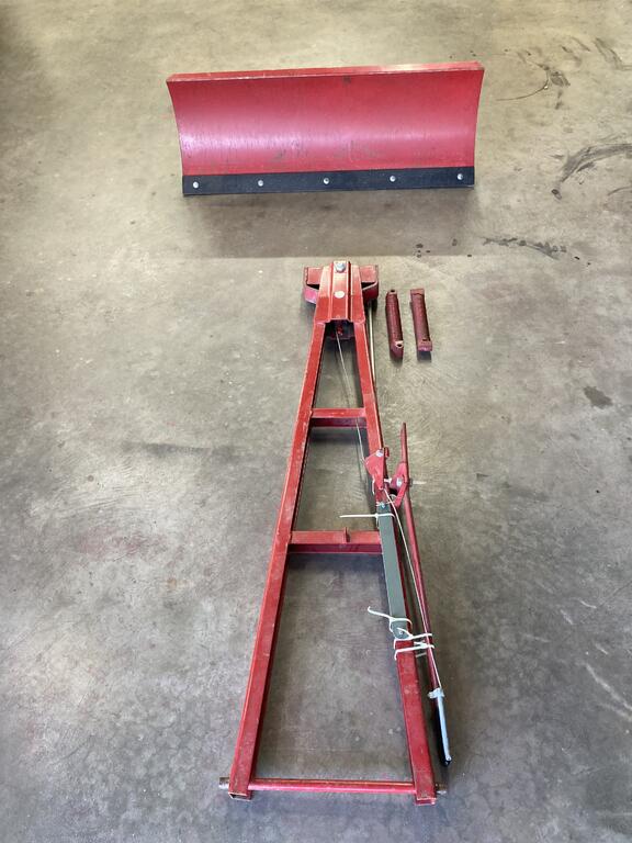

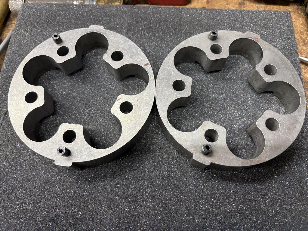

dclarke 4,274 #5 Posted May 1 I thought I might play in the snow with this tractor so I picked up some weights and a very nice blade. 4 9 1 Share this post Link to post Share on other sites

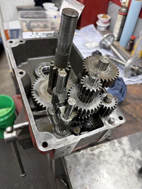

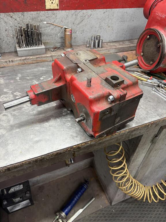

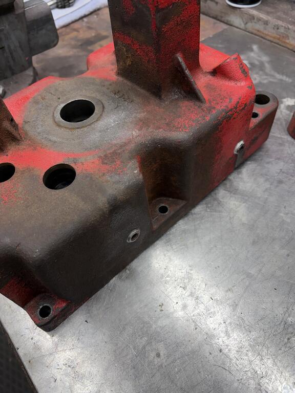

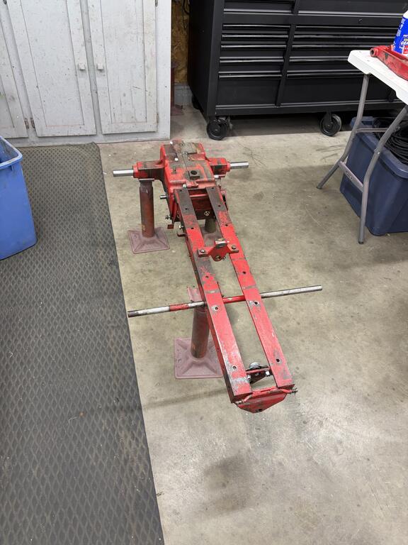

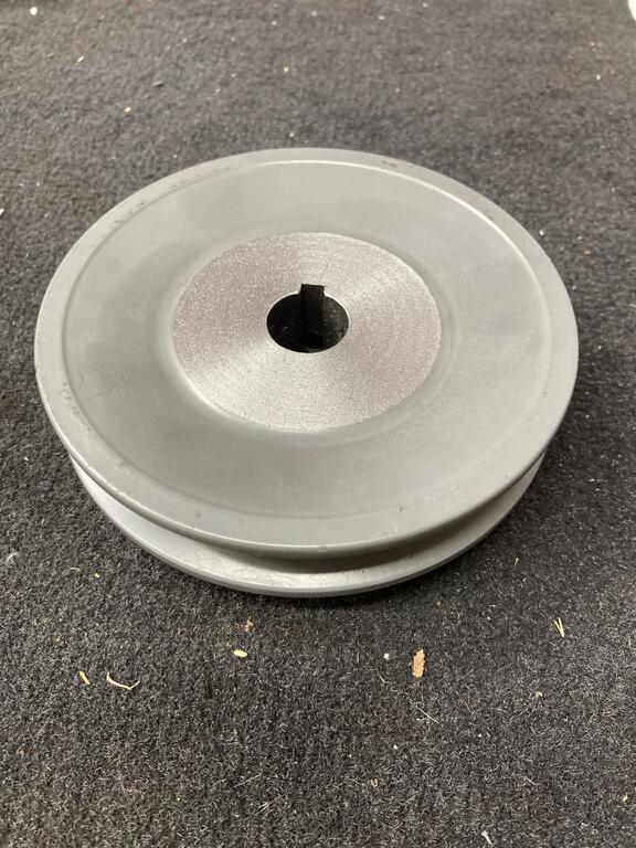

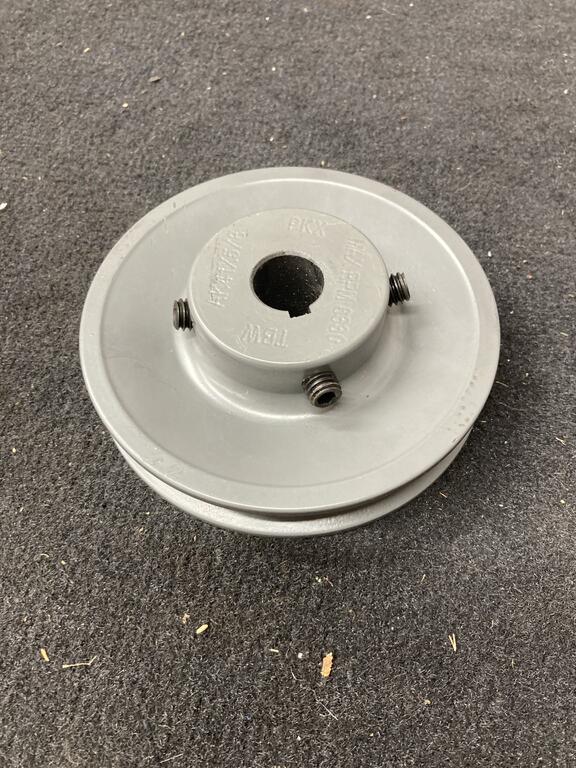

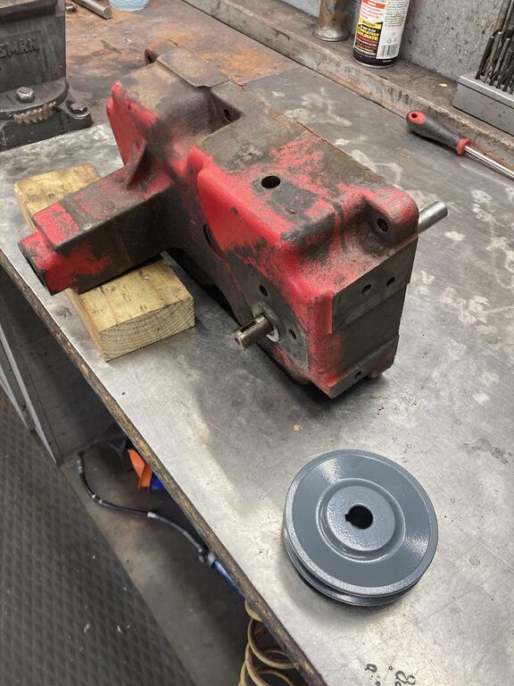

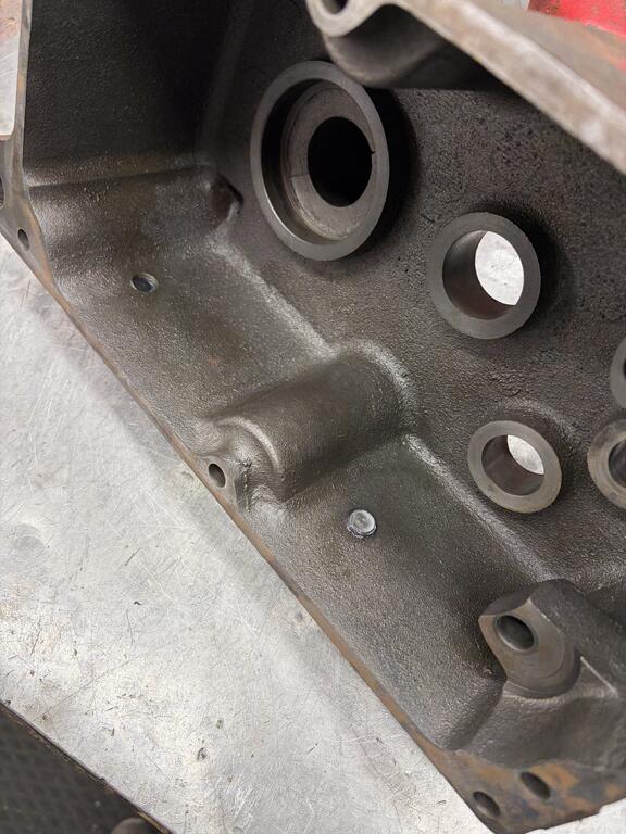

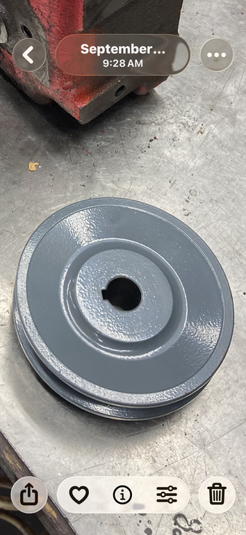

dclarke 4,274 #6 Posted May 1 A few months ago I got the tranny apart, found some nice gears to replace bad ones and had to get a new pulley for the 5/8” input shaft. The hub on front of the pulley needed turned down to allow belt alignment so I had that done and then added a couple more set screws to help hold it in place. I also added a second drain plug to the tranny case. 5 10 Share this post Link to post Share on other sites

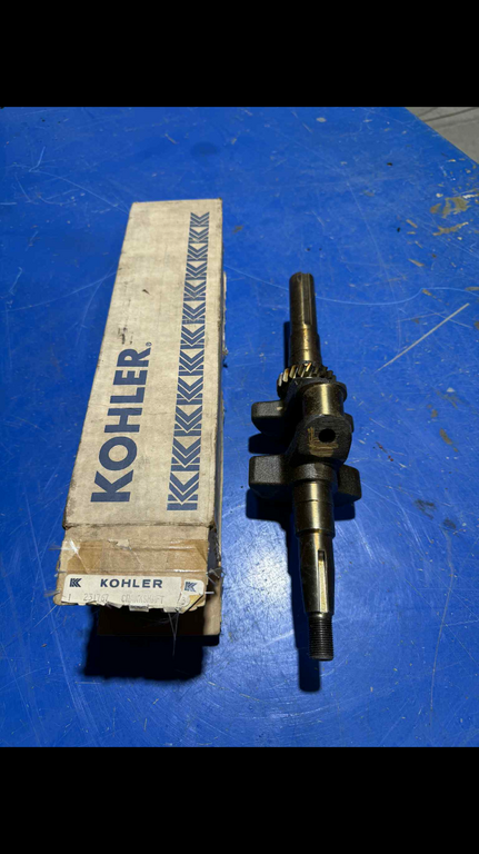

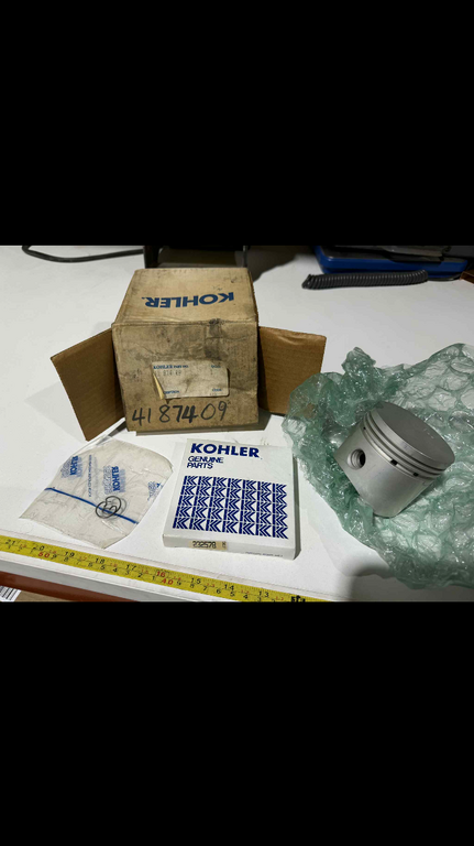

dclarke 4,274 #7 Posted May 1 (edited) I ran into all kinds of problems with the engine, the block was cracked, the replacement needed bored and all the other usual stuff. I finally found what I needed, had the machine work done and got it back together a few weeks ago. Edited May 1 by dclarke 1 13 Share this post Link to post Share on other sites

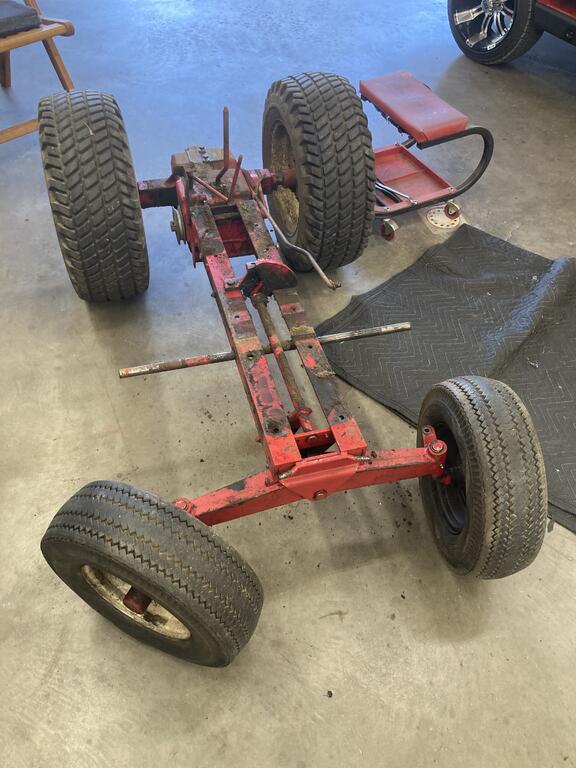

dclarke 4,274 #8 Posted May 1 With the warmer weather I was about ready to start reassembly. I bought a tranny kit from Lowell, had to find good pinion plates for the differential, mine were cracked. Got the tranny together and bolted to the frame. I decided to try the thrust bearings on the spindles so I had the front axle machined for that. 1 11 Share this post Link to post Share on other sites

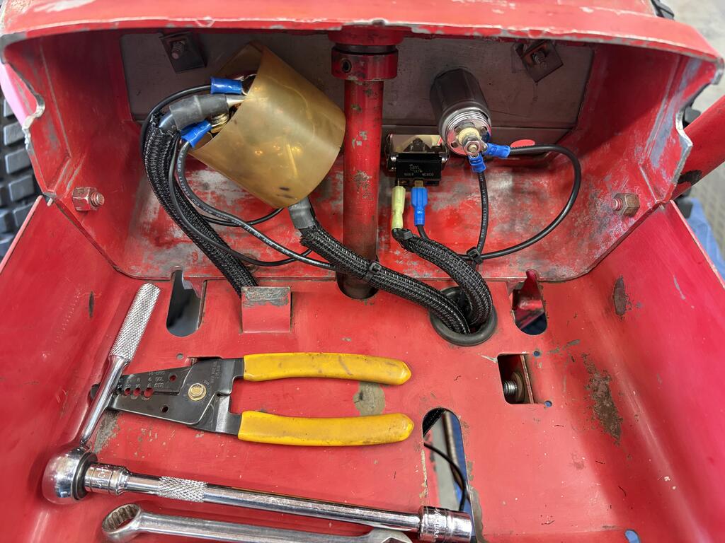

dclarke 4,274 #9 Posted May 1 Assembly went pretty easy, all new wiring, new switches & lighter. 1 11 Share this post Link to post Share on other sites

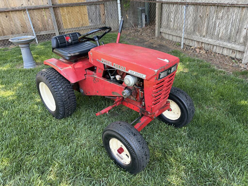

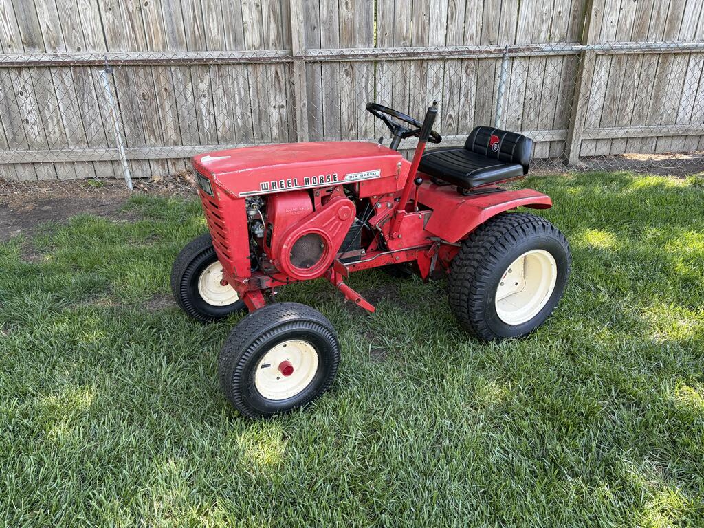

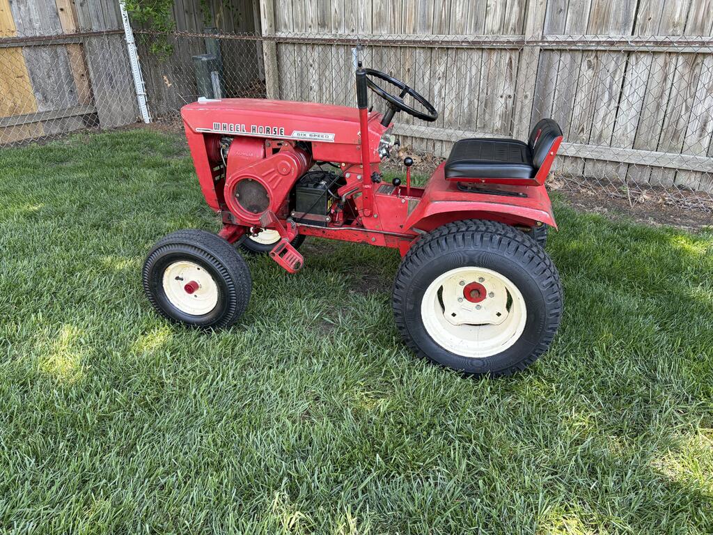

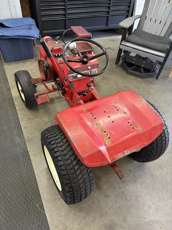

dclarke 4,274 #10 Posted May 1 I pretty much got it finished up this week. A seat from Matt Castagno, I added seat springs so made a new steering wheel shaft and raised the steering wheel. New decals from Terry and a new headlight lens. A nice original paint tractor with a few added touches. I’m pretty happy with how it turned out. 20 5 Share this post Link to post Share on other sites

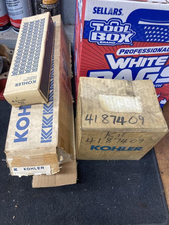

kpinnc 18,915 #11 Posted May 1 Looks fantastic to me. To heck with a paint job, you took care of all the important stuff! Very nicely done sir! You even found OEM Kohler engine parts. Awesome! 3 2 1 Share this post Link to post Share on other sites
Terry M-(Moderator) 2,316 #12 Posted May 1 Turned out Nice , Denny ! 2 1 Share this post Link to post Share on other sites
Pullstart 71,127 #13 Posted May 1 Well done! You really have a gem there Denny! 3 1 Share this post Link to post Share on other sites
ri702bill 12,850 #14 Posted May 1 The addition of a second 1/4" pipe plug in the forward well is an excellent idea. 5 1 1 Share this post Link to post Share on other sites
