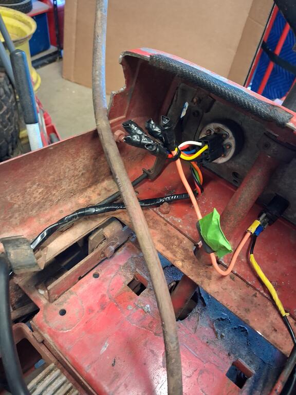

I decided this morning to go with an electric for this C101 I'm working on right now, and I think I know the proper way to install one, as close to the tank as possible, add a filter in front of it, and pay attention to the flow arrow.  I'm gonna feed mine from the ignition circuit at the switch and add a fuse for it behind the dash, I just have finished replacing the wiring so I'm familiar with it right now.
Ideally the pump wants to about the same level as the gas in the tank - that floods the pump inlet and allows it to pump immediately (as long as the shutoff is open!!). These pumps do a great job pushing fluid, not so in pulling.
