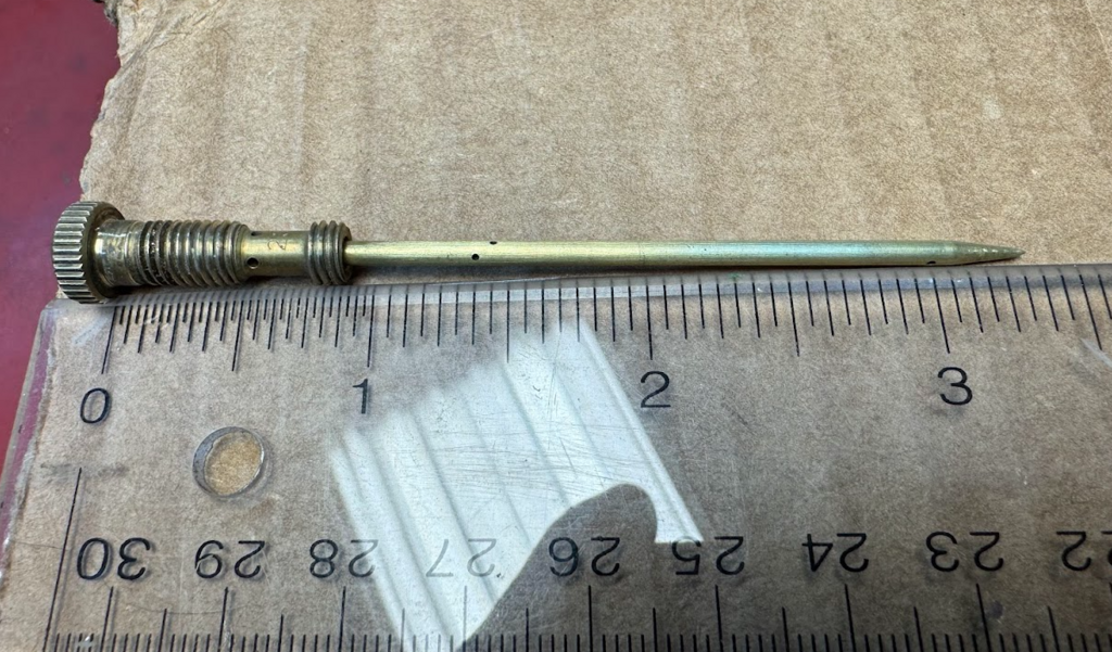

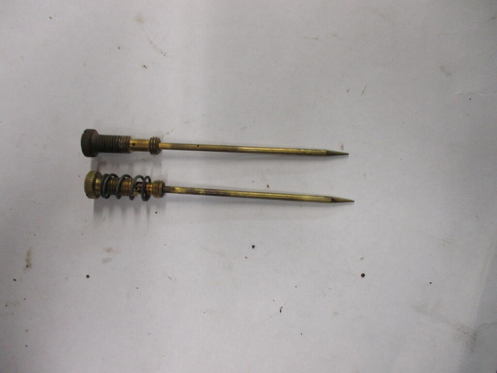

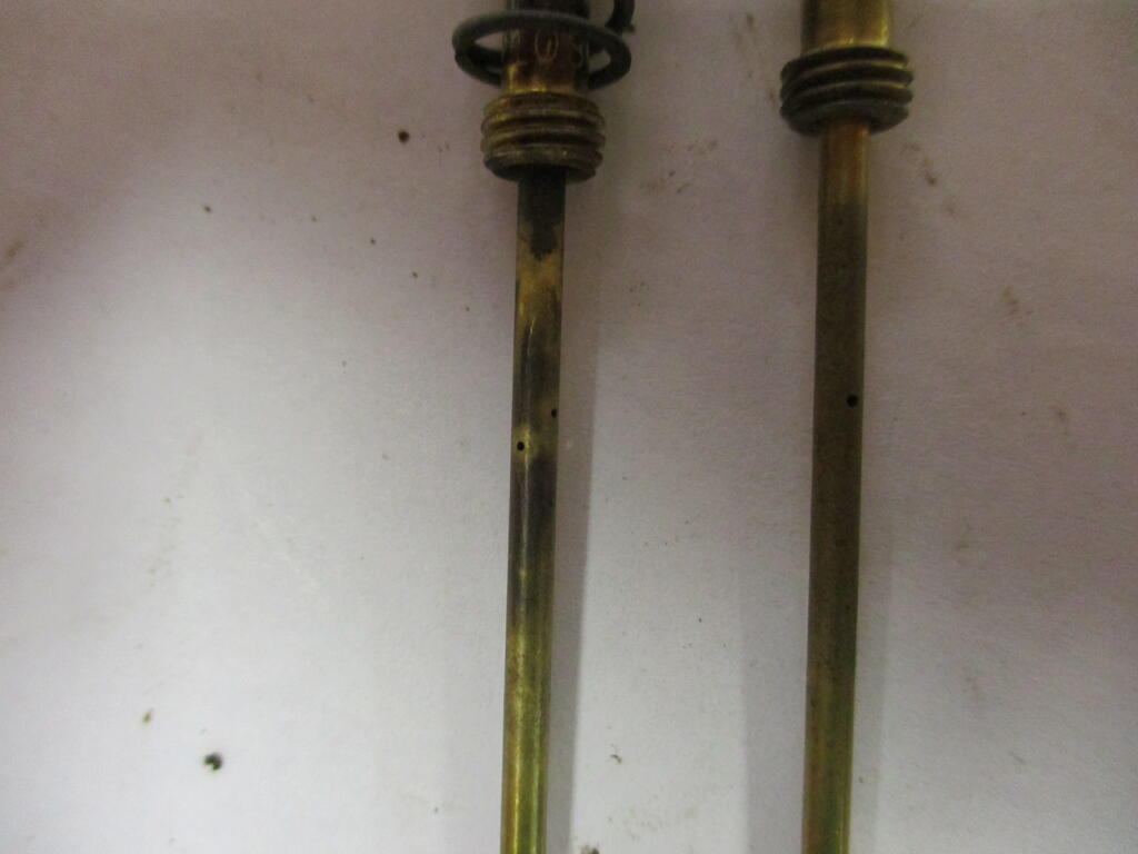

pfrederi 20,819 #34 Posted May 5 (edited) I am more confused than ever about Kohler Carbs. As some have pointed out I should try different High speed and idle needles it my problem carb. Needles have different #s and port sizes ...There are numbers stamped on the high speed needle shahft ..is there a cross reference for that to the #carb it should be on,? Left two ports right only 1 port... Edited May 5 by pfrederi 1 Share this post Link to post Share on other sites
pfrederi 20,819 #35 Posted May 5 Learned a bit about Kohler carbs ... The idle circuit... once you get the plug out there is a chamber with three ways out. One goes directly in to the carb passage one goes to the idle needle and the other goes up to the top of the high speed needle.. Always wondered why the high speed needle had double threads.. the gap between them has a port that feeds the idle circuit. So the wrond high speed needle could be messing up my idle problem 1 1 Share this post Link to post Share on other sites

pfrederi 20,819 #41 Posted May 6 Did considerable "light reading" Thanks to @tunahead72 I finally figured out that the Carb in question has the wrong High speed needle. (at least I think so) but fortunately in my spare parts pile (i never throw anything away...not that I can find it later) I found the right one. Now as soon as i replace the freeze plug I can try it out. n I am having a refreshing malted beverage as this has worked my old brain too hard... 2 4 1 1 Share this post Link to post Share on other sites

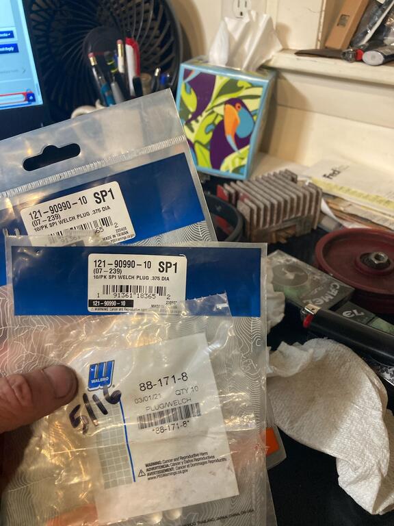

ineedanother 2,511 #46 Posted May 7 3 hours ago, pfrederi said: Wish the USPS would hurry up with the plug I buy packs of 10 in the jungle. 3/8 and 5/16 always laying around here. Some other sizes too. 1 Share this post Link to post Share on other sites
ebinmaine 79,491 #47 Posted May 7 8 hours ago, ineedanother said: I buy packs of 10 in the jungle. 3/8 and 5/16 always laying around here. Some other sizes too. Can you PM me the link? Share this post Link to post Share on other sites
Handy Don 16,908 #48 Posted May 7 20 hours ago, ineedanother said: I buy packs of 10 in the jungle. 3/8 and 5/16 always laying around here. Some other sizes too. 11 hours ago, ebinmaine said: Can you PM me the link? And me as well, please? 1 Share this post Link to post Share on other sites
pfrederi 20,819 #49 Posted May 7 56 minutes ago, Handy Don said: And me as well, please? and since the USPS thinks it takes a week or more to move an envelop 400 miles i would like it also.... 1 Share this post Link to post Share on other sites
ineedanother 2,511 #50 Posted May 7 Well, they've gotten more expensive! Although some sources have these things at upwards of $10 each. 3/8" (0.375 $15 for 10) - do a jungle search for item 07-239 5/16" (0.313" less commonly used and more expensive, $38 for 10) - do a jungle search for item 88-171-8 Interestingly, the description for the 3/8" is that they are rubber, silicone not the case...if that search doesn't work let me know and I can PM a link. 1 Share this post Link to post Share on other sites
