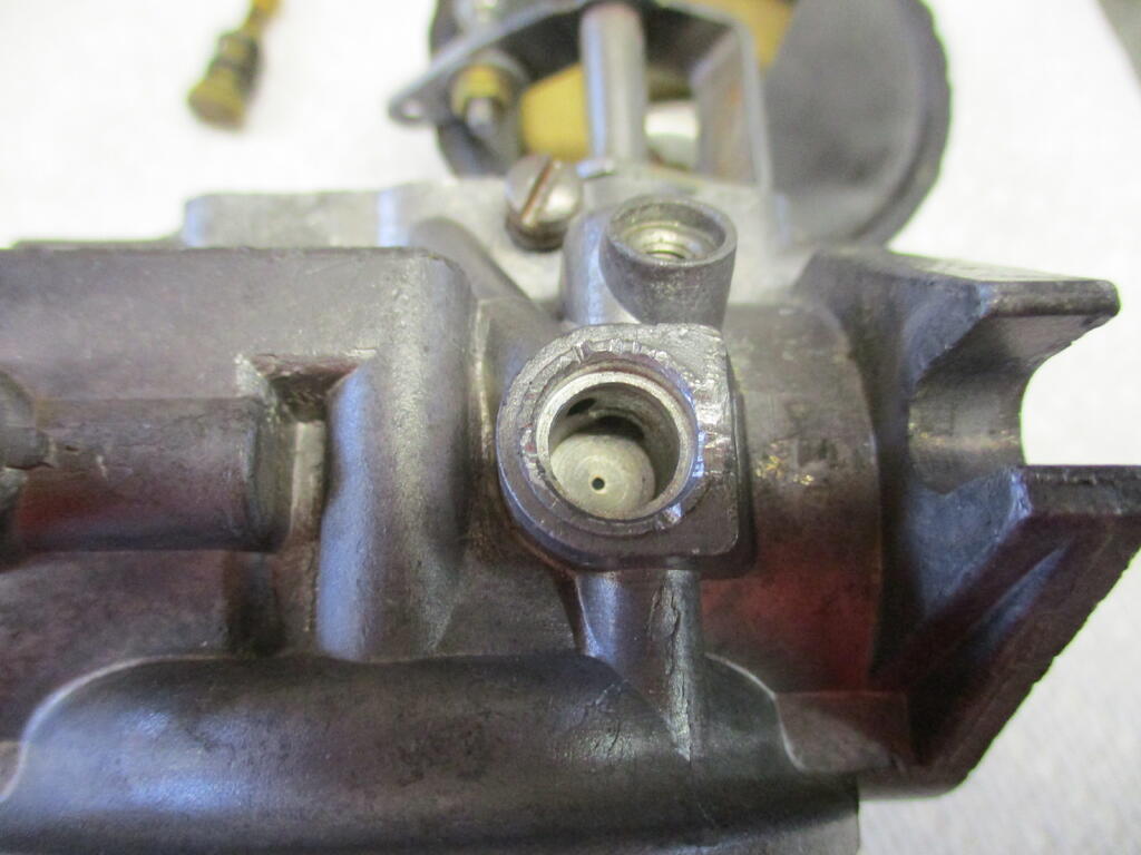

pfrederi 21,150 #1 Posted April 30 Last year I cleaned up a a C-160-8 complete engine overhaul .010 over/under new valves /guides. I had purchased a used #30 Kohler carb. It had been worked on as the throttle linkage the ball is on had been welded. I went ahead cleaned it put a bushing on the throttle shaft, and it ran like cr**p. Have now had at least 3 extended soaks in Berrymans, two trips through the ultrasonic cleaner and it runs fine over 2000 rpm but I cannot get it to idle. The idle mixture seems to have very little effect ,it will run for 10-15 seconds then start to slow down sometimes she catches and speeds up and will run again for 10 seconds but then dies again. I bought a Chinese carb ...(hey sometimes they work )...this one didn't, still wouldn't idle well and top end was not as smooth. Began to wonder if I had screwed up something in the overhaul. Double checked timing with Timing light ...spot on. Out of frustration I fired up a C-160-8 project tractor (or resale) She runs really well so I took her carb and put it in my rebuild . Now she runs great!!! However I want to get a carb on the project tractor.. as expected the Chinese card ran really rough at idle and high speed. So now I am back to looking at the the #30 carb I had cleaned up. I have not removed the idle passage freeze plug. I have rehabilitated many carbs and have never had to do that....Is there a source for just the replacement plug (or can i get something from McMaster). Also looking closer there is some play on the lower end of the throttle shaft. Would air leakage there affect the idle??? 1 Share this post Link to post Share on other sites
ebinmaine 80,695 #2 Posted April 30 1 minute ago, pfrederi said: I have not removed the idle passage freeze plug. I have rehabilitated many carbs and have never had to do that....Is there a source for just the replacement plug (or can i get something from McMaster). PM me your address. I'll send you one. They're very hard to find because they're aluminum. McMaster does not sell them. 1 minute ago, pfrederi said: Also looking closer there is some play on the lower end of the throttle shaft. Would air leakage there affect the idle??? Definitely. 3 Share this post Link to post Share on other sites

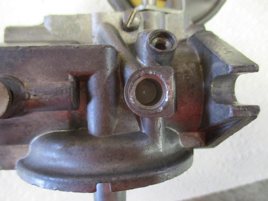

pfrederi 21,150 #12 Posted April 30 Got the plug out no dirt in there.... I guess the worn lower shaft pocket is a culprit. In addition to the butterfly wiggling around air can be sucked around the shaft sitting in the enlarged pocket. 1 Share this post Link to post Share on other sites
ebinmaine 80,695 #13 Posted April 30 3 minutes ago, pfrederi said: Got the plug out no dirt in there. Just for kicks take a can of brake clean and spray back & forth through those galleys. See where they go and clarify cleanliness. Share this post Link to post Share on other sites
pfrederi 21,150 #14 Posted April 30 Just ran thin stainless wire through all the ports and tunnels nothing came out all were clear 2 Share this post Link to post Share on other sites
