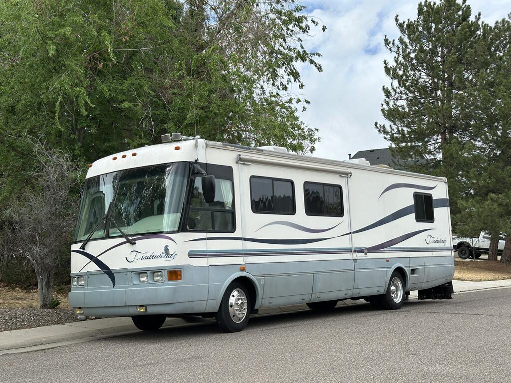

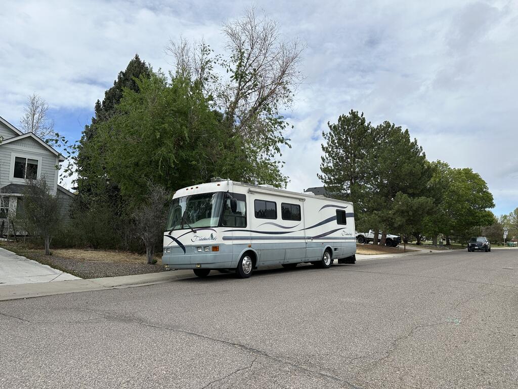

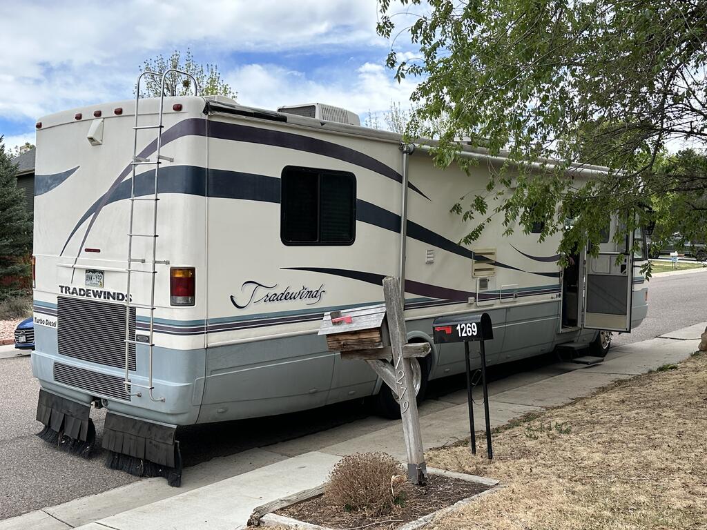

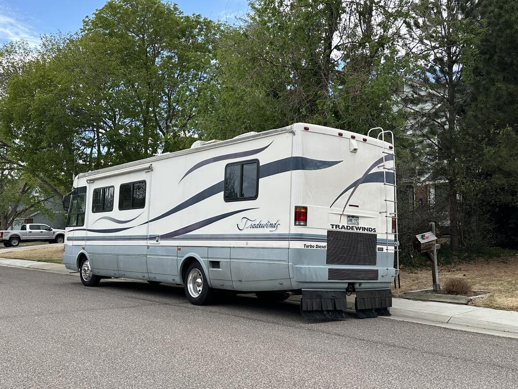

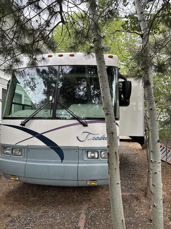

Pullstart 71,223 #1 Posted April 28 I figured there is no need to plague Eloise with the dark cloud of the Reno Turd. Time for a new thread! This is our new to us diesel pusher. I’m putting a video together, and will update the thread as we go along. It’s been in the extended family since new, and always well kept. It needs some loving, but is way more capable as a usable camper than the last pusher we brought home! The trip to Colorado was quick, but great. More details to come. 9 3 Share this post Link to post Share on other sites

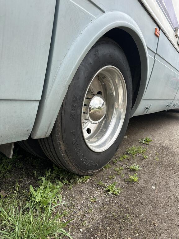

Pullstart 71,223 #19 Posted April 28 13 minutes ago, oliver2-44 said: Our class C was on a 2017 Chevy 4500 Chassis. We sold it back at Thanksgiving. It had fair power and got 8-10mpg on flat land. It rode like a noisy rough box truck. PO installed a rear sway bar that took the sway out but stiffens it up too much. I took it off but put back on due to too much sway when a semi passed. I’ve test drove a couple of the MB chassis one. They were better but still noisy. We’re looking at Trailers and Class A’s I drove a 2016 Newman Ventana 37 ft Class A with the 340hp Cummins diesel. Had it floored 25% of the time to get to 55mph. Doing some research it really needed 380/400+hp. Yesterday I drove a 2022 entry level Tiffin with the 7.3 Ford chassis. Much better acceleration. Certainly not a rocket, but I never had to floor it to get it to move. The last 10?years all brands of the gas Class A have been built on the Ford chassis. Currently the RV market is flooded with all the people that bought them during Covid dumping them Good time to buy bad time to sell. This 300 hp CAT 3126 and Allison 6 speed combo with 235/80R22.5 tires was very easy on the throttle. Mind you we were traveling nearly empty, but I80 through Nebraska and Iowa have quite a selection of hills to climb. We did the same route with the 8.3 Cummins coach, same transmission and pushing 295/75R22.5 tires. Supposedly that Cummins was 400 hp, but all the lies she told me, I don’t believe anythings she said at this point. It was also empty, for reference. I really like this CAT setup. 3 1 Share this post Link to post Share on other sites

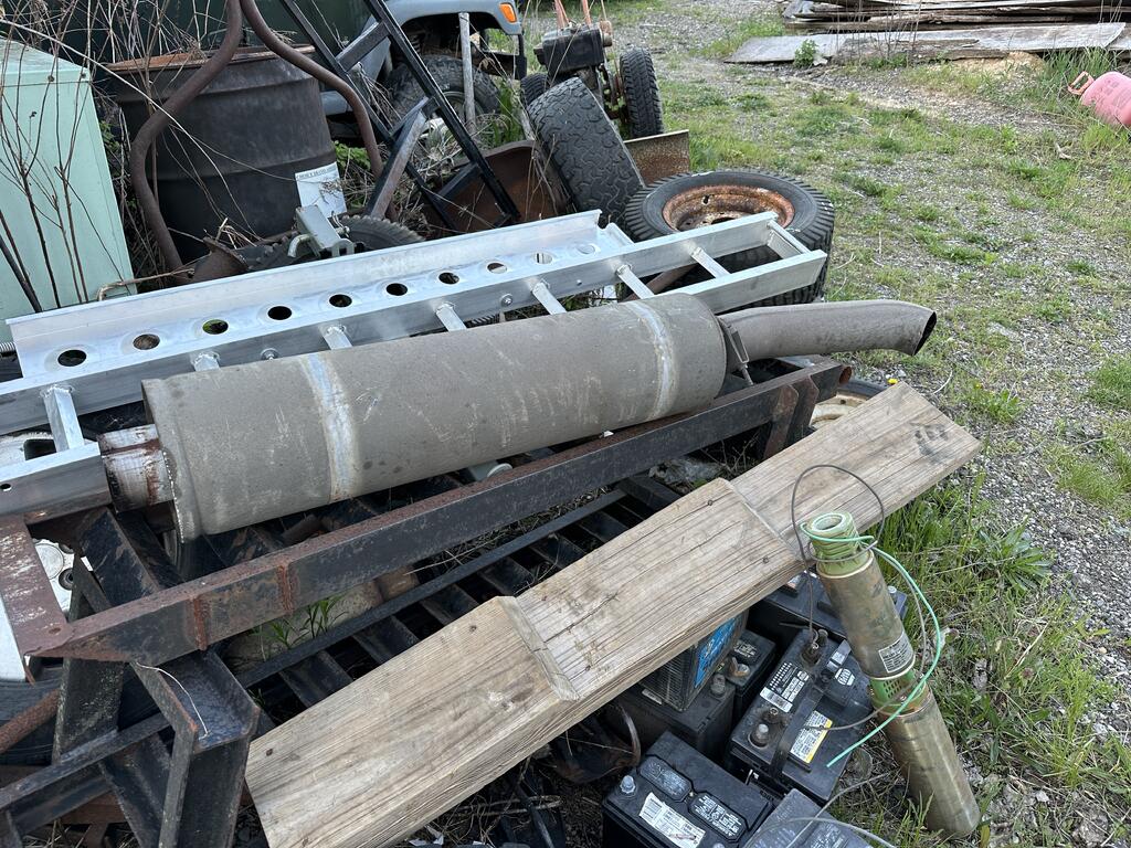

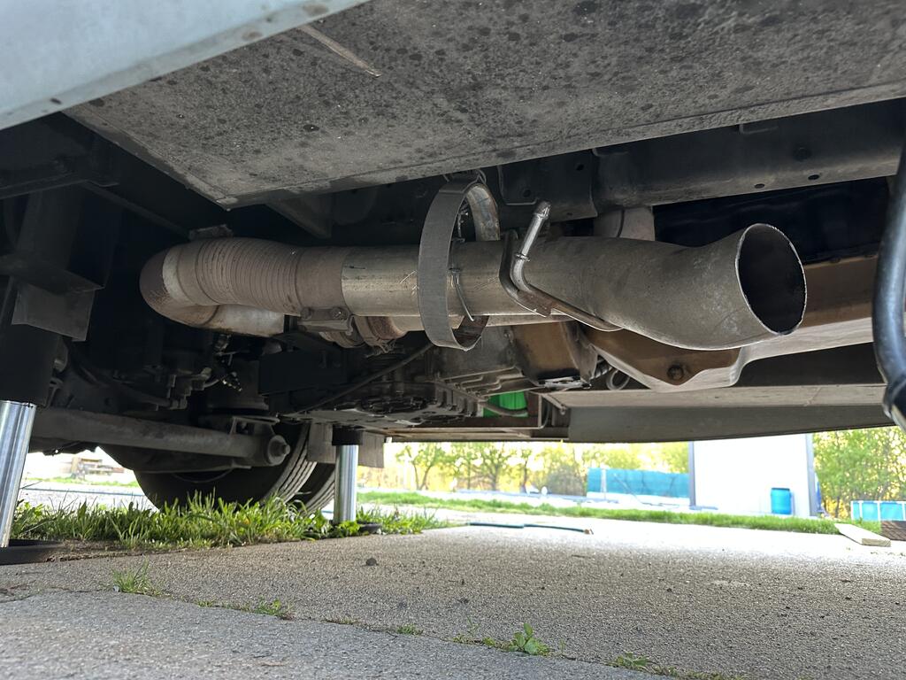

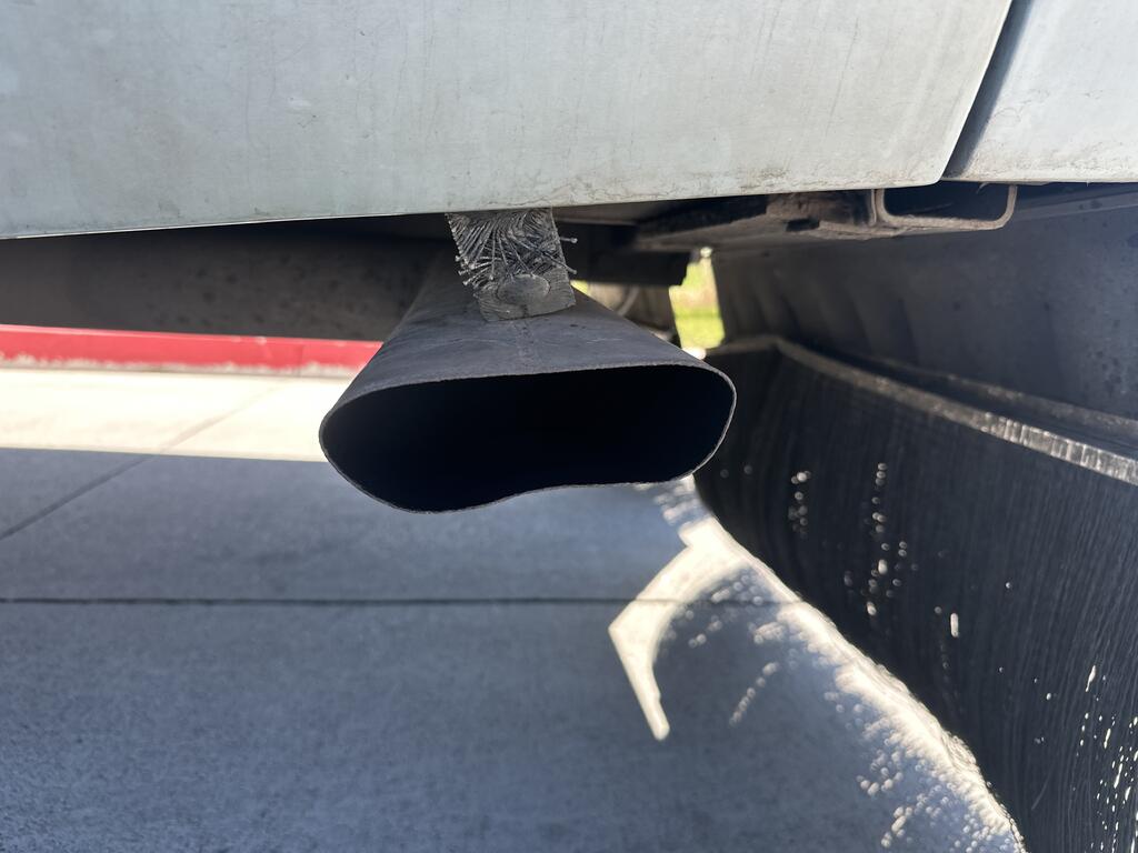

Pullstart 71,223 #20 Posted April 28 Before departing Colorado, we discussed heat, especially when towing. They had a 90 degree exhaust bend installed to push exhaust heat away from their towed car. Through driving in and out of various approaches, the exhaust was crushed quite a bit. I have remedied that. If the 4” pipe with no muffler deems to be tolerable on the road, I’ll make the hanger a bit more pleasant to my eye. My eye, because it’s likely I’ll be the only one that sees it again. 3 Share this post Link to post Share on other sites
ebinmaine 80,687 #21 Posted April 28 23 minutes ago, Pullstart said: exhaust What's that blow at/on/towards? Our heavy-duty trucks at work all need a deflection tip to point (mostly) down so the exhaust doesn't melt stuff. 1 Share this post Link to post Share on other sites
Pullstart 71,223 #22 Posted April 28 2 hours ago, ebinmaine said: What's that blow at/on/towards? Our heavy-duty trucks at work all need a deflection tip to point (mostly) down so the exhaust doesn't melt stuff. The angle of the camera looks like it points up, but it’s down/out pointing. 1 Share this post Link to post Share on other sites
