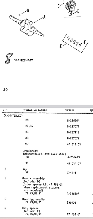

pfrederi 21,046 #18 Posted April 27 Lots of things in engines can start making noises other than balance gears which I really do not believe you have. One guys opinion of the noise as a balance gears is not totally reliable. If the engine is 46333 no balance gears...I seriously doubt some previous owner added them in... Parts Tree, Rehlko (Kohler) websites and my old paper Parts listing no balance gears in the 46333. Might want to start looking for other causes. Can you make a recording maybe some on here could recognize it. 1 Share this post Link to post Share on other sites

Pullstart 71,096 #23 Posted April 28 For reference, this is what you’re getting after. 2 2 Share this post Link to post Share on other sites
