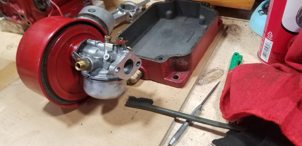

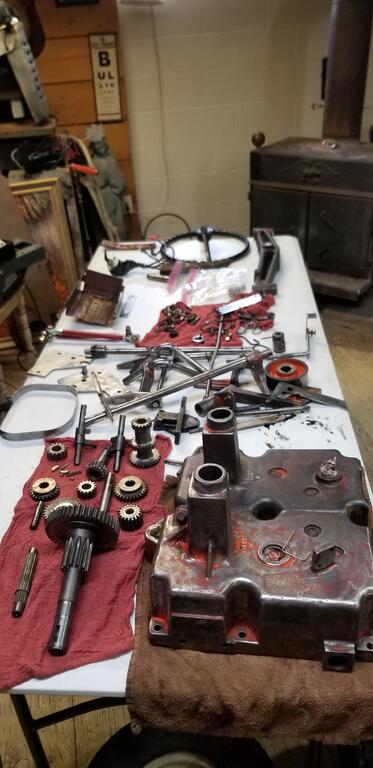

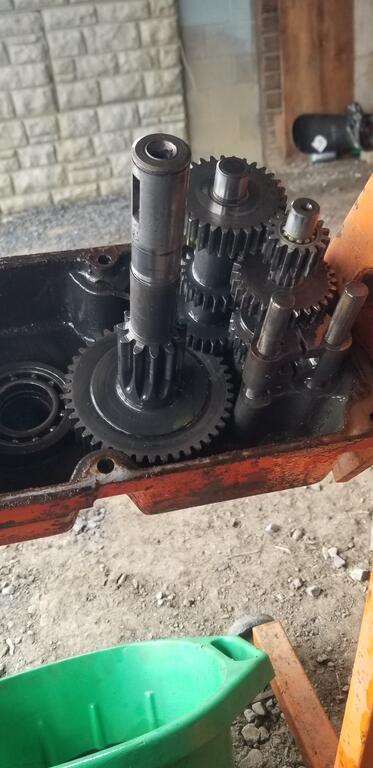

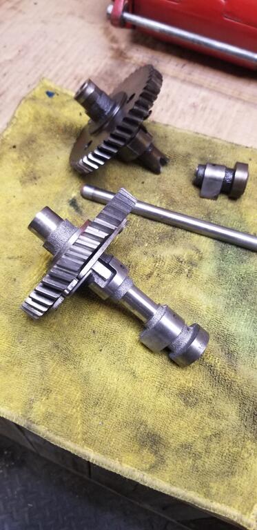

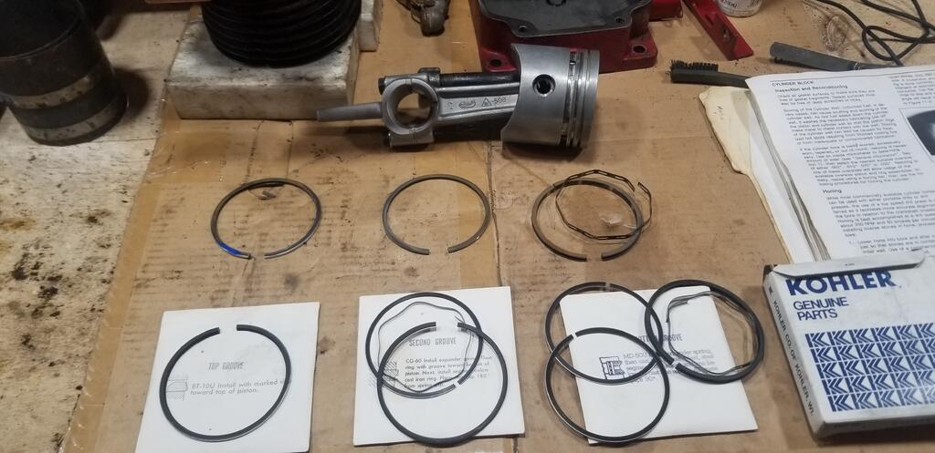

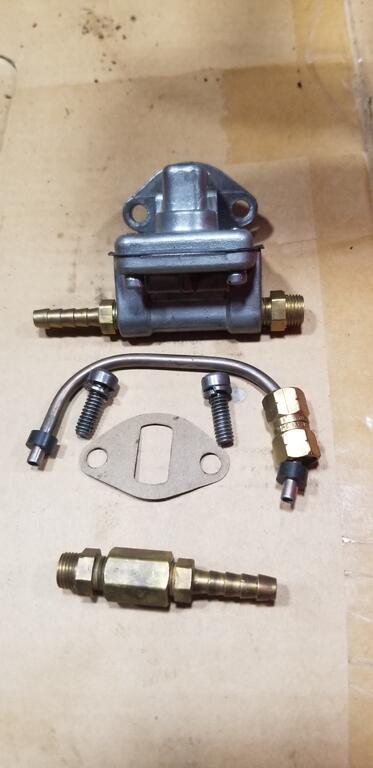

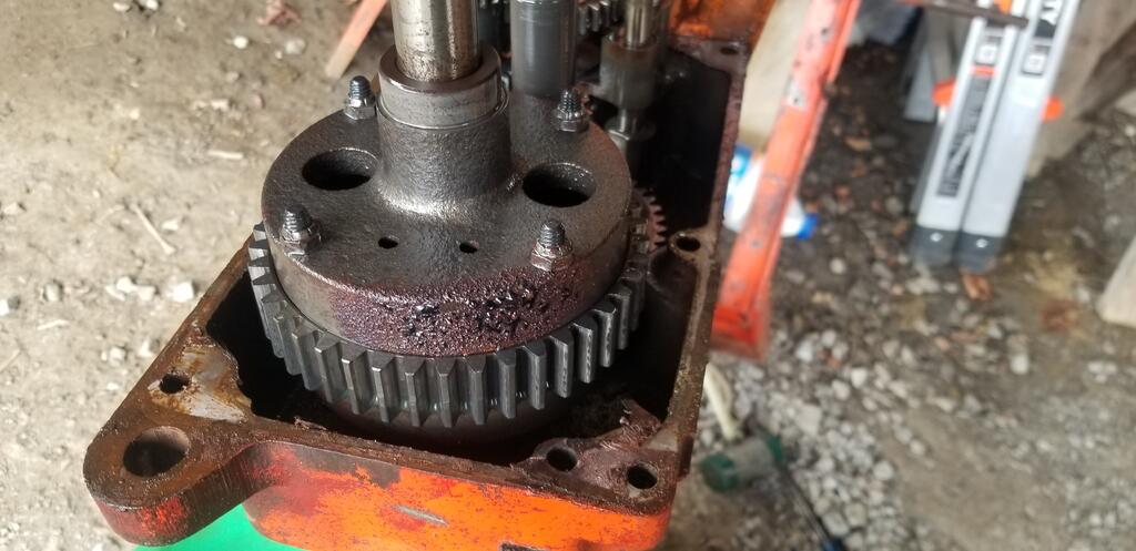

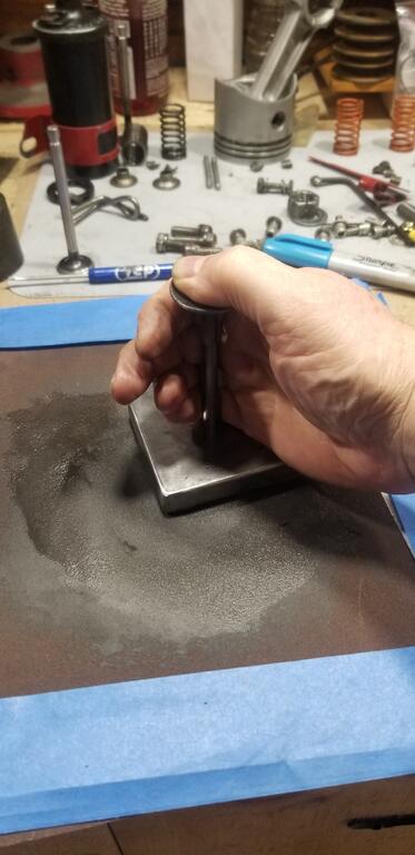

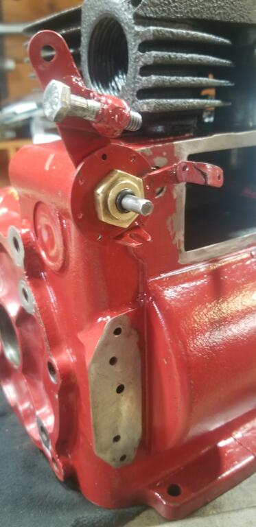

gt14rider 1,283 #1 Posted April 22 Hi all, well I've been working on my 856, starting with a broken cam, so new rings ,rebuilt carb, rebuilt fuel pump, new valves, glassed the head, points and condenser, plug wire. Then layer #2 see (previous post Steering upgrade). Then layer #3 I had it that far torn down might as well do the transmission. The 1533 bearing were toasted, and outer axle bearing as well. Seems the 1533 bearings had only one seal removed, blocking oil to the outer bearings. Then while pulling the seals i chipped a bearing cage. Ordered and waiting for parts. Then layer 4, might as well paint it, so that's were I'm at. 1 5 Share this post Link to post Share on other sites

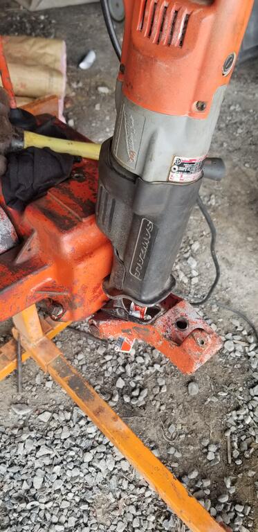

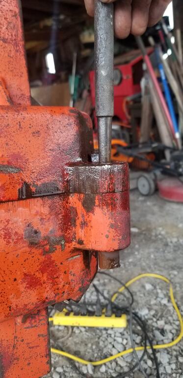

ri702bill 13,300 #2 Posted April 22 Fun with Unidrives!! It is a right of passage removing a stuck hitch pin in order to split the case. Been there, done that! 3 Share this post Link to post Share on other sites
ebinmaine 81,082 #3 Posted April 22 Interesting that you had any side cover on the 1533. I've had at least a dozen transmissions apart and none had a cover inside or out. Nice work! 1 Share this post Link to post Share on other sites
953 nut 70,226 #4 Posted April 22 Like @ebinmaine I have seen the seals turned in, out or none at all. There is enough oil sloshing around in there that the will remain well lubricated. Looks like the high water line made it up to the 1533s rusting them a bit. 1 Share this post Link to post Share on other sites
squonk 48,307 #5 Posted April 22 I've done 2 transmissions and both had 1533 bearings with one seal facing towards the outside. ( case side ) 1 Share this post Link to post Share on other sites
gt14rider 1,283 #6 Posted April 22 I got the tractor and flushed it with diesel 2 or 3 times, then flushed with 80/90wt a couple times, till it ran clean. Mowed 3 acres for two years with it. Those bearings must have been grinding the rust for a while. Tractor ran good little bit of seepage around the brake shaft seal and the case gasket but not bad. @ri702bill hitch pin wasn't to bad, the hitch is what was stuck, the ends of pin looked like thay were peened over. Two minutes with the saw, BAM!! it's off, knocked it out pretty easy. 2 Share this post Link to post Share on other sites
kpinnc 19,043 #7 Posted April 23 3 hours ago, ebinmaine said: Interesting that you had any side cover on the 1533. The one on my 310-8 had them on one side of each 1533. Never seen one other than that one before. 1 Share this post Link to post Share on other sites
ri702bill 13,300 #8 Posted April 23 (edited) Well done. A note to all..... THIS is the proper method to remove the 3" remnant of the 3/4" diameter pin. You press or impact thru the thin side and have the pin exit out the thick half of the casting. Doing it the other way, you run the risk of snapping the boss off the thin housing. Then you just compounded the problem you already were trying to fix with the Unidrive... Edited April 23 by ri702bill 3 2 1 Share this post Link to post Share on other sites
