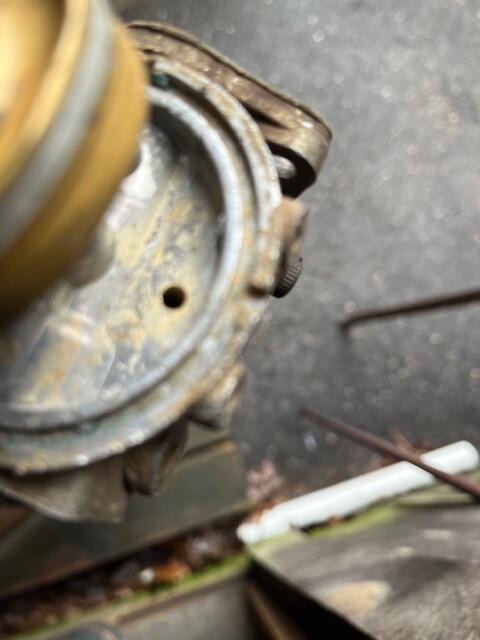

adsm08 5,247 #1 Posted April 15 The boy went to mow tonight and couldn't get the engine to start. I took a look, and fuel was running out of the carb. So I took it apart, checked the float and needle, they are working at best I can tell. They pass every test I know, I can flip the carb over and not be able to blow through it, I can hold the float up and get no fuel, I can let go of the float and it drops, along with the needle. But as soon as I put the bowl on and prime the fuel system fuel starts running out of the carb. This is one that has had an electric pump installed. Aside from the pump overwhelming the float I'm at a loss. 1 Share this post Link to post Share on other sites

adsm08 5,247 #11 Posted April 16 (edited) This is the pump I am using, it ran all winter and spring so far on this one. ENGINEMAN Gasoline Electric Fuel... https://www.amazon.com/dp/B0FBGN2PNS?ref=ppx_pop_mob_ap_share The float is empty, not full of fuel by the time I get the bowl off, and I've never had a punctured one drain that fast. I am not sure where the bowl vent is on this carb. I mostly work with fuel injection. The wire clip actually seems to be MIA. I was in a hurry and didn't realize it last night, but I don't remember seeing it at all. This one has a removable seat. I am not 100% sure the seal between the seat and body isn't leaking, but I can't figure out how to remove it. It is clearly 10mm/ 3/8, but I don't have a socket thin enough and can't get a wrench to swing on it either. Edited April 16 by adsm08 1 Share this post Link to post Share on other sites
sqrlgtr 4,225 #12 Posted April 16 24 minutes ago, adsm08 said: The float is empty, not full of fuel by the time I get the bowl off, and I've never had a punctured one drain that fast. all the sunken floats Ive had you couldn't hardly get the fuel out of them so its probably not sinking. 26 minutes ago, adsm08 said: The wire clip actually seems to be MIA. I have seen them with and without and don't believe they are necessary. I have had the float needles go bad and that sounds like what you may have. Is the needle all metal or does it have a rubber type tip? 1 Share this post Link to post Share on other sites
ebinmaine 81,281 #13 Posted April 16 6 minutes ago, sqrlgtr said: rubber type Age of needle and seat? Ethanol fuel? 1 Share this post Link to post Share on other sites
WHX?? 58,388 #14 Posted April 17 2 hours ago, adsm08 said: is clearly 10mm/ 3/8, but I don't have a socket thin enough and can't get a wrench to swing on it either. Always a problem. Tom @Shynon was turning sockets down and selling them. Originals are 3/8 aftermarkets 10 mm. 1 Share this post Link to post Share on other sites
adsm08 5,247 #15 Posted April 17 2 hours ago, sqrlgtr said: all the sunken floats Ive had you couldn't hardly get the fuel out of them so its probably not sinking. . Is the needle all metal or does it have a rubber type tip? I have dealt with that issue on fuel level sender floats as well. I am confident it is not sinking. Rubber tipped needle. Tip feels pretty pliable. 2 hours ago, ebinmaine said: Age of needle and seat? Ethanol fuel? I bought this unit at the show last year. I only use non-ethanol fuel. All history before last June is unknown. If anyone here sold a Commando 8 with a bunch of added lights and a car horn to a youngster for $450 down across from the pavilions at the end of the fair grounds, feel free to chime in on the history. 1 Share this post Link to post Share on other sites
