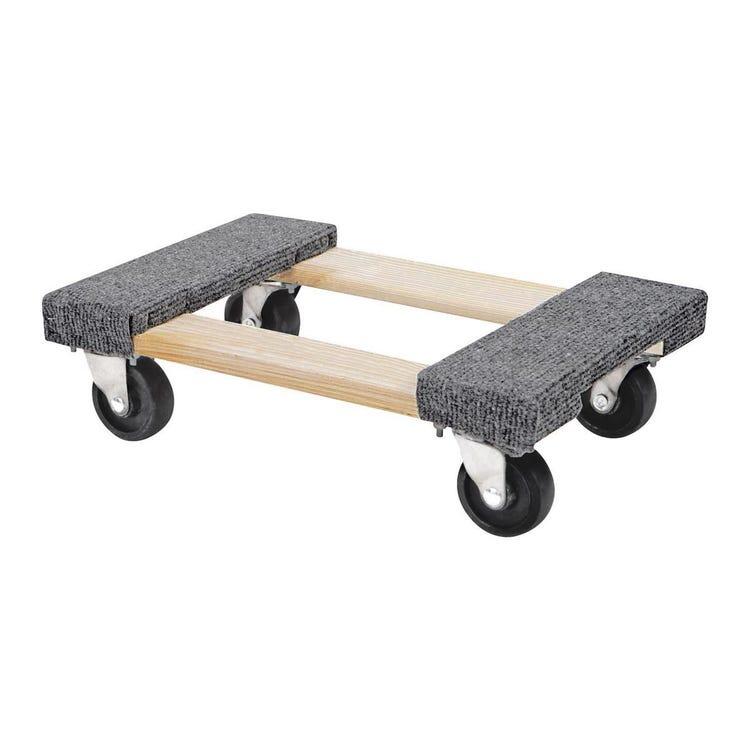

kpinnc 19,099 #4 Posted April 13 (edited) 1 hour ago, Cathie said: Got any ideas I can try? Go get two cheap dollies from Harbor Freight (about 10 bucks each) and lift the rear wheels onto it. At least you can shuffle it around on smooth surfaces. A 12hp Kohler is worth rebuilding. Can be expensive but well worth it. Hardest part is finding a shop to do the bore and grind the crank. Edited April 13 by kpinnc 5 Share this post Link to post Share on other sites
ineedanother 2,885 #5 Posted April 13 55 minutes ago, kpinnc said: Go get two cheap dollies from Harbor Freight (about 10 bucks each) and lift the rear wheels onto it. At least you can shuffle it around on smooth surfaces. A 12hp Kohler is worth rebuilding. Can be expensive but well worth it. Hardest part is finding a shop to do the bore and grind the crank. Larger casters aren't too expensive at HF if you need to move over something rougher and you probably don't have many other options to get it moved. It sounds like that might be worth the trouble and expense. Share this post Link to post Share on other sites
Cathie 4 #6 Posted April 13 Thanks All! I appreciate the confirmation that there isn't much to be done. We've got several of those dollies, and we do plan to get the engine rebuilt. 2 Share this post Link to post Share on other sites
