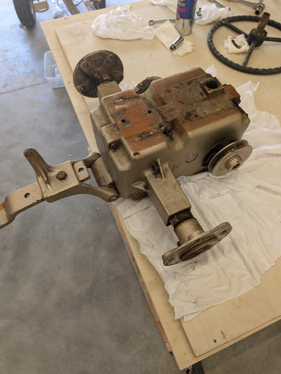

702854boy 1,245 #29 Posted April 15 (edited) Same with the hubs Another thing to look out for when you take the tranny off is the mounting plate for it, make sure it's not all cracked and everything Edited April 15 by 702854boy 2 Share this post Link to post Share on other sites

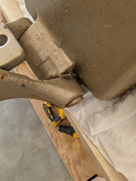

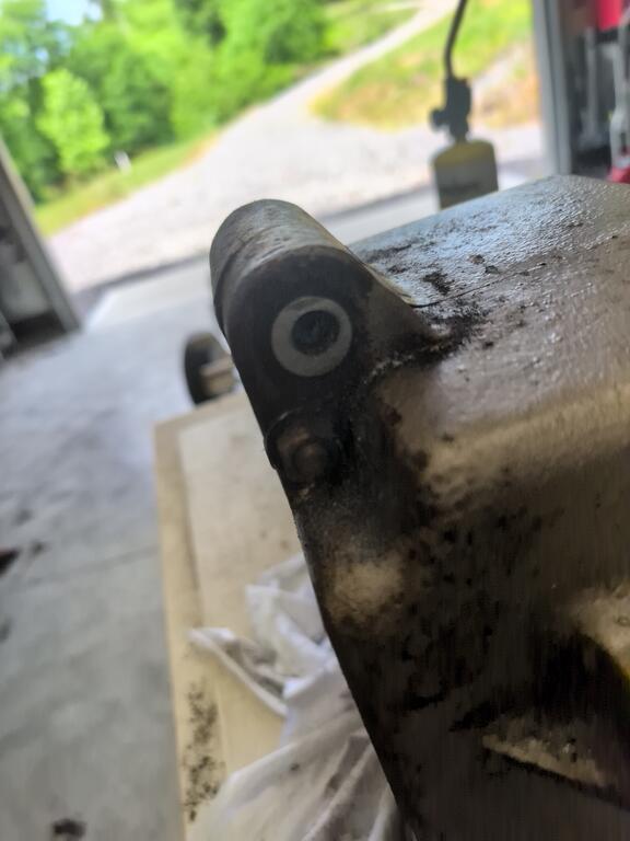

Buschlight13 15 #35 Posted April 21 Unfortunately had responsibilities this weekend, but I did get the wheels and frame disassembled. I'm for sure gonna have to cut this pin off. It's mushroomed on both ends. Share this post Link to post Share on other sites

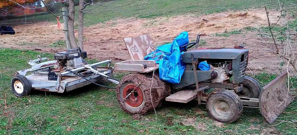

nyquil junkie 333 #36 Posted April 21 Quote I was thinking of putting a 420cc predator on it, and using it to pull a bushhog. Add duals and chains, and a plow you'll have the ultimate trail cutter. Share this post Link to post Share on other sites

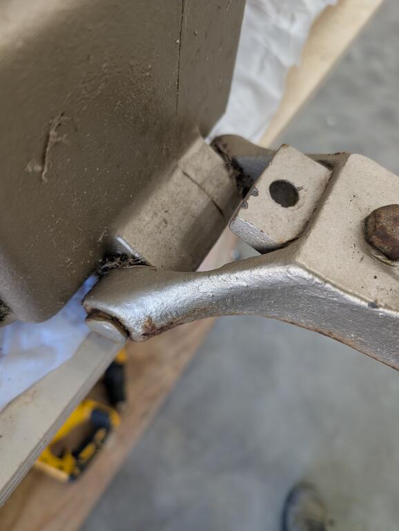

Handy Don 17,735 #37 Posted April 21 (edited) 5 hours ago, Buschlight13 said: Not a lot of pin showing there. Me, I’d grind both ends off (the heat from the grinding will help) and then, as @kpinnc suggested, drill ¼ or ⅝” holes in both ends about an inch deep to take a punch. Of course, plenty of penetrant that you’ve allowed time to work. Then, on alternating ends, a few sharp whacks on the punch with a big hammer. Reapply penetrant. Coffee or a movie. Repeat. Once it moves in one direction, touch grind what is now exposed of the pin then go the other way. I find that going back and forth is more productive that “going for broke” in one direction right away. Edited April 21 by Handy Don 1 1 Share this post Link to post Share on other sites

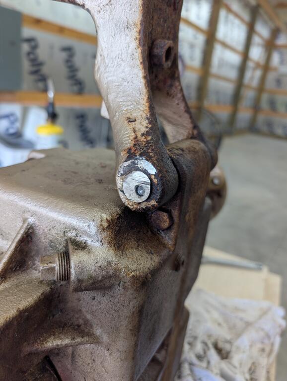

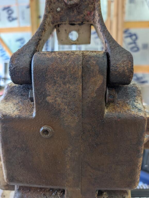

Buschlight13 15 #38 Posted April 27 It has not budged at all. I'm fairly convinced that the bar is bent. I believe the time has come to grind off the hitch. I've tried heat, I've done plenty of oil, the punch method seems fantastic, but if the whole pin is bent its not gonna get me far. 1 Share this post Link to post Share on other sites
702854boy 1,245 #39 Posted April 27 If need be, just cut the pin with a sawzall in between the hitch and the tranny and that way you'll be able to save the hitch 1 Share this post Link to post Share on other sites

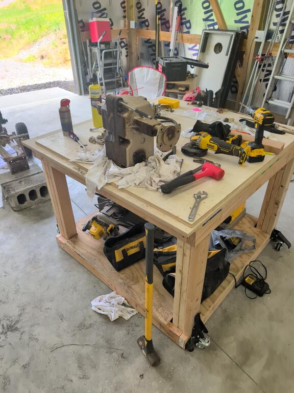

Buschlight13 15 #41 Posted May 1 Alrighty. Smacked it with the 15 lb sledge and it didn't care. The axle hub did. But at a loss at how to get this out lol. Share this post Link to post Share on other sites
Handy Don 17,735 #42 Posted May 1 Sad to see the busted hub. 😢 I’m reminded of working on a steering wheel roll pin. Without something supporting the side opposite the hitter, too much energy was being absorbed by the movement of the steering shaft and sheet metal. In your case, by movement of the entire transaxle. You cannot rely on inertia or someone holding it, in this situation. I’m assuming you’ve been using a good penetrant (Kroil, Liquid Wrench, Knock ‘er Loose) already. And you’ve given it a good heating (not concentrated in one spot--cast iron doesn’t take kindly to that). And there is no “shrooming” at the end of the pin that should be ground away. Can you create a brace that has a hole for the pin when it moves and is anchored to something very solid to support the flange? Perhaps even on the floor? That way, the force is completely on the pin and not trying to break off the flange. I used a 2x4 braced against a nearby masonry wall--no give whatsoever--and the pin yielded almost immediately. 1 Share this post Link to post Share on other sites

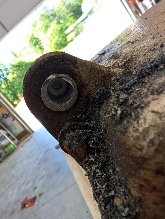

Buschlight13 15 #43 Posted May 1 I tried a few different configurations as I'd thought of this and I definitely don't have a vice to hold it. I attempted to mitigate dissipation as best I could. Used a lot of penetrative oil, heated the outside of the cast iron with a torch for awhile a few times, but didn't get too hot. I'm thinking I just gradually drill bigger and bigger? Guess it can't be stuck if I turn it to dust. Share this post Link to post Share on other sites

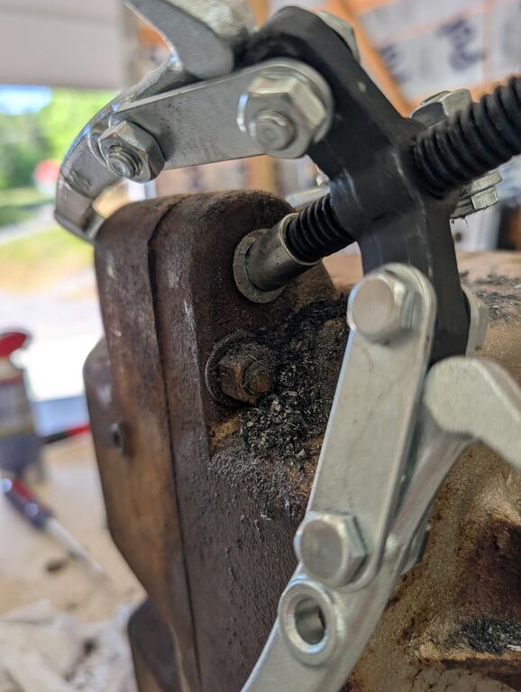

Handy Don 17,735 #44 Posted May 1 3 minutes ago, Buschlight13 said: I'm thinking I just gradually drill bigger and bigger? Guess it can't be stuck if I turn it to dust. Go big or go home?! In theory, I agree with growing the hole. My issue would be that a handheld drill can wander off the line you intend--especially true when trying to enlarge a hole--especially at the larger sizes. I ruined a perfectly good ½ drill bit when it got stuck and bent sideways trying to enlarge a ⅜” hole. Small steps do not work. Can you drill the existing hole deeper? Last thought for today: ONCE I was able to use a gear puller to remove a pin. I cannot remember for sure but I think it was a 3-jaw and the slot hitch was still in place, I used a clamp to make sure the puller jaws stayed on the edges of the slot hitch. Put tension on it and added a half a turn a day and a tap or two with a hammer. It finally popped. Share this post Link to post Share on other sites

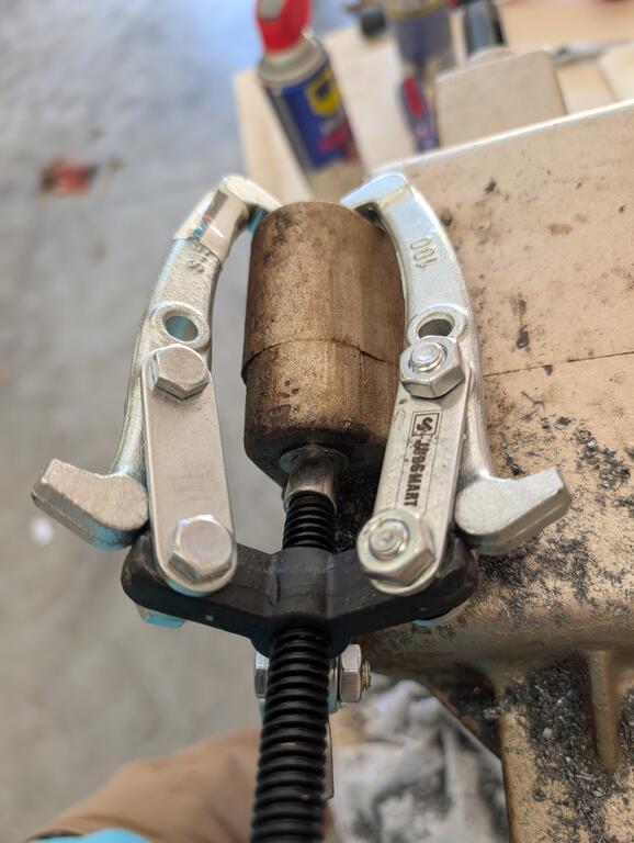

Buschlight13 15 #45 Posted May 3 Took the existing hole wider and deeper. Looked up and applied a gear puller. It doesn't wanna budge but left it on tension. Share this post Link to post Share on other sites
squonk 48,427 #46 Posted May 3 What are you using to heat it? That trans case is a giant heat sink. Going to take more than a propane torch. Share this post Link to post Share on other sites

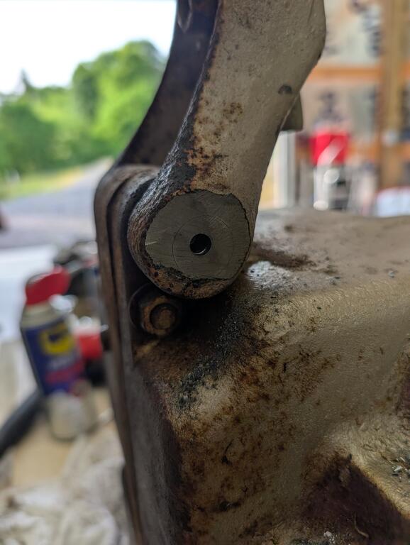

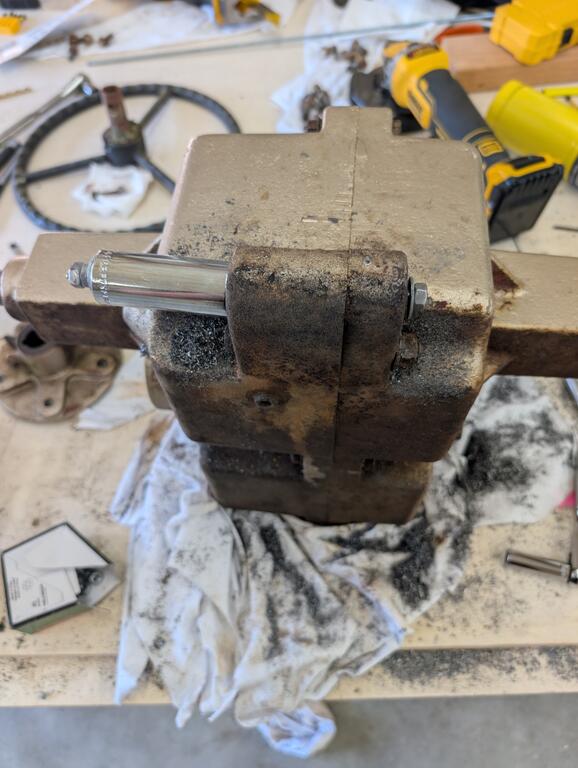

wallfish 20,744 #47 Posted May 3 Too bad it needed to cut. I have better luck beating and turning them to get them to budge. Once it budges just a little bit then it's definitely coming out! Lots of back and forth and spray lube. How about drilling a 3/8 hole all the way through. A long 3/8 bolt or threaded rod with a bigger socket or pipe on one end so the pin will fit into it. Crank that bolt down and smack with a hammer on the opposite side as the socket/pipe. Heat beat tension and don't forget to use plenty of curse words Share this post Link to post Share on other sites
Buschlight13 15 #48 Posted May 4 23 hours ago, wallfish said: Too bad it needed to cut. I have better luck beating and turning them to get them to budge. Once it budges just a little bit then it's definitely coming out! Lots of back and forth and spray lube. How about drilling a 3/8 hole all the way through. A long 3/8 bolt or threaded rod with a bigger socket or pipe on one end so the pin will fit into it. Crank that bolt down and smack with a hammer on the opposite side as the socket/pipe. Heat beat tension and don't forget to use plenty of curse words Really thought this was gonna do it. But it actually ripped the threads off the bolt and rod. 1 Share this post Link to post Share on other sites
Handy Don 17,735 #49 Posted May 4 19 minutes ago, Buschlight13 said: Really thought this was gonna do it. But Great idea. Larger diameter bolt? Share this post Link to post Share on other sites
Buschlight13 15 #50 Posted May 4 I think larger diameter rod with bigger threads lol. Gonna have to make the inside wider... I've almost spent more on getting this pin out than I did on the tractor 😂 Share this post Link to post Share on other sites
