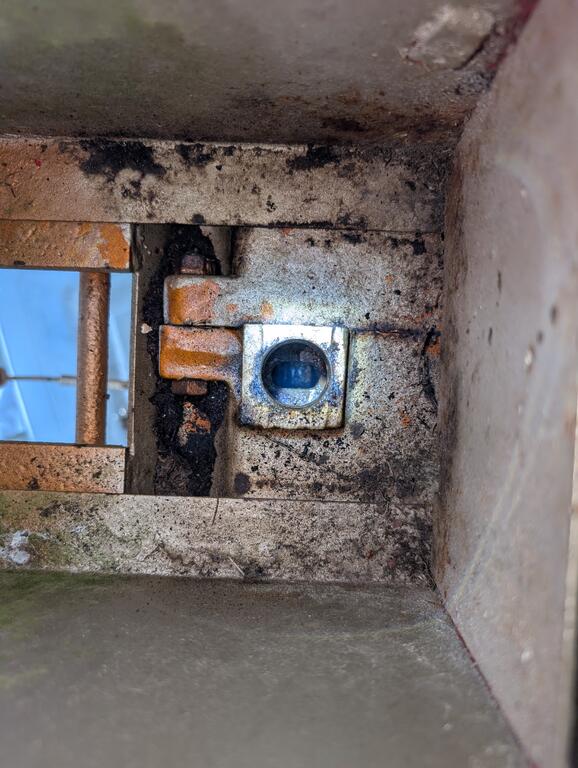

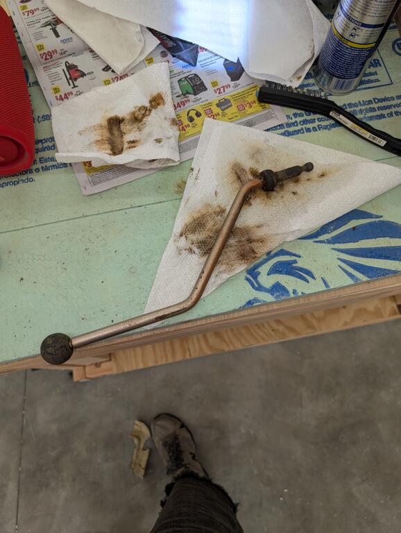

Buschlight13 15 #16 Posted April 13 Got the shifter out and a view of the inside. Now to the transmission section. It's pretty gross inside, so I think a good rebuild may be in order... 1 Share this post Link to post Share on other sites
kpinnc 19,107 #17 Posted April 13 51 minutes ago, Buschlight13 said: I think a good rebuild may be in order... You might be surprised just how nasty these transmissions can be brought back from. There are some great videos in this forum to help with rebuilding a transmission. They are actually quite simple to go through. Good luck! 1 1 Share this post Link to post Share on other sites

oliver2-44 11,847 #24 Posted April 14 (edited) 9 hours ago, Buschlight13 said: Got the shifter out and a view of the inside. Now to the transmission section. It's pretty gross inside, so I think a good rebuild may be in order... Now drain the transmission and see if its still full of gear oil, oil and water, or pure rusty water. if it had a lot of gear oil oil or at least oily water soup you might align the forks and put the shifter back in to verify how the transmission works. Then decide if you do a diesel flush or a full rebuild. If it's all water and rust, rebuild it. PS put a new rubber boot on the shifter whenever you permanently reinstall it. That's where they get water in these transmissions Edited April 14 by oliver2-44 2 Share this post Link to post Share on other sites
