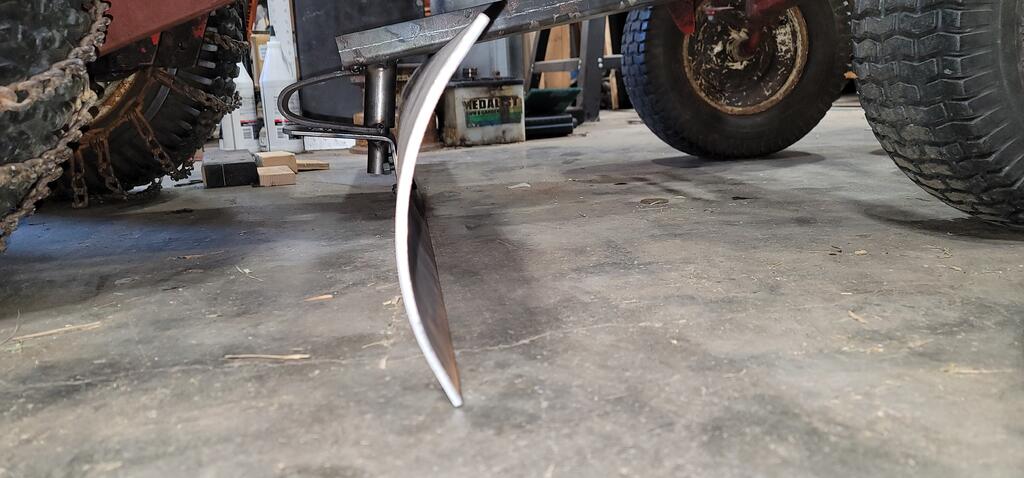

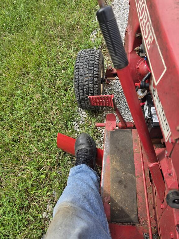

I had to pause working on the grader blade due to the sale of a motorhome.  I had a lot of prep to deal with the sale.  Anyway I'm now back working the blade.  The pivot shaft is now tack welded to the sector plate which enabled me to mount the assembly on the tractor.  Before I go any further, does the angle of the blade look correct?  It's sitting on the ground on the floor.  There isn't a whole lot I can do if it isn't right other than drill new holes in the blade.
On the overall length of the blade, this one is 48" and it seems that the original would  have been 42".  I think I've seen 50" listed somewhere but I could be wrong on that.  Is 48" going to be to much of a blade for the B80 or B100?

Handy Don
Nice work there!
That blade angle at the bottom edge will do its best at mild scraping plus spreading/leveling and even with 48” an 8 or 10 it will manage fine. It will not be much use on unbroken soil/gouging which is just as well ‘cause for that you’d need some extra oomph anyway! (And remember, pressing down too much on the blade with your feet helps the blade but lessens the weight on the wheels and can cause wheel spin!)
Another good idea is to avoid heavy uneven loading while it is in use. Excessive pull on one end will try to torque the mid-hitch/frame.
The longer WH blades are mounted to the rear axle, similar to a front blade. They can be more aggressive since they tend to dig in when under load where the mid-mount blades tend to lift when under load.

BradKahler
3 hours ago, Handy Don said:
Nice work there!
Thanks for the info.  The main reason I wanted a grader blade is to deal with the gravel on my 1500' driveway.  It tends to mount up on the outside edges and what I'm hoping to do is set the blade at an angle and slowly pull the gravel back onto the driveway with the blade.  The dozer blade doesn't work well for that application so I'm h oping this solves my gravel spreading problem.  I suppose this could cause the torquing of the blade you mentioned, but I hoping that since it is loose gravel it won't be a big issue.

Handy Don
It is, but if you take small bites, it should be fine. (More seat time, too!) 😉

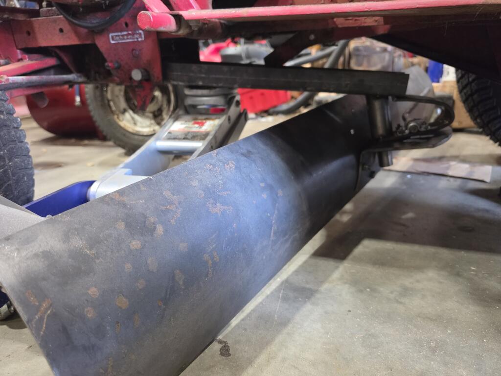

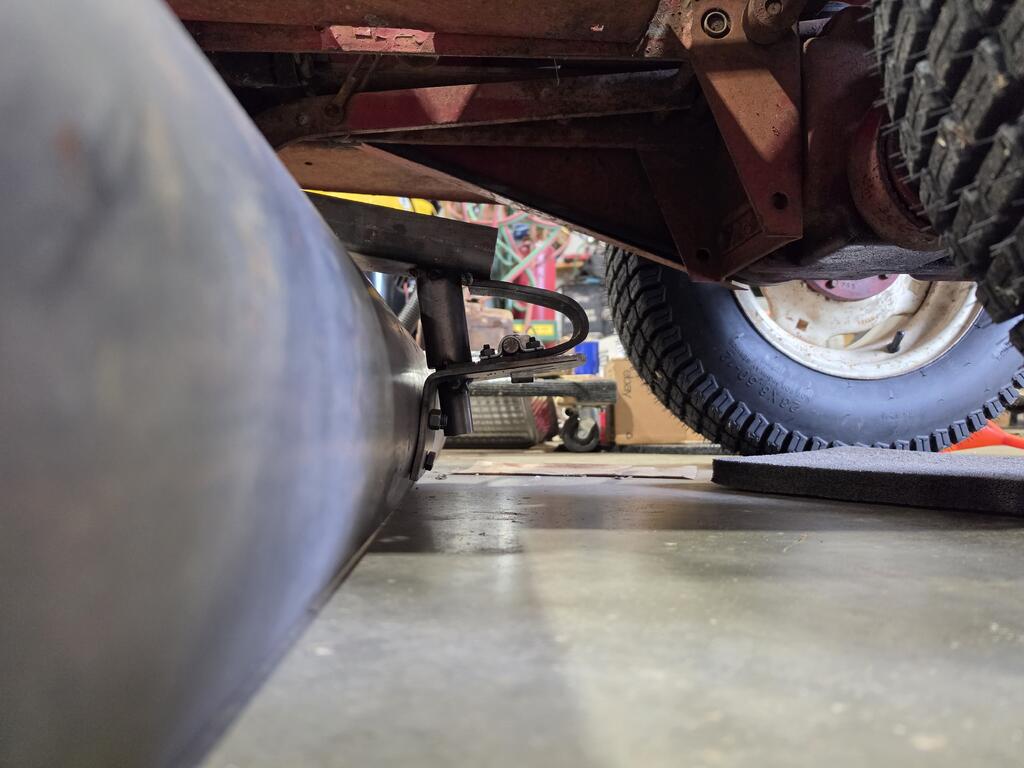

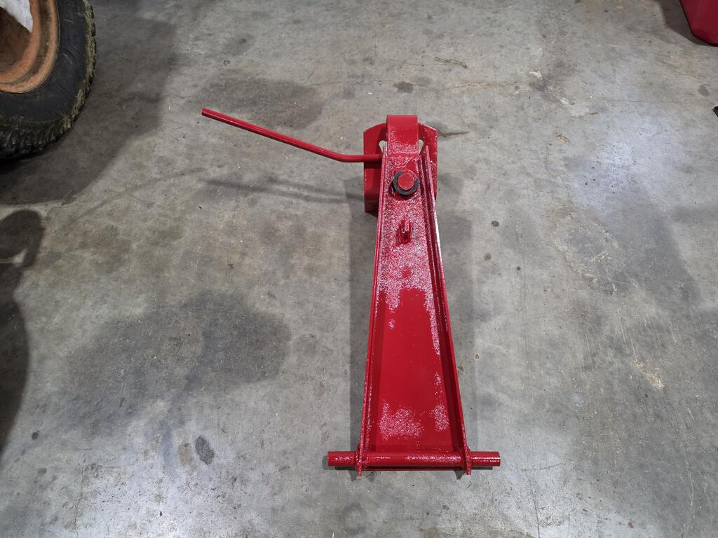

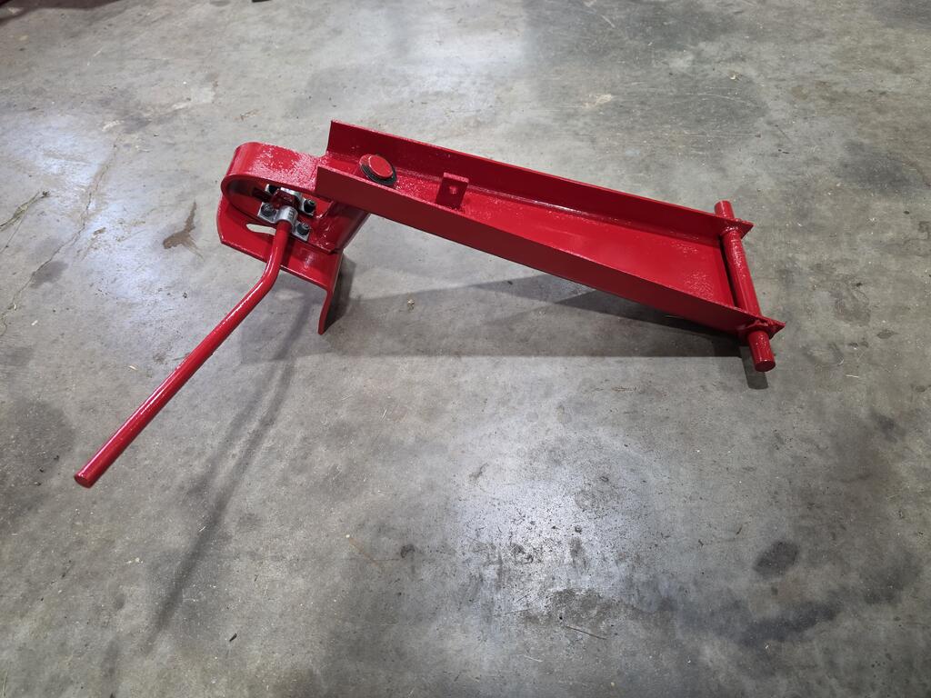

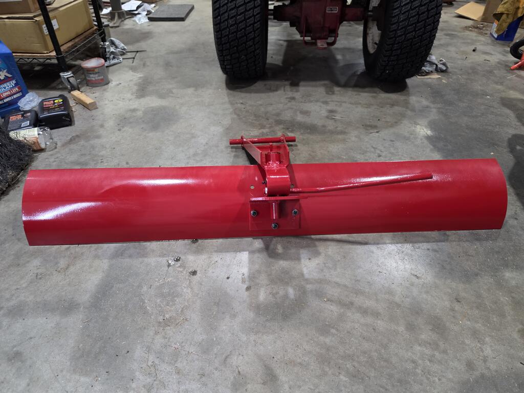

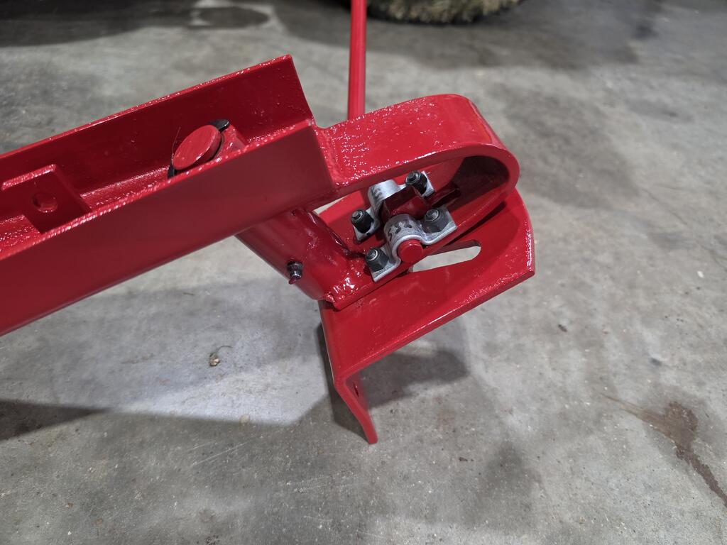

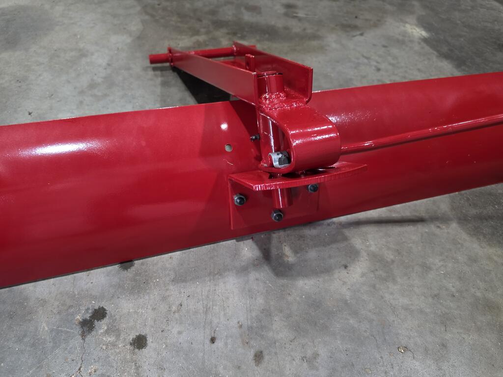

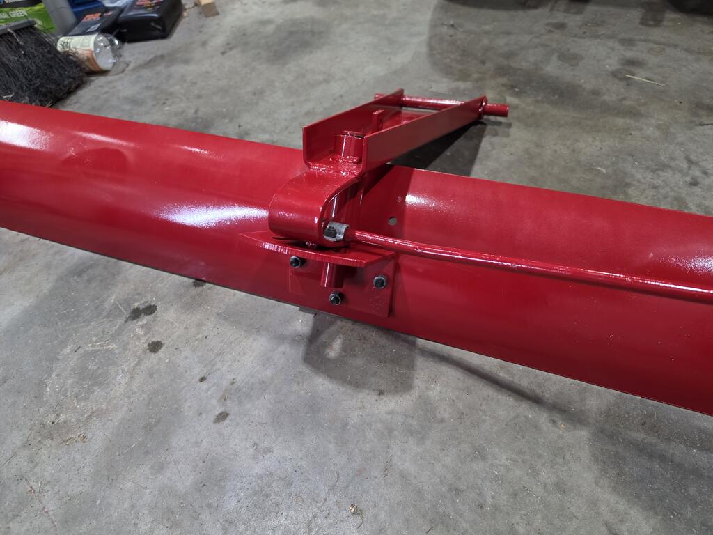

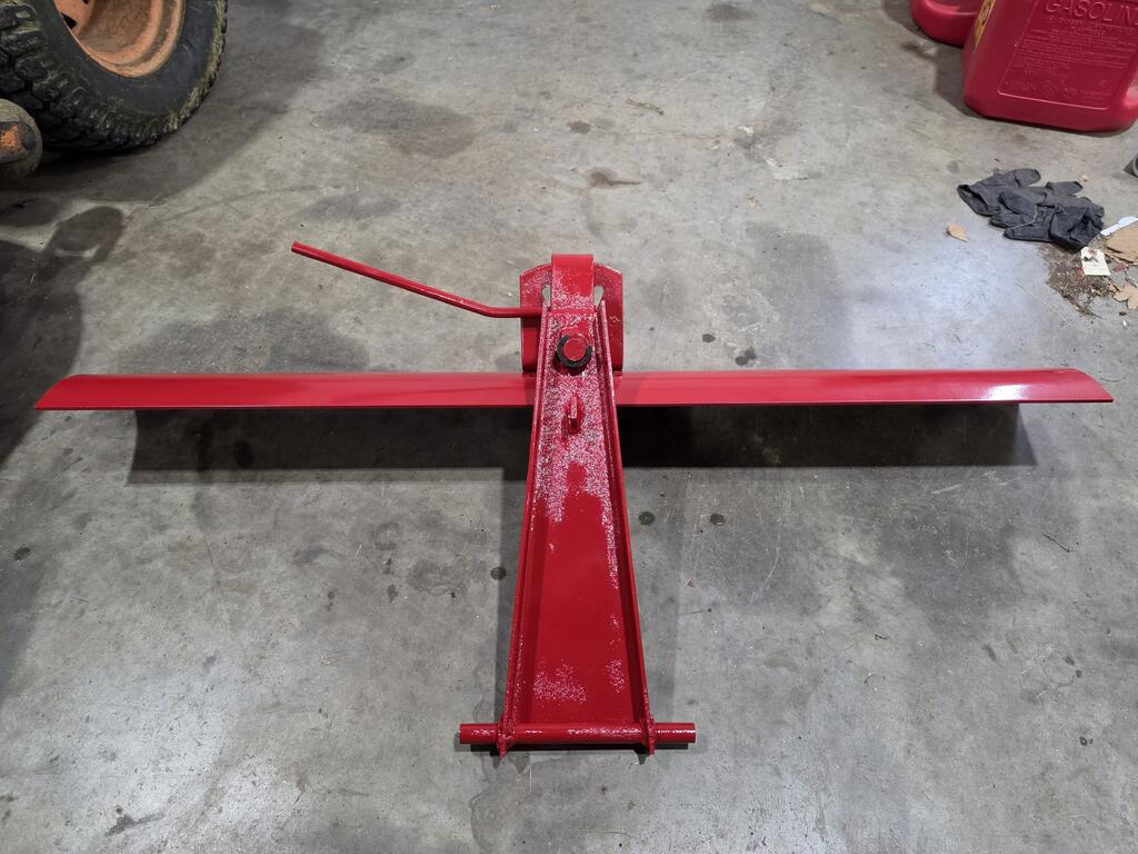

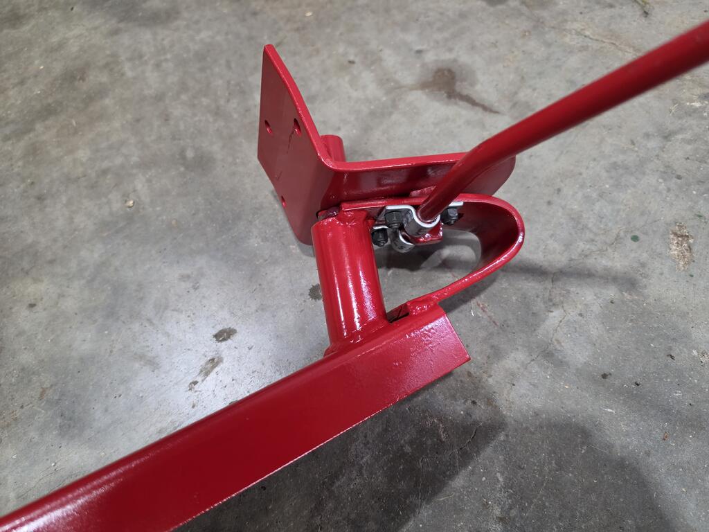

Ok, I've got an update or two on my progress with the grader blade fabrication.  Other than the lifting tab and final welding the fabrication and assembly is done.  The blade pivot mechanism works nicely although I might revise the handle slightly to make it easier to manipulate from the seat.
One thing I noticed is how the blade tilts slightly when it's rotated to side, in other words the tip of the blade is about 1" lower on the leading side and 1" above the ground on the trailing side of the blade. The rotation angle is 22-1/2 degrees.  I've attached some pictures to hopefully show what I'm talking about.
The lower outside leading tip of the blade is about 1" below grade when rotated.
The tilt is created due to the trailing angle of the pivot pin when the blade is lowered to the ground.  Based on all of the measurements supplied I believe my fabrication pretty much to matches the original design.  Would I be correct in assuming that when the blade is rotated the design calls for the blade to be tilted slightly when rotated?  If not, the only way I can think of that might resolve the tilt would be to mount larger diameter tires.  The blade is 48" wide which is 8" wider than the original designed called for, so maybe this is part of the problem.  Currently I have brand new 22x8.5-12 tires installed but could go to 23x9.5-12 or 23x10.5-12 tires to raise the rear a little.  Or, maybe the bigger question is, am I over thinking this?!  I don't want to do all of the final welding only to find I did something wrong.

ebinmaine
My eye-cromiter shows good angles in your pics.
I'll check with Trina if/when I can get her to slow down long enough.  :lol:
  • Thanks 1
ebinmaine
I just went out to look at the  @Sparky tractor that currently has the grader mounted.
When angled,  the forward edge is at least an inch lower. Maybe more.
Yours is fine.

BradKahler
That would be great!
BradKahler
Yours is fine.
:handgestures-thumbupright:
Thank you Thank you Thank you!!!
I feel a lot better knowing that it's at least close to what the original design is.  Now to finish up the lifting tab and link.
Thanks again!
Brad

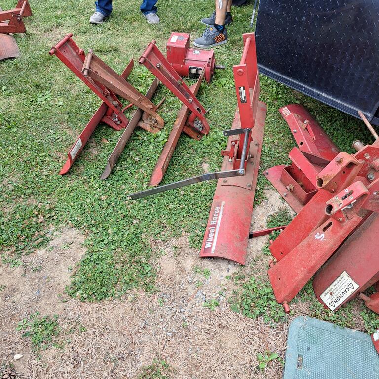

WHX??
On 4/24/2026 at 5:46 PM, sqrlgtr said:
and sell me one
You missed out Squirrels ... there was a guy at the BS that had just a pile of them. He was the guy from Canada I believe. I asked him the prices and he wasn't exactly giving them away. About average prices we see tho and he was doing mods to make them more user friendly.
Gotta applaud you Brad for making your own. @Achto makes a lot of his own stuff just for the satisfaction.
Only thing i can suggest is a different way to do the lock lever. A real PIA to work when it accumulates gravel dust & dirt and for us old farts to bend over for it. :)

BradKahler
Thank you the kind words. I like making things and this one has been a unique challenge due to all of the angles and curves involved.
I do plan on looking at the locking mechanism once I get everything finished and have a chance to use it.  I've already realized trying to rotate it isn't the easiest.
