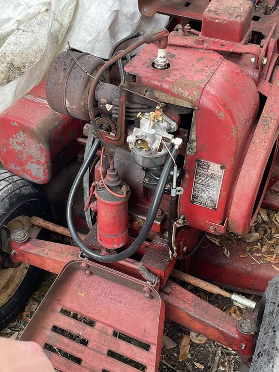

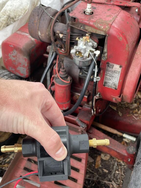

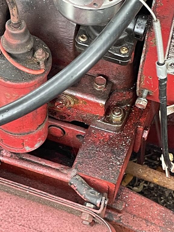

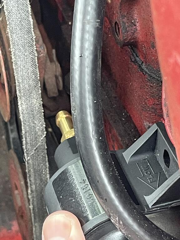

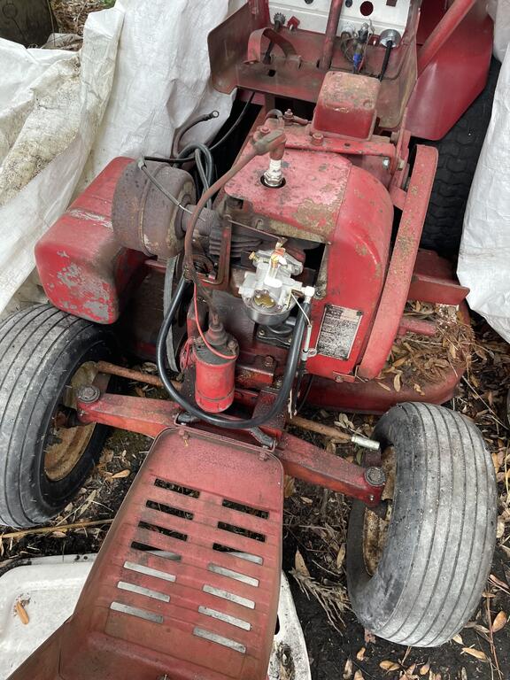

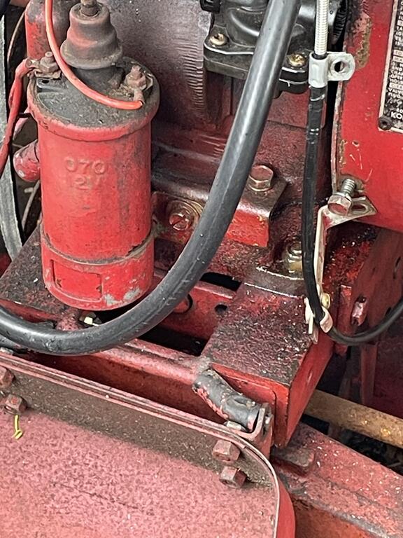

FLtractor 196 #1 Posted April 9 Afternoon, I cannot find any suitable mounting locations for this facet fuel pump on my 856. Any recommendations? Thought about coil boil, open side hole on frame near the exposed pulleys but awfully close. Thought zip tie and or hose clamp to front axel and extend ground to frame while running positive fuel pump wire to coil. 1 Share this post Link to post Share on other sites

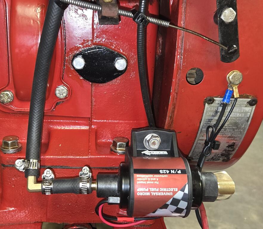

kpinnc 18,849 #5 Posted April 9 (edited) Get you a couple brass elbows and you can mount it up front. I do suggest you use the included filter that comes with the pump. I made a small L shaped tab and used one oil pan bolt to secure mine on the Bronco. Edited April 9 by kpinnc 3 2 Share this post Link to post Share on other sites

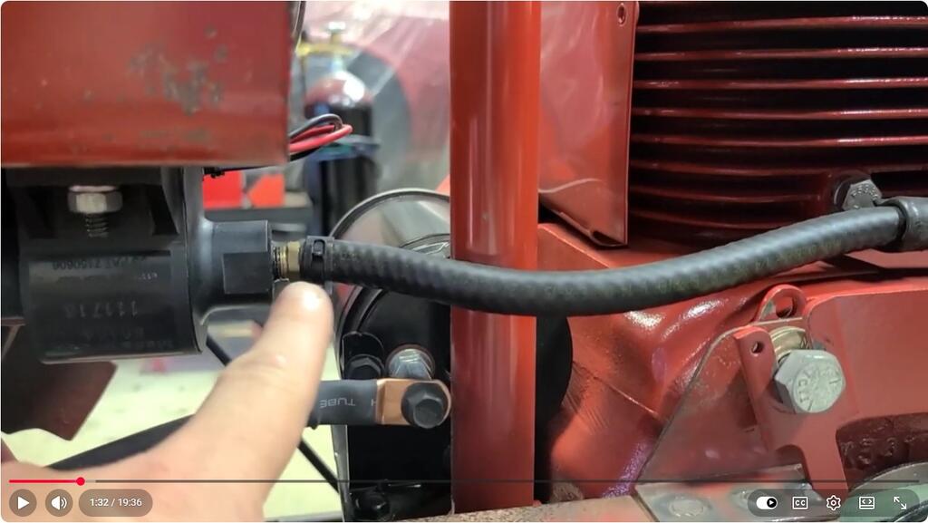

Mike'sHorseBarn 3,637 #6 Posted April 9 Took a screenshot from a YouTube video for you to look at @VinsRJ put his pump under the tank on his 857 project. That would be a much better spot. 1 Share this post Link to post Share on other sites

FLtractor 196 #8 Posted April 9 2 hours ago, Mike'sHorseBarn said: Took a screenshot from a YouTube video for you to look at @VinsRJ put his pump under the tank on his 857 project. That would be a much better spot. Thank you. Do you happen to have the full video link as well? Share this post Link to post Share on other sites
Mike'sHorseBarn 3,637 #9 Posted April 9 1 hour ago, FLtractor said: Thank you. Do you happen to have the full video link as well? https://youtu.be/ctTXESXH6_U?si=kqc7BOOCBbA60bxM 1 Share this post Link to post Share on other sites

FLtractor 196 #12 Posted April 10 (edited) 1 hour ago, Mike'sHorseBarn said: https://youtu.be/ctTXESXH6_U?si=kqc7BOOCBbA60bxM Does RJvin still post or frequent this forum anymore? Wanted to ask him exactly how he screwed the fuel pump up into the tank straps or pan the tank sits in.. watched the video but with the spacing of the fuel pump mounting holes and the fuel tank pan … it doesn’t quite make sense where it was screwed up into Edited April 10 by FLtractor Share this post Link to post Share on other sites

FLtractor 196 #14 Posted April 10 6 hours ago, kpinnc said: Get you a couple brass elbows and you can mount it up front. I do suggest you use the included filter that comes with the pump. I made a small L shaped tab and used one oil pan bolt to secure mine on the Bronco. Do you happen to have a picture showing how it’s attached to the tractor frame? You just used one fuel pump bolt to hold it in place? What size brass fitting are they? 1 Share this post Link to post Share on other sites
kpinnc 18,849 #15 Posted April 10 3 hours ago, FLtractor said: Do you happen to have a picture showing how it’s attached to the tractor frame? You just used one fuel pump bolt to hold it in place? What size brass fitting are they? I don't have pics but it was L shaped with 3 holes drilled: one for the oil pan bolt and two for the pump. Fittings are 1/4 barbed elbow and I think a 3/8 NPT street elbow. 1 Share this post Link to post Share on other sites
Stan50 213 #16 Posted April 10 @kpinnc That block off plate - did you use regular fuel pump gasket with that plate? I fabricated similar block off plate, they layin on the shelf with CarBole fuel pump, waiting for mechanical pump failure Share this post Link to post Share on other sites
kpinnc 18,849 #17 Posted April 10 2 hours ago, Stan50 said: That block off plate - did you use regular fuel pump gasket with that plate? I fabricated similar block off plate, they layin on the shelf with CarBole fuel pump, waiting for mechanical pump failure I just used gasket material and some silicone dressing just in case. But a regular fuel pump gasket will work just fine. 2 Share this post Link to post Share on other sites

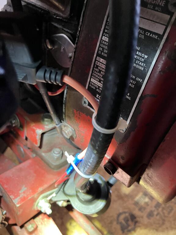

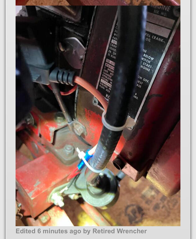

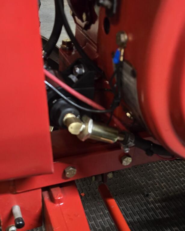

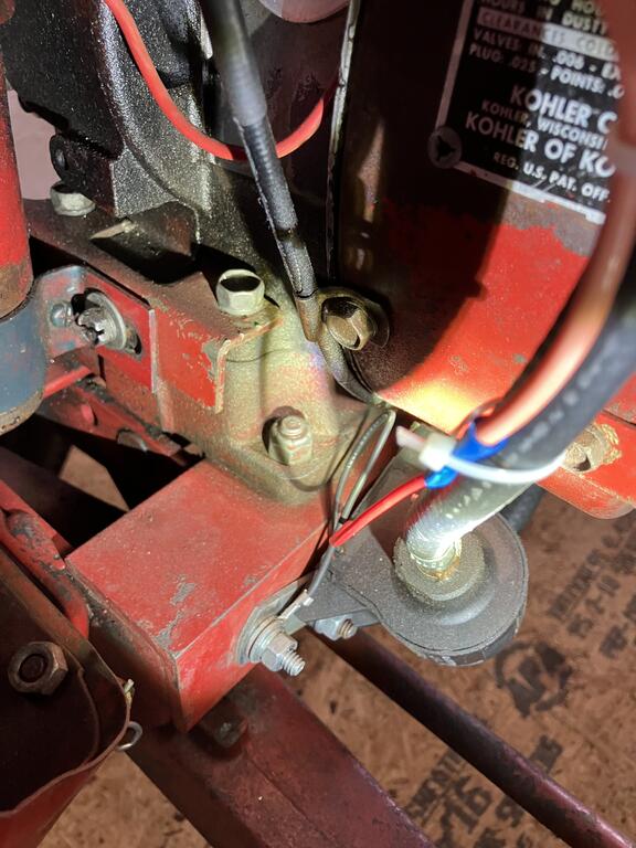

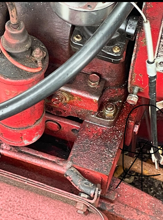

Retired Wrencher 6,899 #18 Posted April 10 (edited) FLtractor: The first is mounting second is wirier with fuse. This is on the 856. Works fine so far two years now. Edited April 10 by Retired Wrencher 1 Share this post Link to post Share on other sites
FLtractor 196 #19 Posted April 10 5 hours ago, kpinnc said: I don't have pics but it was L shaped with 3 holes drilled: one for the oil pan bolt and two for the pump. Fittings are 1/4 barbed elbow and I think a 3/8 NPT street elbow. Interesting. What size bolts did you use inside the facet fuel pump mounting holes? Share this post Link to post Share on other sites

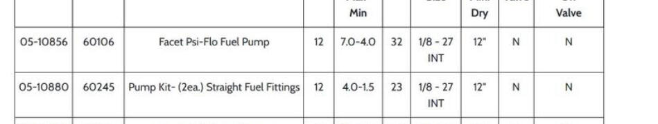

Retired Wrencher 6,899 #20 Posted April 10 (edited) One more thing what model did you get =1 to 2 psi or different? Edited April 10 by Retired Wrencher Share this post Link to post Share on other sites
FLtractor 196 #21 Posted April 10 (edited) 28 minutes ago, Retired Wrencher said: FLtractor: The first is mounting second is wirier with fuse. This is on the 856. Works fine so far two years now. So you used this hole here .. and you drilled a second hole into the support frame for other fuel pump bolt hole? went with #. 60245 given yours is on the other side of most I’ve seen.. do you have a picture of how you ran your fuel line from tank to fuel pump to carb? Edited April 10 by FLtractor Share this post Link to post Share on other sites
Retired Wrencher 6,899 #22 Posted April 10 (edited) I used one bolt to the frame and second to the pump with steel with pre drilled holes in it. I do not remember the name of the steel, it has multiple holes. I can take a picture of it today. That’s how I adapted it. Can paint it to blend it in with the rest of the car or just leave it. It’s a short piece anyway I’d say maybe about an inch and a half. Edited April 10 by Retired Wrencher Share this post Link to post Share on other sites
