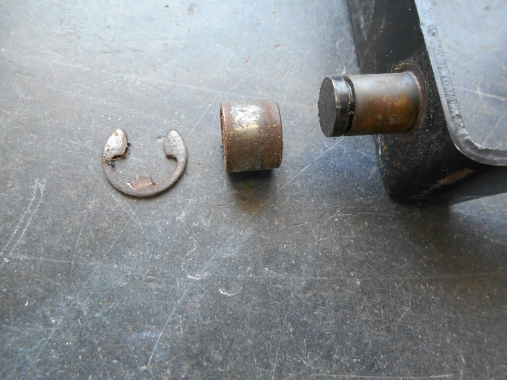

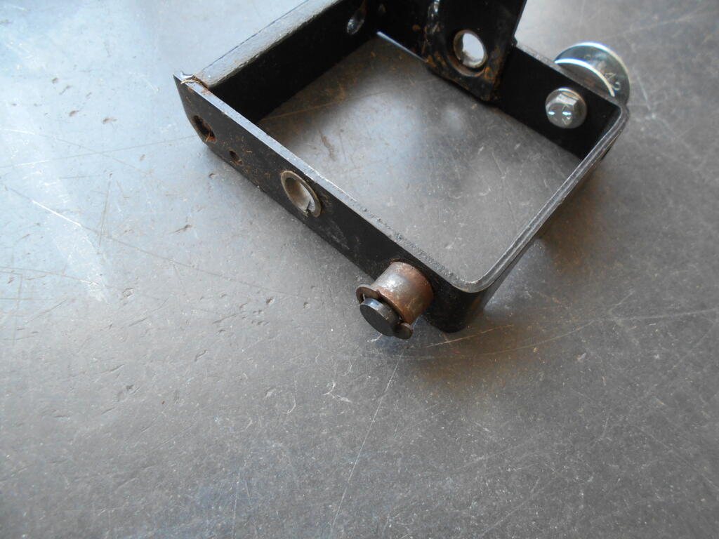

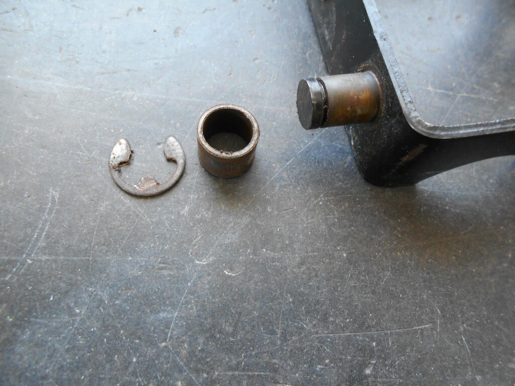

cleat 9,426 #5 Posted April 8 13 hours ago, cleat said: it is welded in. Never seen one break off, I wonder if someone removed it on purpose for some reason. Unless you have access to a welder it may be easier to just replace the cam as there should be some of them around. I guess you could use a shoulder bolt. I will get you the dimensions tomorrow. Here is what your cam should look like. Disregard the bearing on the far side, that is for my foot control self centering. This is the welded on post that you are missing. You should already have the hole in your cam from where it was mounted originally so I don't need to give the dimensions for that. Post measurements are: 0.49" diameter 0.53" from cam to E-clip groove. 0.70 from cam to end Roller dimensions are: 0.575" Inside diameter 0.6255" Outside diameter 0.488" long 1 Share this post Link to post Share on other sites
