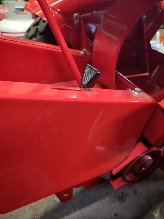

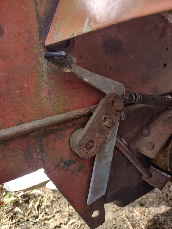

Achto 32,963 #6 Posted April 5 (edited) 27 minutes ago, Bbrown said: It looks like the 605 lever sits low down near the brake drum and you push it down to lock , the 502 has a cut out in the tin and the lever points upward and you would pull it reword to lock. You're correct, the upper portion of the handle is different. Here is a pic of the one on my 855 (same as a 605 handle) This is a pic of the one on my 633 (same as your 502 handle) You should be able to use a lever on yours from any 1962 - 1964 model. Incase you did not know. The last number in the model number will indicate the year of the tractor from 1960 - 1967. Your 502 would be a 1962. Edited April 5 by Achto 2 2 Share this post Link to post Share on other sites
Bbrown 6 #7 Posted April 5 (edited) Achto that is exactly what I was looking for! Your 633 looks awesome just from that picture, I can only imagine what the rest looks like. Thank you I will continue my search . Living on a hill I think the parking brake is a necessity, the only flat spot I have is in my barn. Edited April 5 by Bbrown 1 Share this post Link to post Share on other sites

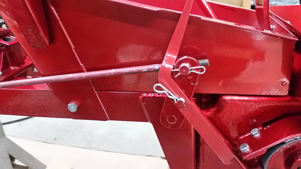

WHX?? 58,388 #9 Posted April 5 This is on a 702 but should be the same. I may have one if @Easton Rich doesn't. Be a few days before I can look. 2 2 Share this post Link to post Share on other sites

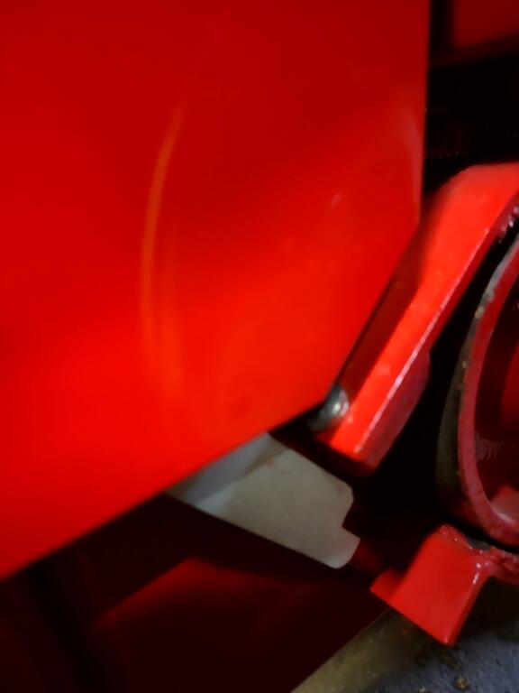

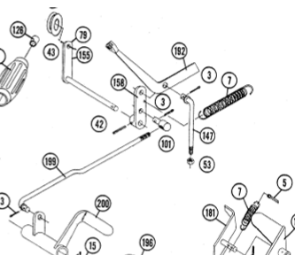

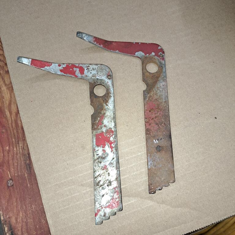

WHX?? 58,388 #22 Posted April 29 (edited) @Bbrown Here's what I have Bob. Not sure if it's the right one for a 502 or not. It's got the notches on the bottom but I don't think that would matter. The IPL shows it smooth from what I can tell and the same 4417 part number for both tractors. It also doesn't show the offset like I pictured above and that's on the 702 flame. 'Course that doesn't mean that is right either. Hopefully the guys can chime in. @Achto isn't the side cover missing on your 702 maybe look? Sorry for sleeping at the switch on it Bob. I come back from @Pullstart plow day and plum forgot. Edited April 29 by WHX?? Share this post Link to post Share on other sites

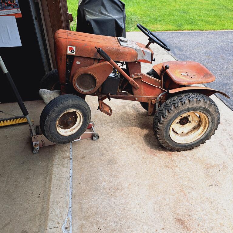

WHX?? 58,388 #23 Posted April 29 (edited) Never mind Dan it's missing on your 702. Did we take it off for some reason? Note 702 next to we parted out has one on it. The mystery deepens ... your 702 again Dan. At this point I am at a total loss for which is correct. One style mounts to the clutch rod one mounts to the brake arm. Edited April 29 by WHX?? Share this post Link to post Share on other sites
Bbrown 6 #24 Posted April 29 @WHX?? I think the one on your 702 is what I need. There’s no room on the clutch rod grunion but on the brake rod it looks like it will fit. Thank you for checking I’ll keep hunting Share this post Link to post Share on other sites
WHX?? 58,388 #25 Posted April 30 I concur Bob. I do have the style with the offset but I will most likely need it for a 702 resto I have planned or Dan may need it when he restores his. So I can't offer it at this time. Dan I'm not so worried about he has been known to fabricate them if he has one to copy. By my way of thinking I should have an extra if I could find it ... I'll keep looking. The only thing I can suggest for now is put an ad in classifieds/wanted for one. Share this post Link to post Share on other sites
