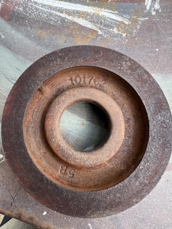

19richie66 17,935 #1 Posted April 4 I have a mule drive that came off of something I aquired over time. It’s the only one I have seen with a cast pulley. Trying to find out what bearing it takes. Anyone have anything on it? Pulley number 101762. I have looked but found nothing on it. Thanks in advance. Share this post Link to post Share on other sites
ri702bill 13,065 #2 Posted April 4 Where is that pulley used?? Share this post Link to post Share on other sites

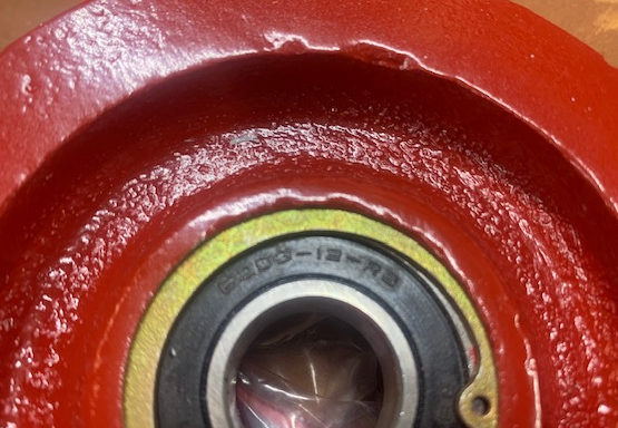

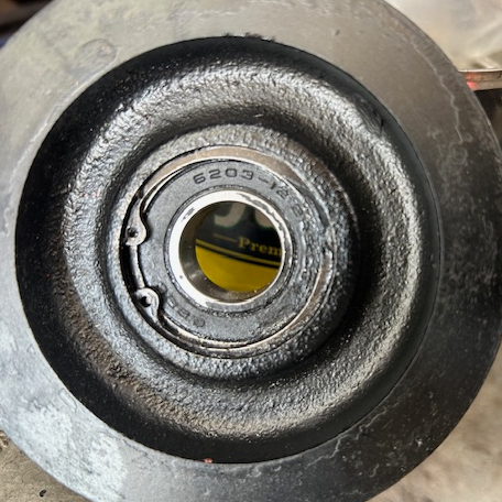

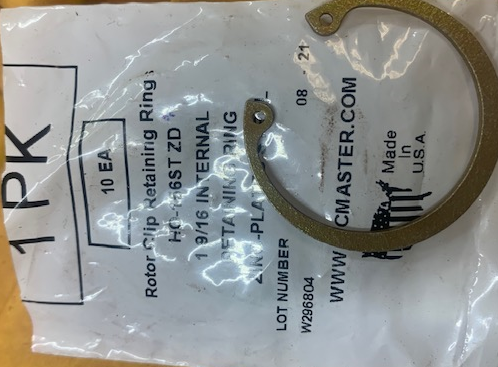

JoeM 10,267 #3 Posted April 4 I believe that is a 6203-12 bearing I can double check tomorrow my pic did not show a clear number. 40mm od 3/4 id. 12 mm thick I am pretty sure it is the same as the 3/4" deck berings. snap ring 1 Share this post Link to post Share on other sites
peter lena 10,065 #4 Posted April 4 @19richie66https://www.google.com/search?q=wheel+horse+mule+drive+bearing&rlz=1C1CHBF_enUS866US866&oq=wheel+horse+mule+drive+bearing+&gs_lcrp=EgZjaHJvb , might help , also personally look for any bearing with wide rubber side grease shields , carefully remove , flat pocket screwdriver or small putty knife, wipeout original lube , usually ceiling fan , grease . thats why those bearings whine / and fail , lucas geen chassis grease X-TRA HD , 550 deg flash point , polyurea rated , so it stays there , have that conversion in all my deck spindles as well , no noise or failures since change out . make the problem stop , pete 1 Share this post Link to post Share on other sites
squonk 48,125 #5 Posted April 4 57 minutes ago, JoeM said: I believe that is a 6203-12 bearing I can double check tomorrow my pic did not show a clear number. 40mm od 3/4 id. 12 mm thick I am pretty sure it is the same as the 3/4" deck berings. snap ring Yes. 6203-12- RS. I have one in my desk drawer for just the occasion someone asks! 2 1 Share this post Link to post Share on other sites

JoeM 10,267 #8 Posted April 5 I stopped in the shop and confirmed the 6203-12 bearing. Share this post Link to post Share on other sites
19richie66 17,935 #9 Posted April 5 (edited) Thank you. I ordered some. Much appreciated! Edited April 5 by 19richie66 1 Share this post Link to post Share on other sites
