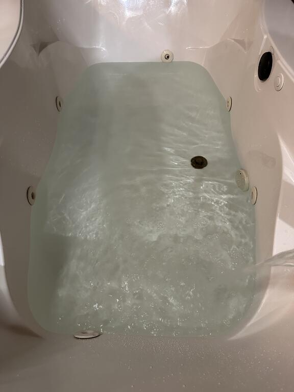

Pullstart 71,561 #2 Posted April 5 Lotsa water running clean tonight. Flow has improved greatly! 3 Share this post Link to post Share on other sites
