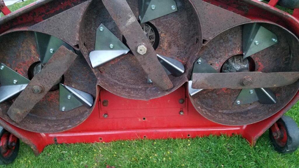

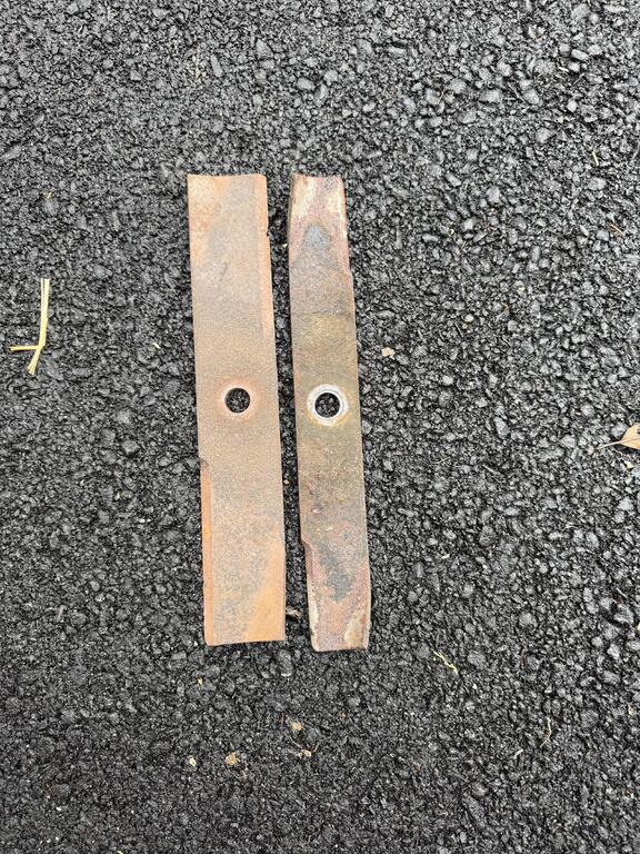

nylyon-(Admin) 9,066 #1 Posted March 31 I bought my 416H new and ordered it with a 42” Recycler. They didn’t have a recycler deck so they gave me a 42” RD and ordered a recycler kit, which is the same thing. I would take the kit of on the spring because it would clog up WAY too much with wet grass, it’s really a dry grass attachment. Through the years, I just stopped putting the recycler on. Last year I got a KILLER deal on a 42” Recycler, brought it home and just hooked it up and it worked nicely but didn’t recycle like I remembered my old one doing. Well, getting things ready for this year, I took off the snow blower, and dragged up the 42” Recycler to put on the 416-8. I still have my daughters 310-8 with a restored 42” RD for wet grass. Anyway, I wanted to sharpen the blades and turned it upside down and something looked off. Left is a real recycler blade, right is what came off the deck. Well, the recycler NOW has 3 sharp RECYCLER blades. 2 Share this post Link to post Share on other sites

squonk 48,211 #3 Posted March 31 I have a Recycler deck plus a set of new blades the manual calls for. My blades look like the ones you pictured on the right. Share this post Link to post Share on other sites
Handy Don 17,558 #4 Posted March 31 Ours look like @squonk’s, as well. Without lift, the cuttings do not circulate to get chopped up to fall down past the blades at the perimeter. In our experience grass length, blade sharpness, and travel speed are ALL critical for a good cut. If the grass is drooping over or wet, the blade is dull, or the tractor is moving too fast the cut starts to be uneven. Share this post Link to post Share on other sites
nylyon-(Admin) 9,066 #5 Posted March 31 2 hours ago, squonk said: I have a Recycler deck plus a set of new blades the manual calls for. My blades look like the ones you pictured on the right. Do I have it reversed? Are the wider blades the standard blade and narrower blade the recycler? I could have sworn the wide blades was the recycler. Share this post Link to post Share on other sites
sqrlgtr 4,091 #6 Posted March 31 The blade on the left looks like a blade off my Toro commercial zero turn all the other Wheel Horse blades I have look like the one on the right. 1 Share this post Link to post Share on other sites
nylyon-(Admin) 9,066 #7 Posted March 31 I am 99% sure the blade on the left is the recycler blade. Maybe I’ll buy a new set to compare? Share this post Link to post Share on other sites

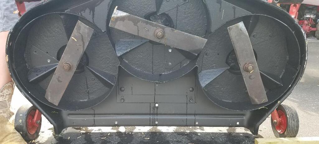

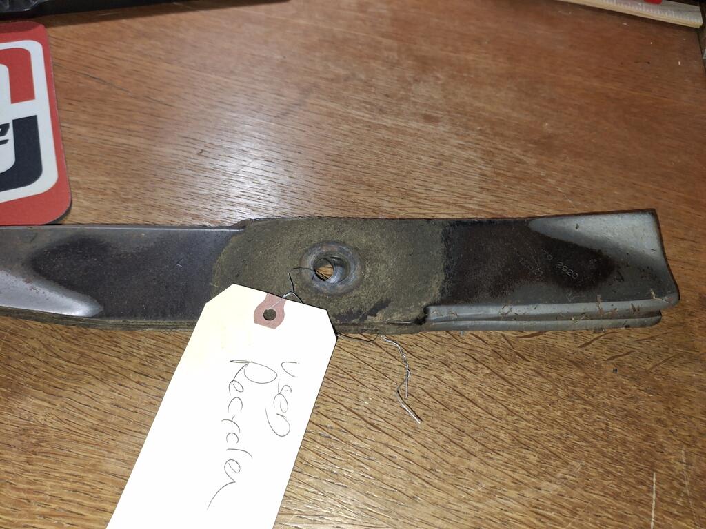

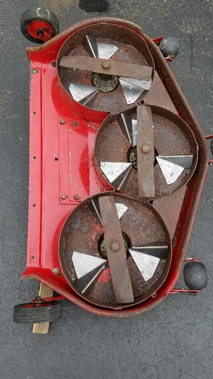

nylyon-(Admin) 9,066 #8 Posted March 31 @squonk are these wider? Post #29 And this one from @Brockport Bill definitely the wider blade. Share this post Link to post Share on other sites
Brockport Bill 2,479 #9 Posted April 1 various 42 recyclers Share this post Link to post Share on other sites
nylyon-(Admin) 9,066 #10 Posted April 1 Right, definitely the wider blade. Thought I was going crazy for a moment. Share this post Link to post Share on other sites
Handy Don 17,558 #11 Posted April 1 1 hour ago, Brockport Bill said: various 42 recyclers Well that tells me I may be buying new blades for our recycler! Share this post Link to post Share on other sites

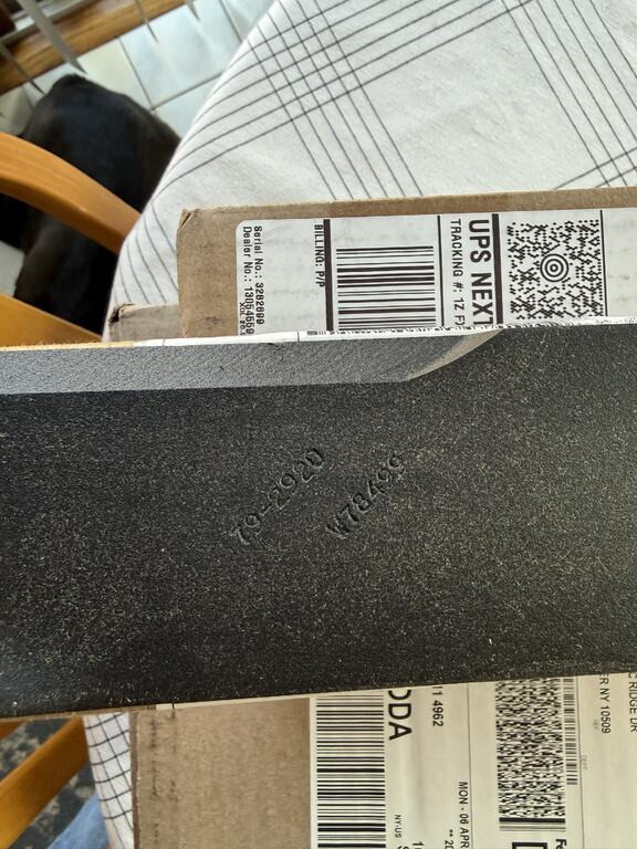

squonk 48,211 #14 Posted April 2 @nylyon @Handy Don Here is a pic of the original blades that came off my recycler. They are only 14" long X 2 25" wide. Part # 79-2920 1 Share this post Link to post Share on other sites

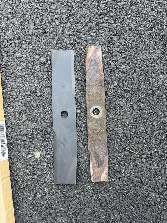

nylyon-(Admin) 9,066 #15 Posted April 3 Those look more like the wide ones. I did buy a new set, they are getting harder to find, should be here on Monday. Didn’t really need a new set, but these will very soon be NLA so might as well stock up. I will post and measure the dimensions when I get them. Share this post Link to post Share on other sites
squonk 48,211 #16 Posted April 4 On 4/3/2026 at 2:55 PM, nylyon said: Those look more like the wide ones. I did buy a new set, they are getting harder to find, should be here on Monday. Didn’t really need a new set, but these will very soon be NLA so might as well stock up. I will post and measure the dimensions when I get them. What part # did you order? Share this post Link to post Share on other sites
nylyon-(Admin) 9,066 #17 Posted April 5 14-4879 which is the set of 3 Share this post Link to post Share on other sites

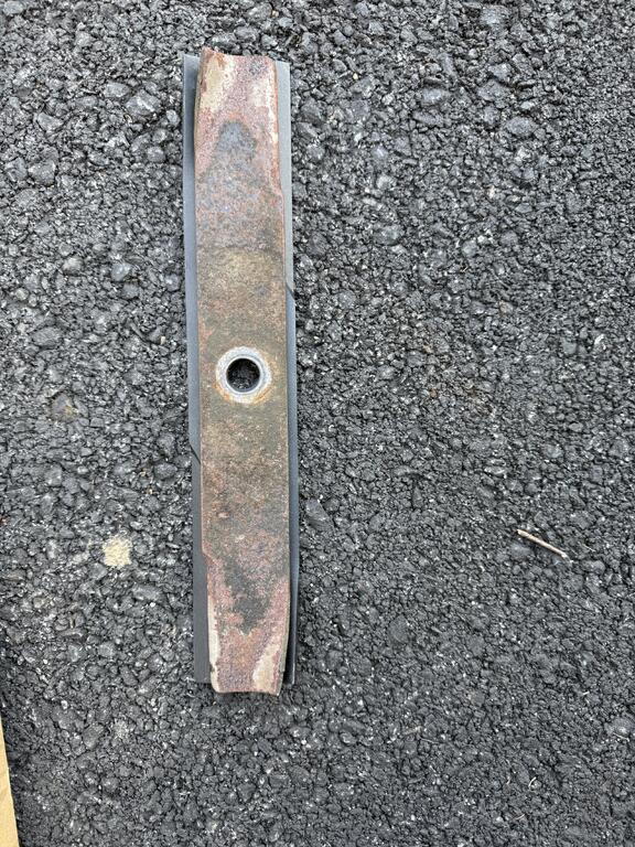

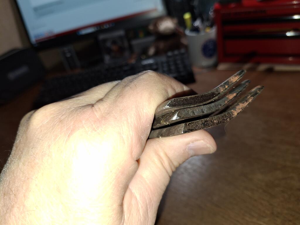

nylyon-(Admin) 9,066 #18 Posted April 6 The wide ones are definitely the recycler blades: 1 Share this post Link to post Share on other sites
