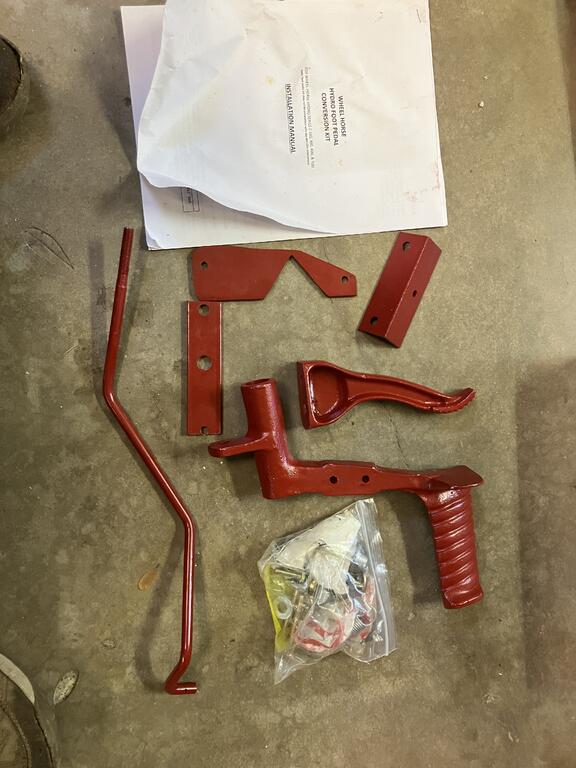

oliver2-44 11,745 #5 Posted March 13 (edited) Matts Foot Pedal was made for an Eaton But he would sell it for a Sundstrand and he would buy (extra $$) some part off Ebay (maybe off an Eaton) I'll see if I can figure out what it was. Edited March 13 by oliver2-44 Share this post Link to post Share on other sites

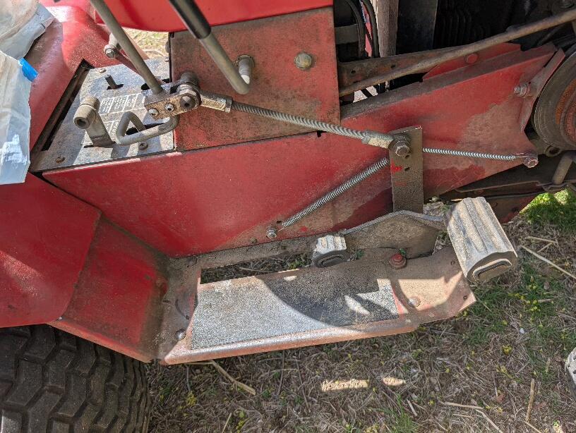

midpack 1,148 #6 Posted March 14 On 3/13/2026 at 9:52 AM, JoeM said: Seems as I remember someone having an external setup on a Sunny Strand. ??? I made one with a clamp on the motion control rod and a pedal from a 269H along with a couple springs to get it to return on its own. Not pretty but it works really well. Its probably been close to a decade but it still goes fine. 4 4 Share this post Link to post Share on other sites

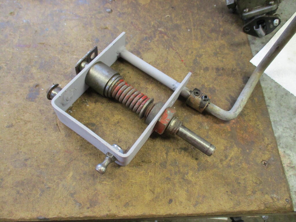

oliver2-44 11,745 #8 Posted March 14 Here,the standard parts in Matt’s Pedal Kit. For a Sundstrand he supplied this part to convert the motion control. Can someone confirm the vertical part is added on to a standard Eaton motion controller. Share this post Link to post Share on other sites

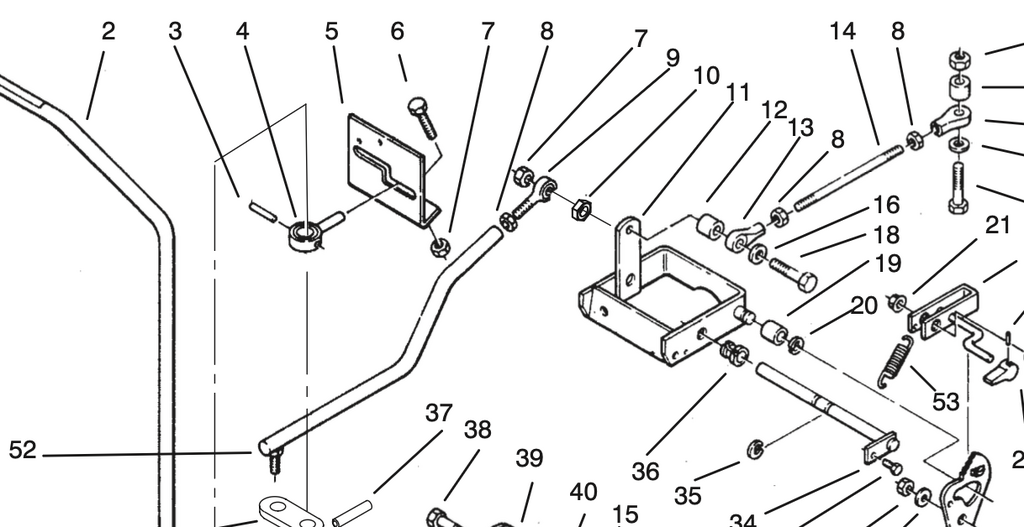

Handy Don 17,474 #9 Posted March 14 On 3/13/2026 at 10:27 AM, ebinmaine said: @Handy Don ? As you can see from @oliver2-44’s pictures, Matt’s kit took advantage of the existing rocker (Part #11 in this ’95 520-H IPL) by connecting his linkage in the same way that WH did with Part #52 from the column-mounted motion control lever. Parts 7-10 and 12-17 comprise the link between the #11 rocker and the Eaton motion control lever atop the transaxle. The rocker supplies “fore and aft” motion to the link. I haven’t seen details (either in person or on an IPL) of how the rocker translates control input motion to the vertical motion that the Sunstrands require. Share this post Link to post Share on other sites

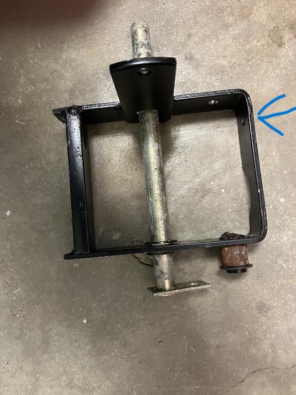

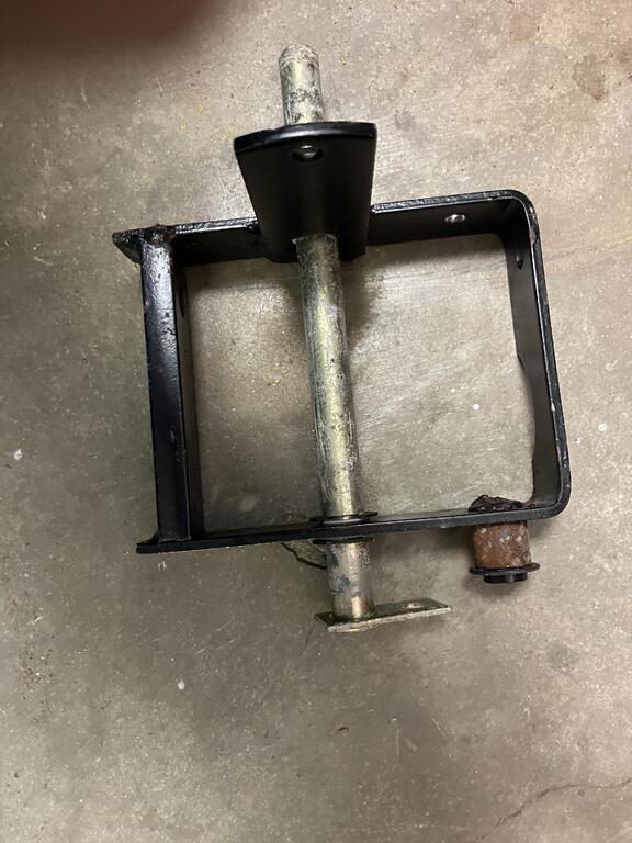

pfrederi 21,146 #10 Posted March 14 This is the sunstrand rocker. I guess if you put a ball end pin in the back of the eaton rocker you could get the vertical motion you need. I don't see it the picture oh Matts part above. Also not sure the pivot points are in the same location. 2 Share this post Link to post Share on other sites

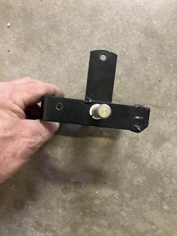

Bill D 3,156 #11 Posted March 14 3 hours ago, oliver2-44 said: Here,the standard parts in Matt’s Pedal Kit. For a Sundstrand he supplied this part to convert the motion control. Can someone confirm the vertical part is added on to a standard Eaton motion controller. That vertical part is standard. There is a hole on the rear right corner where you can add a ball stud. Share this post Link to post Share on other sites
pfrederi 21,146 #12 Posted March 14 47 minutes ago, Bill D said: That vertical part is standard. There is a hole on the rear right corner where you can add a ball stud. Are you sure??? ....the ball stud has to come out of the rear of the rocker to hookup with the plastic slider.... Share this post Link to post Share on other sites
Bill D 3,156 #13 Posted March 14 1 hour ago, pfrederi said: Are you sure??? ....the ball stud has to come out of the rear of the rocker to hookup with the plastic slider.... Pretty sure. There is a hole next to the notch in the rear. Should be where the ball stud goes. Only way I can see to make it work. For the record I only have Eatons in 400 series tractors, and have not done this conversion. Just trying to help. 1 Share this post Link to post Share on other sites
Racinbob 13,183 #14 Posted March 15 If that's the hole you're referring to it's not intended for ball stud. The installer has to drill that hole and mount a roller bearing there for the neutral return. Share this post Link to post Share on other sites
pfrederi 21,146 #15 Posted March 15 Is there a hole at the Blue arrow that might take the ball stud you need for a Sunstrand...however i don't know would be in alignment with the plastic slider Share this post Link to post Share on other sites
Bill D 3,156 #16 Posted March 15 49 minutes ago, pfrederi said: Is there a hole at the Blue arrow that might take the ball stud you need for a Sunstrand...however i don't know would be in alignment with the plastic slider That's the hole I was referring to in my previous post. 1 Share this post Link to post Share on other sites
