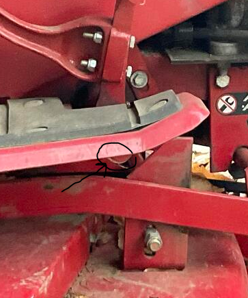

Lost Pup 187 #1 Posted March 8 Acquired this 520. Looked clean and cared for. Owners brother did not know much about it. Starts quick and runs well. Transmission is strong. First time for me with the foot control and dang it’s seems to far away. I am 5’ 10”. I think the foot lever needs adjustment. Are others with the foot control say the main pedal is 90 degrees or less to the floorboard or what ? This is my pedal at the current neutral position in the pic. My ankle got rather hot quickly from the vented cover. Thoughts and Suggestions are Welcome. Share this post Link to post Share on other sites
JoeM 10,067 #2 Posted March 8 (edited) Under the floor board there should be a Heim joint. You can unscrew the joint making the rod longer and that should bring the pedal closer to you. It does look like yours is to far forward. Edited March 8 by JoeM 4 2 Share this post Link to post Share on other sites
WHX?? 57,270 #3 Posted March 9 I have mine set so the reverse pedal is 1/4 -1/2" above the floor board. Share this post Link to post Share on other sites
cleat 8,994 #4 Posted March 9 Yes, as WHX?? said, adjust it so you get full reverse with the pedal just almost but not quite touching the floor board. That will get you full reverse speed with the main forward pedal as far back as it can be. 1 Share this post Link to post Share on other sites

Lost Pup 187 #7 Posted March 9 15 hours ago, JoeM said: Under the floor board there should be a Heim joint. You can unscrew the joint making the rod longer and that should bring the pedal closer to you. It does look like yours is to far forward. Thanks Share this post Link to post Share on other sites
peter lena 9,929 #8 Posted March 9 @Lost Pup agree with others on possible improvements , also like super lube, hydraulic oil on any related movement / swing point , that heim is a perfect transition connection , also first photo opportunity ? staring right at you ? PTO lever end to outer swing arm , clip, hole ? look at lower frame mount , hitch pin , clip hole ? like a light tension extension spring , curved , hook ends , connect the 2 , circular spring rings ? , lubricate , both mount points , takes the buzz out of the belt drive set up ., penetrating oil spray down , for the paint , will help bring it right back , make a deflector for the , hot ankle issue , that area , is known for cooked wiring issues , clean condition of unit , says a lot , pete 1 Share this post Link to post Share on other sites
Lost Pup 187 #9 Posted March 10 20 hours ago, peter lena said: PTO lever end to outer swing arm , clip, hole ? look at lower frame mount , hitch pin , clip hole ? like a light tension extension spring , curved , hook ends , connect the 2 , circular spring rings ? , lubricate , both mount points , takes the buzz out of the belt drive set Pete Do you have a picture on this one suggestion ? Thanks Share this post Link to post Share on other sites
