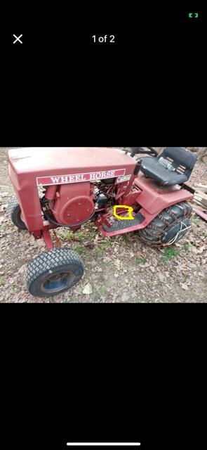

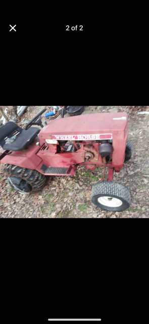

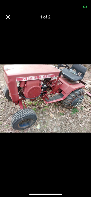

Not mine… yet!! The man described it as running, needs work. C160 8 speed. It was obviously set up as a plow tractor. W/o the PTO clutch the mower lever, and chains and weights. Loud muffler!! Just the tractor, no attachments. It’s 1.5 hours away from home. Honestly, it looks in pretty good shape for being 50 y/o. Ive got an idea what it’s worth, but I don’t wanna over pay. What’s it worth?

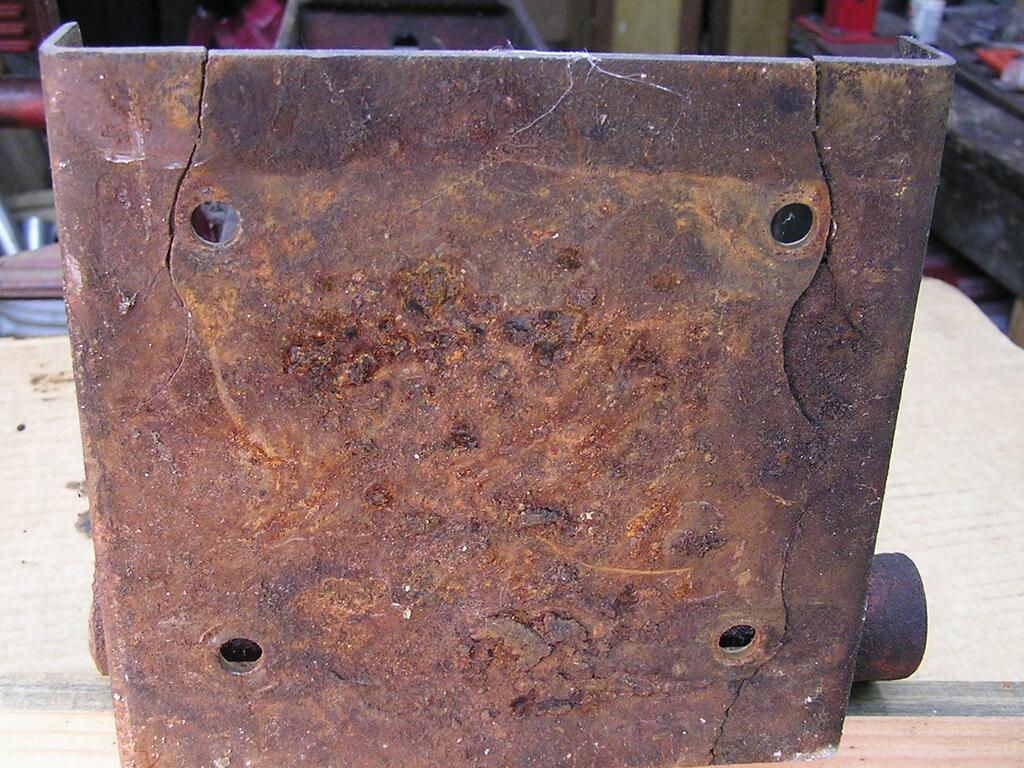

OK, there's a few flags..... You need so inspect the 4 Unidrive mounting holes on the "F" plate for cracking. On the later tractors, the plate material is thinner than the earlier ones and ribs were added. Get a look at the plow that was used. If the moldboard is all distorted like a prize fighters nose, it has seen hard use... Time consuming to fix properly.
Also look at the ears on the lower steering block - one or both may be broken off due to the twisting action on the frame in use. Common part.
Pull both dipsticks to check the condition & level of the fluids. Water in the Unidrive is a milky mess on the dipstick.
Check the four seals on the Unidrive for leakage.
Get an honest explaination on "needs work" Any or all of the things I mentioned are repairable, with your time & money, and all affect the price.

 Seat looks to bedecent. Worth $100 at least.
Check the frame/hoodstand area directly under the lift lever. I've run across several with it cracked there.

The 3-sided plate at the rear of the frame.
I bought this 854 for parts - only one hole was not cracked out, and the frame itself has a 1/4" twist... the tractor walked & wiggled like an inchworm.

AHS
Wow!! Holy!! Look at the cracks!!

AHS
1 hour ago, ineedanother said:
That's what @ri702bill and I both referenced. It's what the UniDrive bolts to. A dozer blade attached to the axle bracket can twist and stress the frame enough to cause considerable damage. Lots of discussion over the years here about it.
Holy smokes!!! It looks like someone rammed into snow banks, etc, (I don’t even wanna know!!). The previous owner of my 00 312-9 bent the plow blade up on either end…. I just didn’t want to know and never asked!! Like @JCM quoted; D8!!! That should say enough!!

ri702bill
And THAT is why that area needs to be looked at while the cash is still in the wallet.
Also - do NOT trust someone elses cover-up "fix" to hide the damage.
I sell reinforcing plate weldments to prevent the damage, not hide it. The best fix is to repair then weld the two together...
