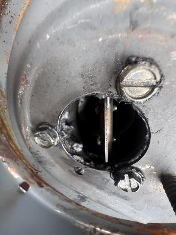

Chav88 39 #8 Posted April 2 Well we have moved into the new property and put the wheelhorse to work. For doing nothing but checking the fluids it was doing pretty good. It had something goofy going on with the idle speed and the choke. But it was running and I had work to do so I let it be for a day or two and it ended up not starting. Simple fix. They had used way too much RTV under the air cleaner which obstructed choke movement which caused it to slip the cable loose which caused it to be stuck “closed ish”. Once again I have a lot to get cleaned up on the new property to get it halfway functional so my fix was a quick temp fix. I used grease to seal the air cleaner and used electrical tape to add a little grip to the cable. I also adjusted the idle and she runs like a top now. 2 Share this post Link to post Share on other sites

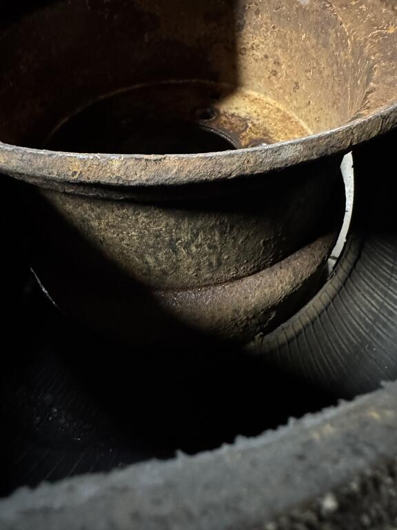

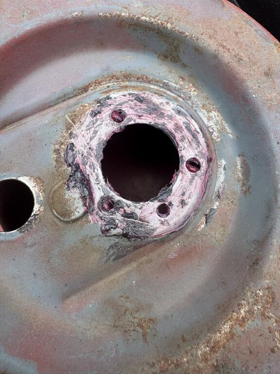

Chav88 39 #9 Posted April 2 And then we found ourselves with tire. The previous owners of the property had piles of construction wood and pallets all over the yard for reasons that are unknown. We’ve been cleaning it up and I ran over something pokey. Had to toss a new tube in and realized just how bad the tires are so hopefully these can get me through the summer and I can sandblast the rims and source a pair of back up rims so I can run ag tires on one set and some turf tires on the other. My workshop is in total disarray from moving so I’m sort of limited in what I can do right now. One of the things I realizing is cat 0 attachments are sort of far and few between. I’m going to have to fabricate something so I can skid logs and I also would like to incorporate a receiver so I can fabricate a better trailer too. For now I’m getting by. If anyone has some leads on a spare set of wheels I’d appreciate it. Even if they have the same 6 lug pattern but maybe a different size that I can make work. 1 Share this post Link to post Share on other sites
ineedanother 2,015 #10 Posted April 2 9 hours ago, Chav88 said: Well we have moved into the new property and put the wheelhorse to work. For doing nothing but checking the fluids it was doing pretty good. It had something goofy going on with the idle speed and the choke. But it was running and I had work to do so I let it be for a day or two and it ended up not starting. Simple fix. They had used way too much RTV under the air cleaner which obstructed choke movement which caused it to slip the cable loose which caused it to be stuck “closed ish”. Once again I have a lot to get cleaned up on the new property to get it halfway functional so my fix was a quick temp fix. I used grease to seal the air cleaner and used electrical tape to add a little grip to the cable. I also adjusted the idle and she runs like a top now. RTV really isn't a good choice to use there and I guess you agree at this point. A quick replacement with some gasket paper or something would be more than adequate. I've seen (and maybe have used ) 3x5 cards or a tablet back in a pinch when it's not in a critical spot but I always have gasket paper and hole punches in the shop. 1 1 Share this post Link to post Share on other sites

Chav88 39 #12 Posted April 5 On 4/2/2026 at 6:37 PM, ineedanother said: RTV really isn't a good choice to use there and I guess you agree at this point. A quick replacement with some gasket paper or something would be more than adequate. I've seen (and maybe have used ) 3x5 cards or a tablet back in a pinch when it's not in a critical spot but I always have gasket paper and hole punches in the shop. Yeah I like to keep some around too for special occasions. Soda boxes work pretty well too. I knew the grease would get me by until I have my shop sorted. Share this post Link to post Share on other sites

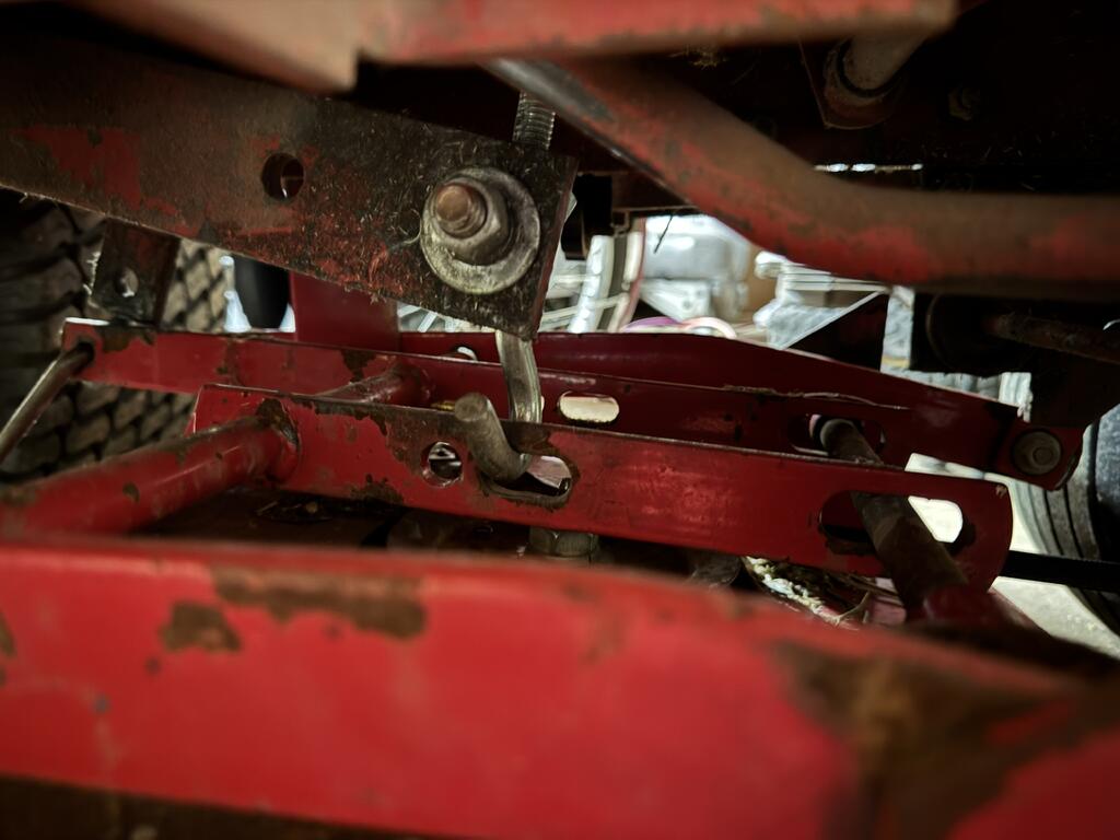

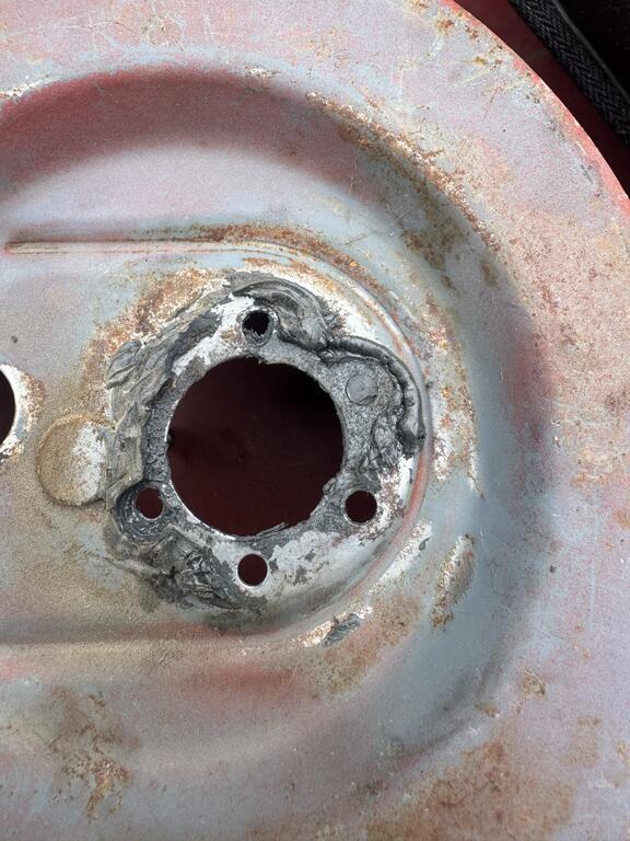

Chav88 39 #15 Posted April 10 Well the fun continues. First we had another flat tire due to the tire have a bad bead and poking a hole in the new tube. So today I got 2 brand new tires and tubes, cleaned the inside of the wheels up with a a wire wheel and solved that issue for now. I also got the new belts and mower deck installed. I sort of rigged it for now. Like I said all I have is my 120 arc welder and limited tools u til I get my shop setup but the grass isn’t waiting. So I sort of patched the shrouds up and this is when I realized I didn’t have a lift rod for the deck. So I used what I had to bandaid that problem. I’m going to have to either may something proper or find an actual part for it. My belt for the drive seems too long. I used the OEM but the adjustment has to be all the out for it to work and that push’s the deck so far back that sometimes it hits the rear wheel. Cant imagine if it has the oem 27” tires on it. But it was mowing pretty good otherwise until the mower died. I hopped off and check under the hood and seen nothing. Standing to the side I started it and it started right up. Hopped back on and hit the pto and as soon as I din that it died. I assumed it was the seat switch and it was. So I need to find a replacement for that but for now it’s bypassed. 2 Share this post Link to post Share on other sites

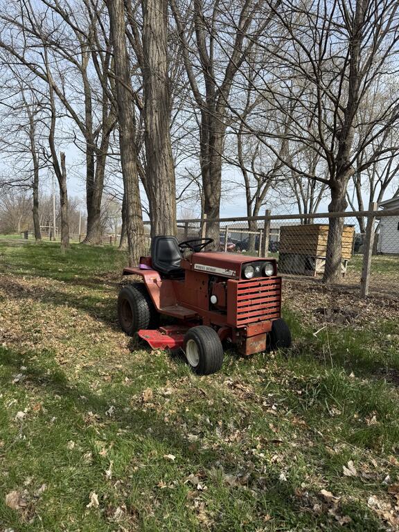

Chav88 39 #18 Posted April 11 But she is still putting in work, previous owners were bigger hippies than I. They tried to let the entire yard grow into a prairie but didn’t really understand what they were doing. They ordered to also throw scrap wood in piles so now I have overgrown mess hiding land mines all over. I’m currently doing a full pass with the deck up to take top off and then slowly going back with the deck set at max height. As long as I go slow it’s doing okay but once this belt stretches a bit I’m sure it’ll be an issue. 3 Share this post Link to post Share on other sites

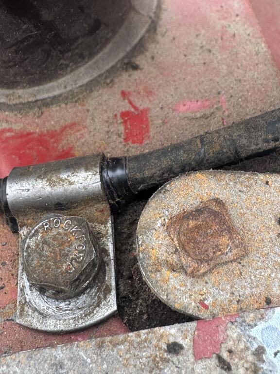

Chav88 39 #19 Posted April 12 Last night after getting the entire lawn mowed twice and several interactions with land mines we shut her off and took a break to tend to the burn barrel that’s been burning for 3 weeks to get rid of the trash wood scattered all over the property. When I came back….no start. Battery was dead. What’s odd is I confirmed it was charging shortly after buying it and the ammeter shows it’s charging and increases as you add lights or clutch. But the only thing I can think of is that I was using the clutch for so long that it put another draw on the battery and I didn’t let it charge up after shitting it off. Not that it’s correct but it’s something to keep an eye on 1 Share this post Link to post Share on other sites
