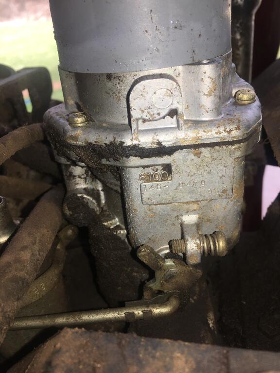

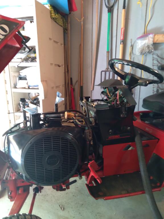

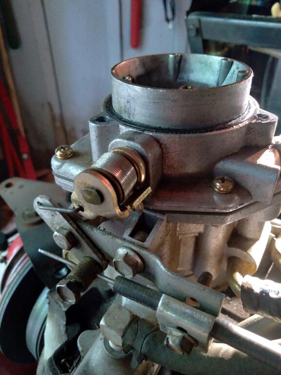

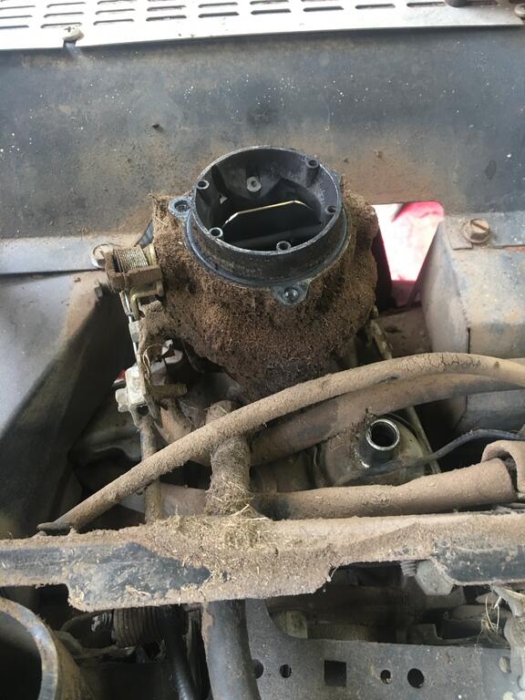

sqrlgtr 3,930 #1 Posted March 5 Finally got a chance to look at the 520H I brought home a week or so ago. Took breather off and safe to say PO probably hadn’t done to much preventative matainence. Taped throat up on carb and got rid of the big chuncks. Threw battery on and fired right up but has to have just a hint of choke on to not have a surge. All gauges and idiot lights seem to work but voltmeter shows just a little under 12 volts and when you unhook ground on battery it dies? Thought I would try some B12 in fuel before getting to serious on carb rebuild, might get lucky might but doubt it. Did drive around for a little while and man does that twin flat head hum no smoke knocks or weird nosies and has plenty of power. Trans seems good and stout but wants to creep backwards. 6 2 Share this post Link to post Share on other sites
ebinmaine 80,695 #2 Posted March 5 11 minutes ago, sqrlgtr said: carb rebuild I've done one of these for @JCM Pretty straightforward. I did not remove the carb or reinstall though. I believe there's a procedure for the intake manifold. 13 minutes ago, sqrlgtr said: wants to creep backwards. Hopefully just an adjustment. 13 minutes ago, sqrlgtr said: Did drive around for a little while and man does that twin flat head hum no smoke knocks or weird nosies and has plenty of power. Trans seems good and stout Excellent! 1 Share this post Link to post Share on other sites

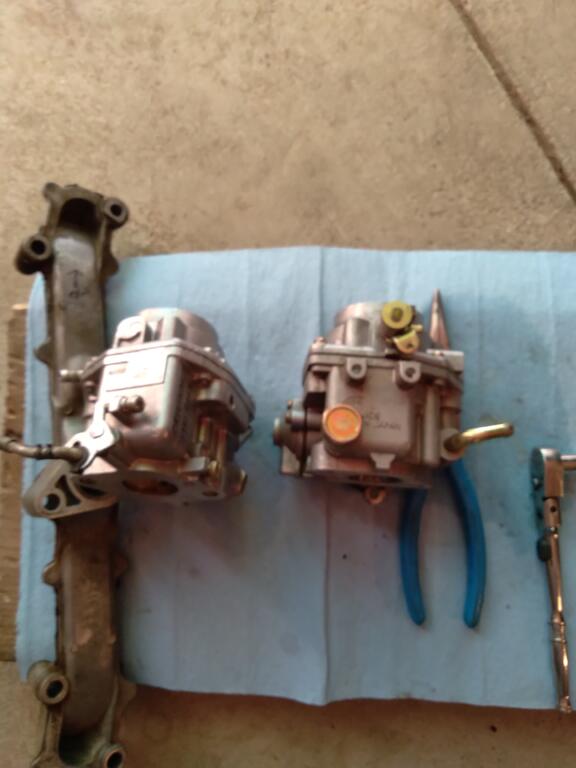

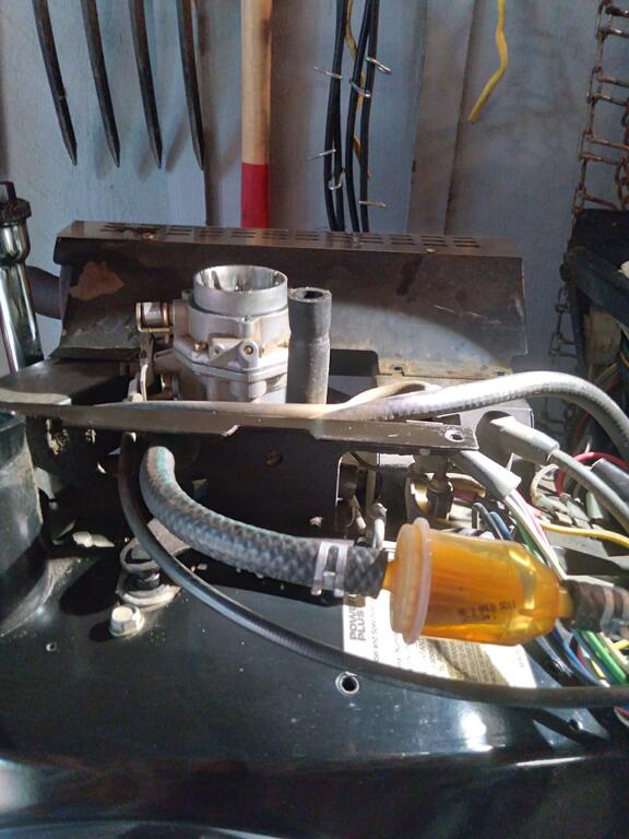

JCM 11,415 #4 Posted March 5 A few pics for you. The 520's seem to be the most abused of ALL WH tractors out there. Why. I have no idea. Keep at it, you will get there. 3 2 Share this post Link to post Share on other sites

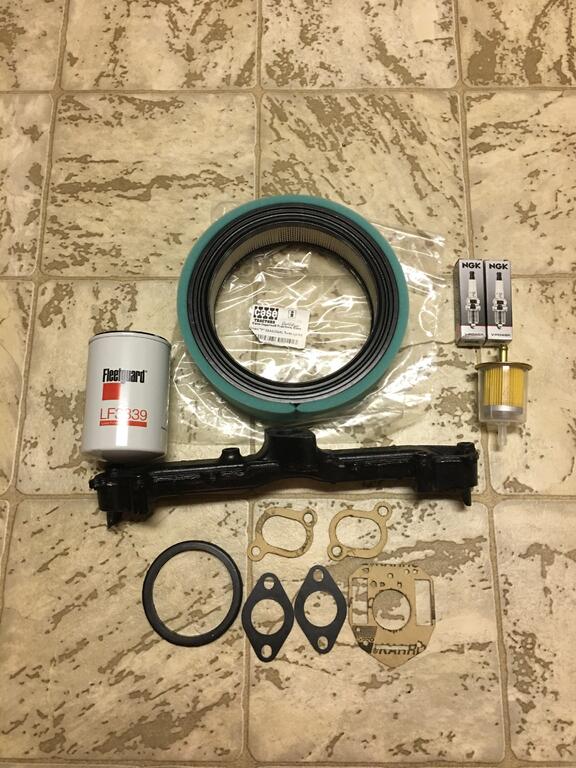

sqrlgtr 3,930 #8 Posted March 5 26 minutes ago, lynnmor said: How many hours are on the tractor? A little over a 1000 and supposed to be correct??? 28 minutes ago, lynnmor said: Let us know if you want to do a proper valve adjustment and carburetor cleaning and we can outline the needed work. Yeah main objective today was just run it around a bit just to see what I did have, believe everything is pretty solid and she just needs a little TLC. Ordered carb kit today and plan was to take top off carb and clean up best I could but agree valve adjustment wouldn't be a bad idea. What gaskets and stuff would I need to have on hand before I tackled a valve adjustment? I was also surprised at the ground speed it had. Seems a lot faster than a 6/8 speed tractor to me. Hydraulics seems real stout also. From the looks of the turf on that carb, I can't imagine what the cooling fins looks like . 2 Share this post Link to post Share on other sites

lynnmor 9,040 #13 Posted March 6 14 hours ago, sqrlgtr said: A little over a 1000 and supposed to be correct??? Yeah main objective today was just run it around a bit just to see what I did have, believe everything is pretty solid and she just needs a little TLC. Ordered carb kit today and plan was to take top off carb and clean up best I could but agree valve adjustment wouldn't be a bad idea. What gaskets and stuff would I need to have on hand before I tackled a valve adjustment? I was also surprised at the ground speed it had. Seems a lot faster than a 6/8 speed tractor to me. Hydraulics seems real stout also. From the looks of the turf on that carb, I can't imagine what the cooling fins looks like . Sounds like you ordered a cheap Chinese carb kit, I would use only the bowl gasket and the rest may be junk. Before disassembly check the compression, if it is higher than normal pull the heads and decarbon, if too low you might want to refresh the valve and seat surfaces. If you pull the valves, replace the intake valve seals. Use only genuine Onan gaskets, I have had cheap intake gaskets turn to mush in a year. You will need intake, carb mount, exhaust and valve cover gaskets. Possibly need head gaskets, oil filter mount gasket and of course the oil filter grommet that the last owner tossed. The exhaust is expensive to replace, so glass bead it and paint with Rustoleum High Temperature spray paint. The valve covers often rust so paint them with engine paint. I use satin black engine paint on heat shields and all other engine tins. The intake manifold needs to be checked for leaks and if that needs repaired check back. You can test by clamping a plate with gasket over the carb mount area and fill the manifold with diesel fuel. Look for notches worn in the edges of the manifold where the heat shields might have been contacting, correct by grinding some clearance in the shields. You will need a 1/4" and 3/8" drive torque wrenches. All bolts should have a drop of engine oil on the threads, do not over-tighten any of them. Download the Operators Manual and the Onan Service Manual. 1 2 Share this post Link to post Share on other sites
Brockport Bill 2,478 #14 Posted March 6 Had a surging onan 20, did carb rebuild and manifold gasket which solved the surging. 2 Share this post Link to post Share on other sites
kpinnc 18,960 #15 Posted March 6 2 hours ago, Brockport Bill said: Had a surging onan 20, did carb rebuild and manifold gasket which solved the surging. Rebuilt a carb for the same, no change on two different Onans. But a tiny bead of silicone on the intake manifold seam cleared up all of the surging. 1 Share this post Link to post Share on other sites

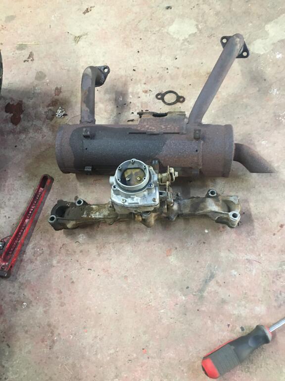

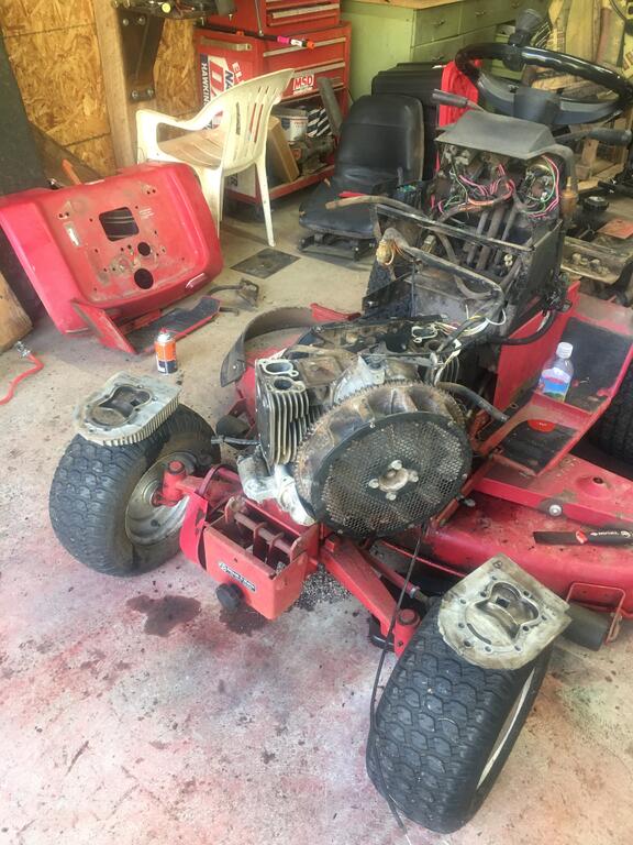

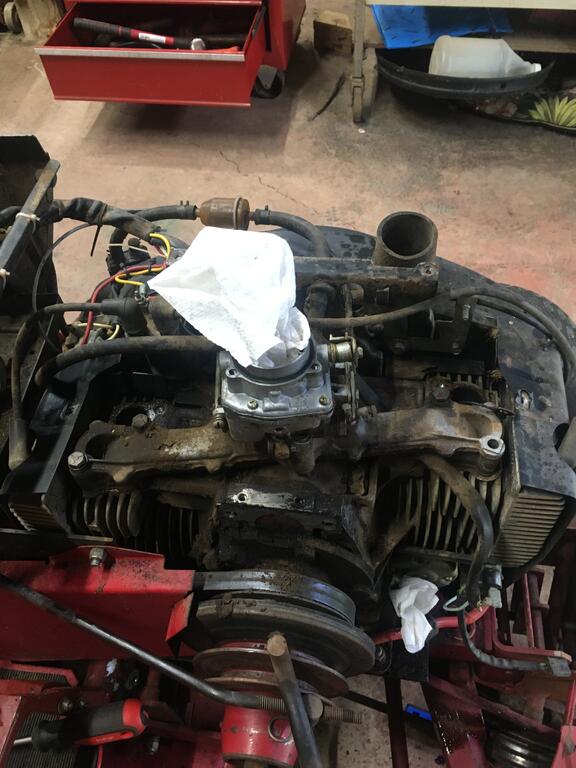

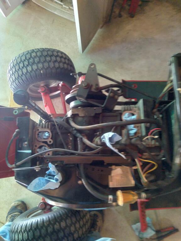

sqrlgtr 3,930 #16 Posted March 18 Got a good start on one of the 520’s today. I was kinda dreading the exhaust but no broke bolts . Im pretty sure intake manifold was loose on rear cylinder, bolts were loose but I may have broke them loose and just forgot? Actually had more trouble with unplugging lights to remove hood than anything. Probably be a shame not to go ahead and decarb heads and adjust valves while its tore down this far. I assume you can get to rear cylinder without removing motor? 3 1 Share this post Link to post Share on other sites
Handy Don 17,474 #17 Posted March 19 5 hours ago, sqrlgtr said: I assume you can get to rear cylinder without removing motor? Good question. I’ve only done this (to a P218) with the engine off the tractor. 1 Share this post Link to post Share on other sites
Ed Kennell 47,323 #18 Posted March 19 5 hours ago, sqrlgtr said: Got a good start on one of the 520’s today. I was kinda dreading the exhaust but no broke bolts 5 hours ago, sqrlgtr said: I assume you can get to rear cylinder without removing motor? I managed to decarbon mine with the p220 in place. 1 1 Share this post Link to post Share on other sites

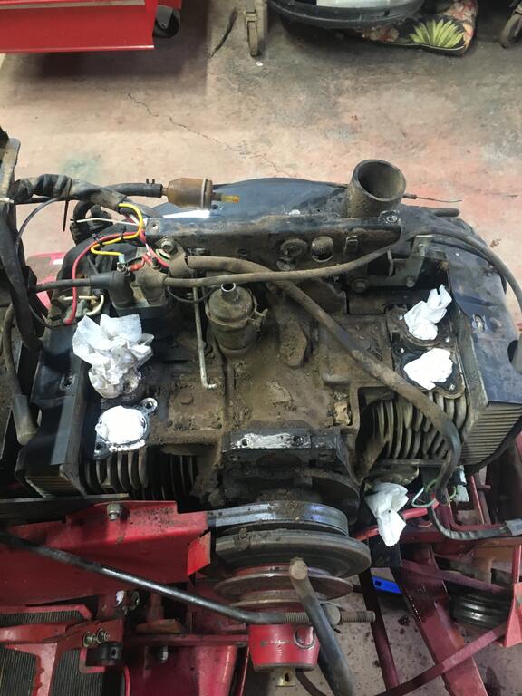

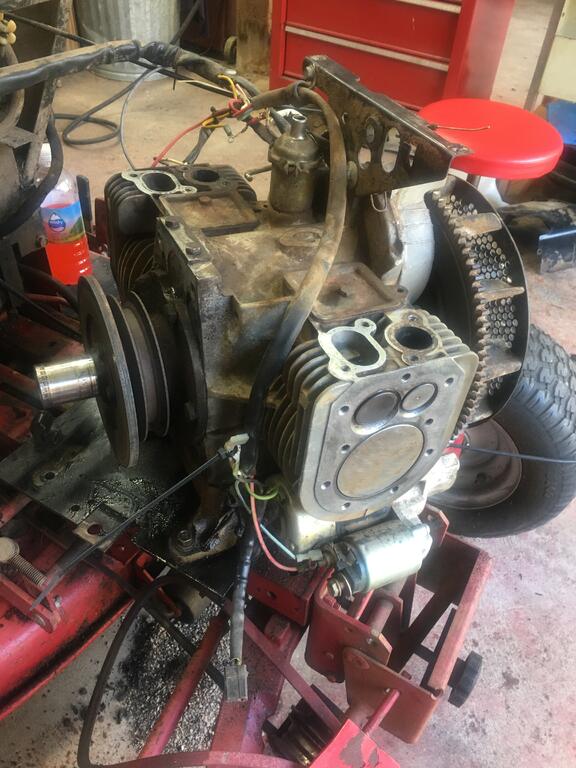

sqrlgtr 3,930 #19 Posted March 20 Got heads off and decarboned heads and combustion chambers/pistons. I found it a lot easier to work on by removing 3 of the motor mount bolts and turning motor for access to rear cylinder. Good thing I did because oil drain pipe is loose and I’m going to have to take apart and seal/ tighten it up. Between oil drain and loose oil filter it was pretty oily down there. Top of engine was good and dry . The old valve cover gaskets were stuck pretty good to block. I did start to adjust valves but my feeler gauge was at home so had to quit for for the day. Haven’t even got started on carb and intake manifold but exhaust should be good for another 30yrs after good coat of paint. Quick question, do any of y’all use any kind of sealer on valve cover gasket’s. 3 5 Share this post Link to post Share on other sites
ebinmaine 80,695 #20 Posted March 21 13 hours ago, sqrlgtr said: do any of y’all use any kind of sealer on valve cover gasket’s. I've never messed with Onan stuff. I have used sealer on other brands. Thin even coat. 1 Share this post Link to post Share on other sites
WHX?? 58,125 #21 Posted March 21 14 hours ago, sqrlgtr said: oil drain pipe is loose That is pretty common on these. Check for cracks in the threads use good quality pipe tape and don't overtighten. 1 Share this post Link to post Share on other sites
lynnmor 9,040 #22 Posted March 21 16 hours ago, sqrlgtr said: Got heads off and decarboned heads and combustion chambers/pistons. I found it a lot easier to work on by removing 3 of the motor mount bolts and turning motor for access to rear cylinder. Good thing I did because oil drain pipe is loose and I’m going to have to take apart and seal/ tighten it up. Between oil drain and loose oil filter it was pretty oily down there. Top of engine was good and dry . The old valve cover gaskets were stuck pretty good to block. I did start to adjust valves but my feeler gauge was at home so had to quit for for the day. Haven’t even got started on carb and intake manifold but exhaust should be good for another 30yrs after good coat of paint. Quick question, do any of y’all use any kind of sealer on valve cover gasket’s. I use this: 2 Share this post Link to post Share on other sites
lynnmor 9,040 #23 Posted March 21 To fix the oil drain pipes, I run a tap in till it begins to cut new threads, then I use a new pipe nipple so the threads aren't worn. I use red threadlocker after cleaning the thread thoroughly. 3 1 Share this post Link to post Share on other sites
