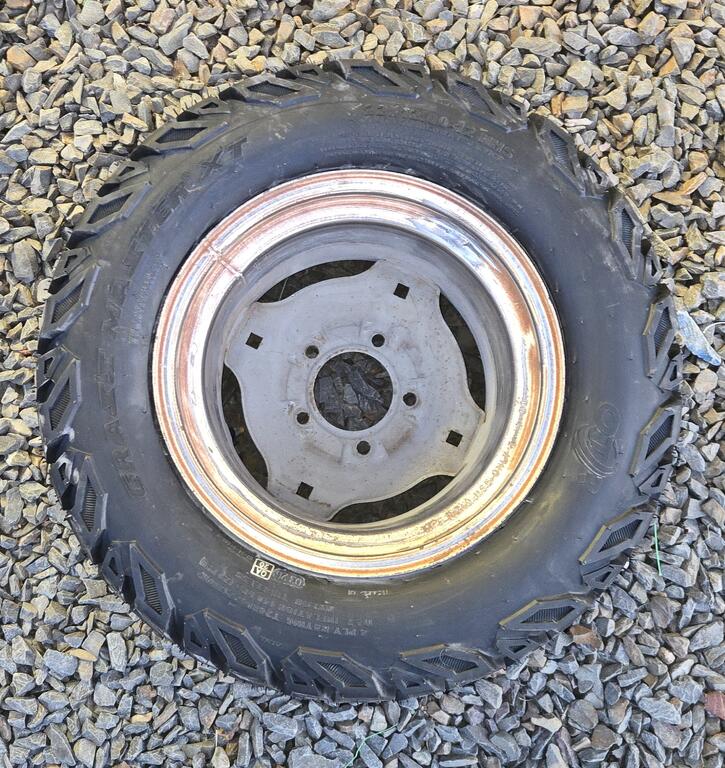

kpinnc 18,721 #26 Posted April 4 Not much- But finally got time to get the second front wheel done today. Gonna be a meaty front end on this tractor! 1 6 1 Share this post Link to post Share on other sites

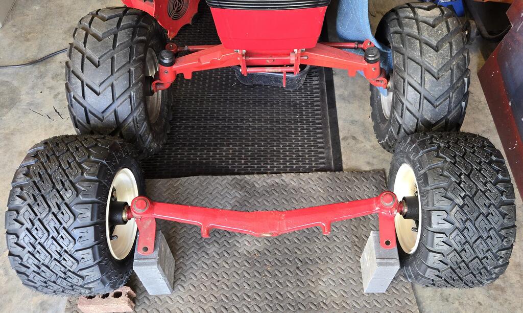

kpinnc 18,721 #27 Posted April 4 Just for giggles I set the axle assembly in front of the 523H. Surprised to see this is about two inches wider than the swept axle with 8 inch front wheels and trailer hubs on it. Definitely gonna have a wide track. I was going for that, but didn't realize it was this wide... 4 5 1 Share this post Link to post Share on other sites

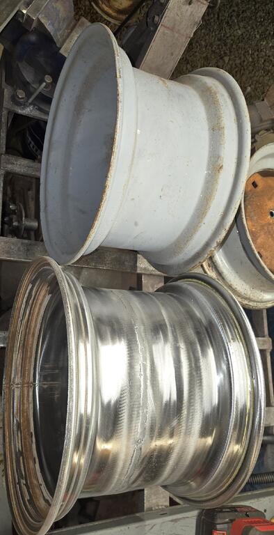

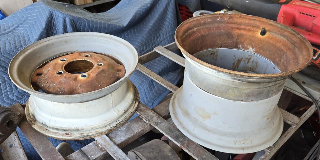

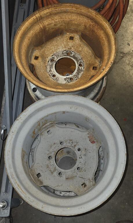

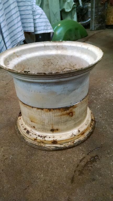

kpinnc 18,721 #28 Posted April 21 Got my donor wheels together for the rear. I don't have any more wide rears so I'm gonna have to make a set from two different pairs. The pair with the surface rust has a way wrong offset. They came from a Ford LGT. The tires on Ford pair would not break loose at the bead, even though they were clean. I had to use a 3 foot 2x6 and the weight of the Tundra to break them. Hopefully I can gain another skinny pair of wheels using these as well. We will see... 5 1 Share this post Link to post Share on other sites
AlexR 3,056 #29 Posted April 21 8 hours ago, kpinnc said: Got my donor wheels together for the rear. I don't have any more wide rears so I'm gonna have to make a set from two different pairs. How hard is it to do this? It doesn't seem like it would be easy to cut right, and that is a lot of welding too. 3 Share this post Link to post Share on other sites
kpinnc 18,721 #30 Posted April 21 9 hours ago, AlexR said: How hard is it to do this? It doesn't seem like it would be easy to cut right, and that is a lot of welding too. I'm about to find out. Never done it before, but I have a plan... 3 3 Share this post Link to post Share on other sites
AlexR 3,056 #31 Posted April 21 3 hours ago, kpinnc said: I'm about to find out. Never done it before, but I have a plan... Sounds like we are going to get a How-to haha 4 Share this post Link to post Share on other sites

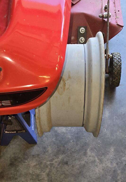

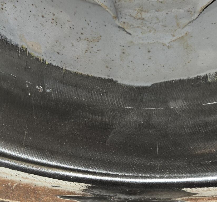

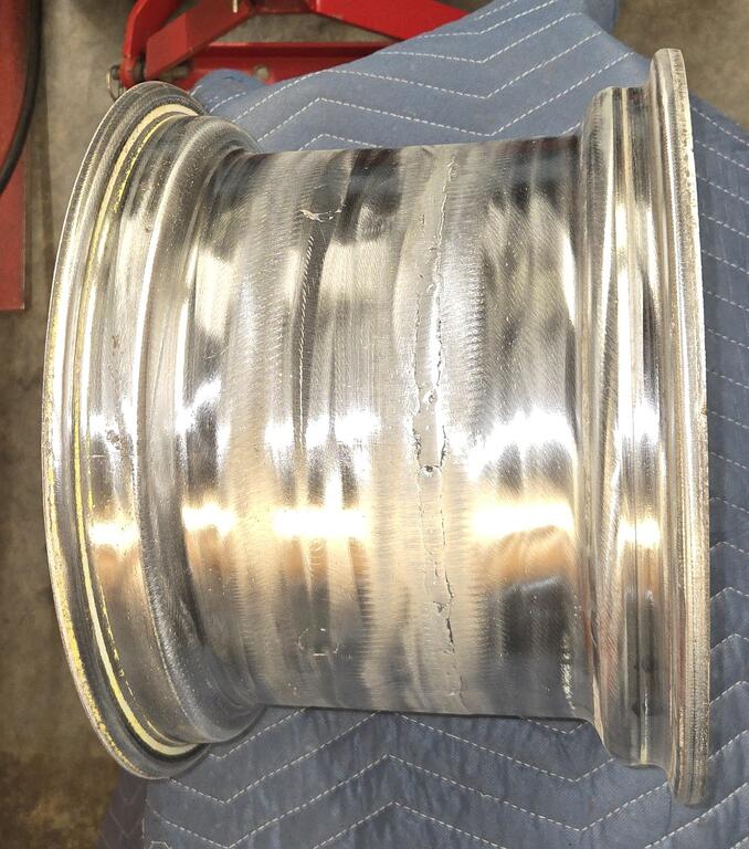

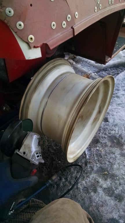

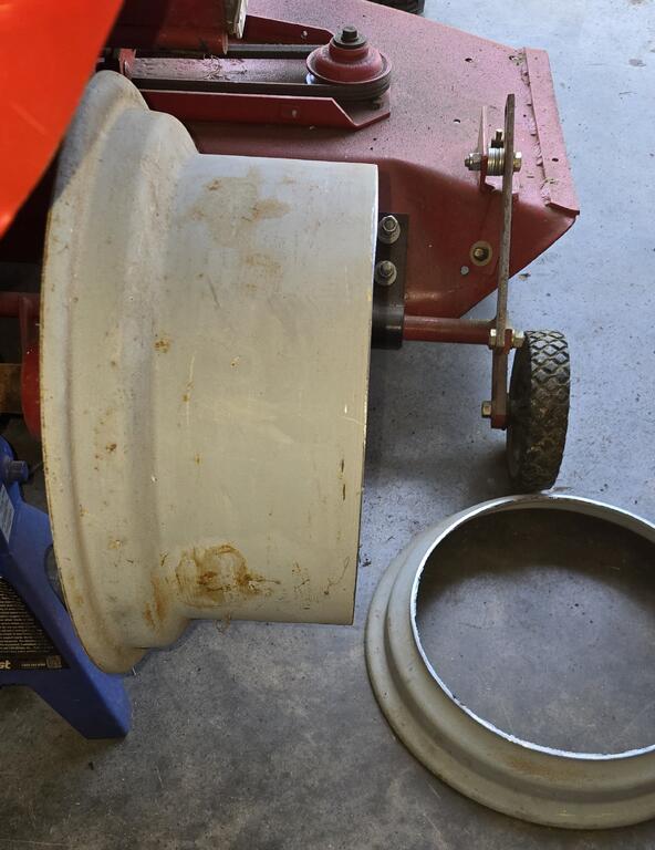

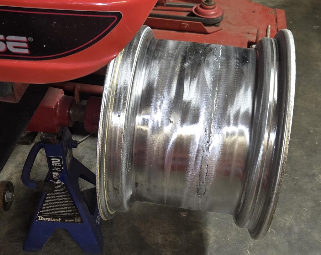

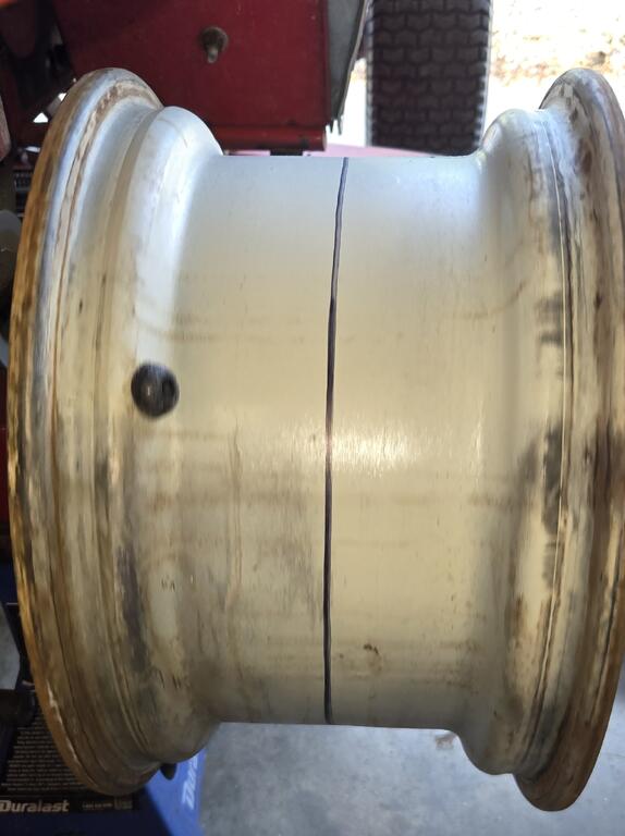

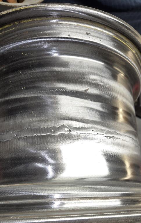

kpinnc 18,721 #32 Posted April 22 (edited) 4 hours ago, AlexR said: Sounds like we are going to get a How-to haha Well... maybe. Your mileage may vary. I tried for several days to figure out how to hold the wheels and rotate them so I could cut them straight. I started to build a jig to hold them, but then realized that was against hillbilly rule #7: Use what you have on hand. So I put a tractor on jack stands and removed a Wheel. Then mounted the bare rim and used a sharpie to mark the cut line all the way around. Sat on a 5 gallon bucket and lightly cut into the wheel on the lines until it cut all the way. It gets a little sketchy when the cutting wheel first breaks through. You have to turn the grinder to rotate the same direction as the wheel is turning so it doesn't grab. Ask me how I know... Holding the two halves together to get the welding started was interesting. Grinding deep "V" shapes in the backside to fill didn't help. Angle iron around inside or out didn't work. I used a couple big magnets to tack the first joint, and welding clamps two inches at a time until all the way around. But it turned out great. Rim is 9 inches wide bead to bead and the bonus is that the extra parts make up a nice set of 6 inch wheels, so nothing is wasted. Wheel has no wobble after everything was finished. Plenty good enough for a slow garden tractor. Took all evening to do one wheel. Learned a few tricks so the second one should go much faster. Edited April 22 by kpinnc 4 8 4 Share this post Link to post Share on other sites
Pullstart 70,428 #33 Posted April 22 @Achto did similar. Anything to add Dan? Awesome work, Kevin! 6 1 Share this post Link to post Share on other sites
ebinmaine 79,498 #34 Posted April 22 6 hours ago, kpinnc said: Use what you have One of our favorite sayings around here! 5 minutes ago, Pullstart said: Awesome work, Kevin! I agree with Kevin Kevin! Niiiiice! 3 3 Share this post Link to post Share on other sites
sqrlgtr 3,165 #35 Posted April 22 @kpinnc what type of grinder did you use? Been wanting to try this myself. I have a couple extra sets of wheels and like you mentioned it's hard to find the wide rears with the right Wheel horse off set. 3 Share this post Link to post Share on other sites
Pullstart 70,428 #36 Posted April 22 I’d assume a death wheel (thin style) would be much better than a heavy grinding wheel. 4 Share this post Link to post Share on other sites
Achto 32,035 #37 Posted April 22 Great job Kevin !! I had some waste when I built mine. Spun the rims on my C-145 lathe. My finished width was 11.5" 1 10 Share this post Link to post Share on other sites
kpinnc 18,721 #38 Posted April 22 4 hours ago, sqrlgtr said: what type of grinder did you use? Been wanting to try this myself. I have a couple extra sets of wheels and like you mentioned it's hard to find the wide rears with the right Wheel horse off set. Just a corded 4 inch grinder. Took two cutoff wheels to get through a wheel. 3 hours ago, Achto said: Great job Kevin !! I had some waste when I built mine. Spun the rims on my C-145 lathe. My finished width was 11.5" Thank you! I really wanted mine a bit wider but the dish location on one pair of wheels dictated where I cut them. If I had another pair of WH wheels the width would be at least 10.5. 3 hours ago, Pullstart said: I’d assume a death wheel (thin style) would be much better than a heavy grinding wheel. Absolutely. And this goes through the cut off wheels pretty quick. 2 2 1 Share this post Link to post Share on other sites
Achto 32,035 #39 Posted April 22 42 minutes ago, kpinnc said: really wanted mine a bit wider but the dish location on one pair of wheels dictated where I cut them. I had to cut the dish out of one set on mine to get the width that I wanted. 2 2 Share this post Link to post Share on other sites
ebinmaine 79,498 #40 Posted April 22 6 hours ago, Pullstart said: I’d assume a death wheel (thin style) would be much better than a heavy grinding wheel. USE PROPER SAFETY EQUIPMENT. I was on site when someone got into a fight with one of those wheels. DON'T! 3 Share this post Link to post Share on other sites
sqrlgtr 3,165 #41 Posted April 22 2 hours ago, ebinmaine said: USE PROPER SAFETY EQUIPMENT. I was on site when someone got into a fight with one of those wheels. DON'T! 1 1 Share this post Link to post Share on other sites
kpinnc 18,721 #42 Posted April 22 2 hours ago, ebinmaine said: I was on site when someone got into a fight with one of those wheels. Yes they can be very dangerous. That's another reason I'm using smaller wheels, and when you cut these rotating steel rims, you don't put alot of pressure into it. 3 Share this post Link to post Share on other sites

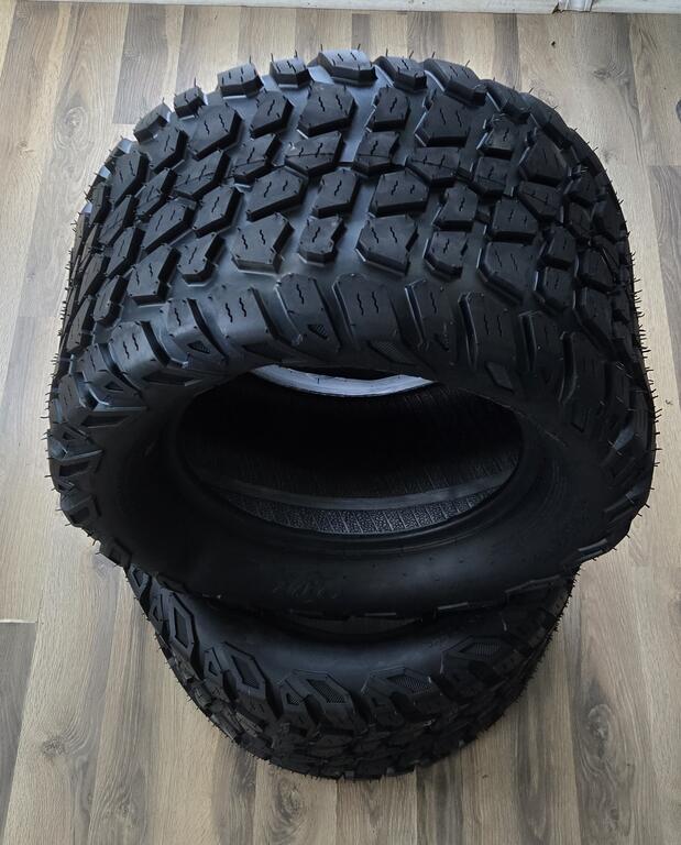

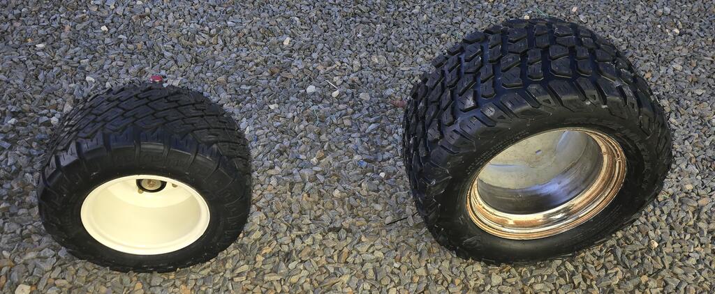

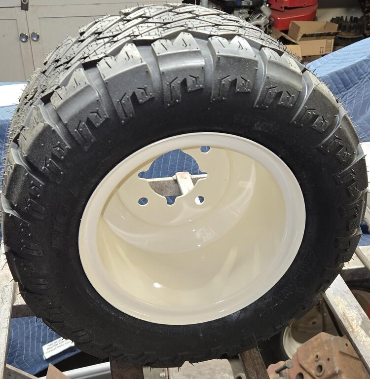

kpinnc 18,721 #43 Posted April 23 Got the rear tires today. The tire theme on this one is wide but not too tall. Fronts: 16x8.50-8 Rears: 22x12-12 7 Share this post Link to post Share on other sites
ebinmaine 79,498 #44 Posted April 23 Them oughtta bite ok. Looks like good strong cleats. Not like @cleats but like feet grippers. 3 Share this post Link to post Share on other sites
kpinnc 18,721 #45 Posted April 23 3 minutes ago, ebinmaine said: Them oughtta bite ok. Looks like good strong cleats. Not like @cleats but like feet grippers. All but one of my current tractors have cleat tires of some sort. These are much more aggressive than regular turfs, but not too extreme. I thought I'd try something different. 2 Share this post Link to post Share on other sites
ebinmaine 79,498 #46 Posted April 23 4 minutes ago, kpinnc said: All but one of my current tractors have cleat tires of some sort. These are much more aggressive than regular turfs, but not too extreme. I thought I'd try something different. It's a neat pattern. I've considered getting something less aggressive than the AGs we've been using but our rough terrain does demand top grade gription. To the best of my knowledge no tire is self cleaning like a forward facing AG in forward motion. 1 2 Share this post Link to post Share on other sites
kpinnc 18,721 #47 Posted April 23 1 hour ago, ebinmaine said: To the best of my knowledge no tire is self cleaning like a forward facing AG in forward motion. Agreed 100% 2 Share this post Link to post Share on other sites
sqrlgtr 3,165 #48 Posted April 23 I know a lot of guys/gals like to put "Ag's" on front steer tires but run them backwards and swear by them I just can't get it in my head how the don't stay full of dirt/mud, but I have never tried them that way so IDK. 2 Share this post Link to post Share on other sites
ebinmaine 79,498 #49 Posted April 23 3 minutes ago, sqrlgtr said: I know a lot of guys/gals like to put "Ag's" on front steer tires but run them backwards and swear by them I just can't get it in my head how the don't stay full of dirt/mud, but I have never tried them that way so IDK. I have. Trina and I have both tested this on our individual very different types of tractors. On her lighter smaller machines she sees no difference. On my bigger heavier rigs there's definitely a better steering capability when the tires are reversed.... but only only on dry ground. The tires don't stay full of mud then. 2 Share this post Link to post Share on other sites

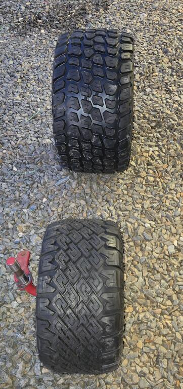

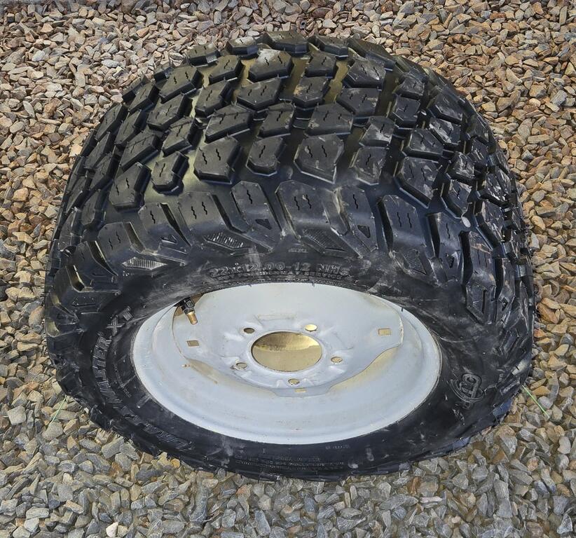

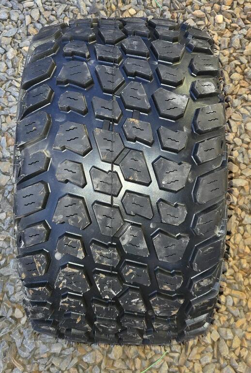

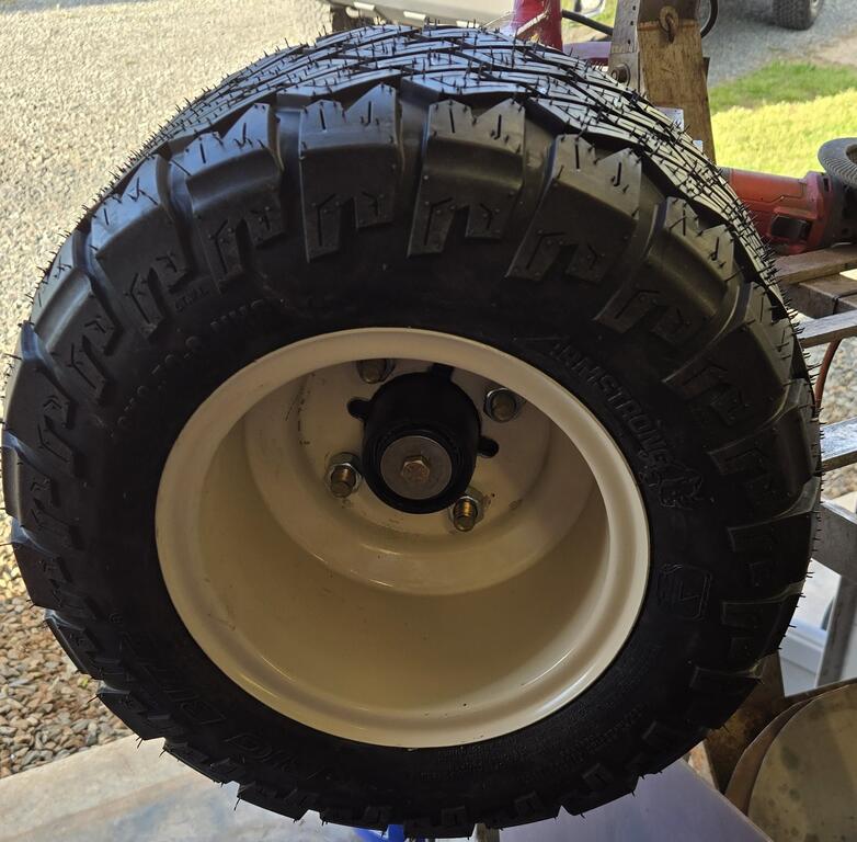

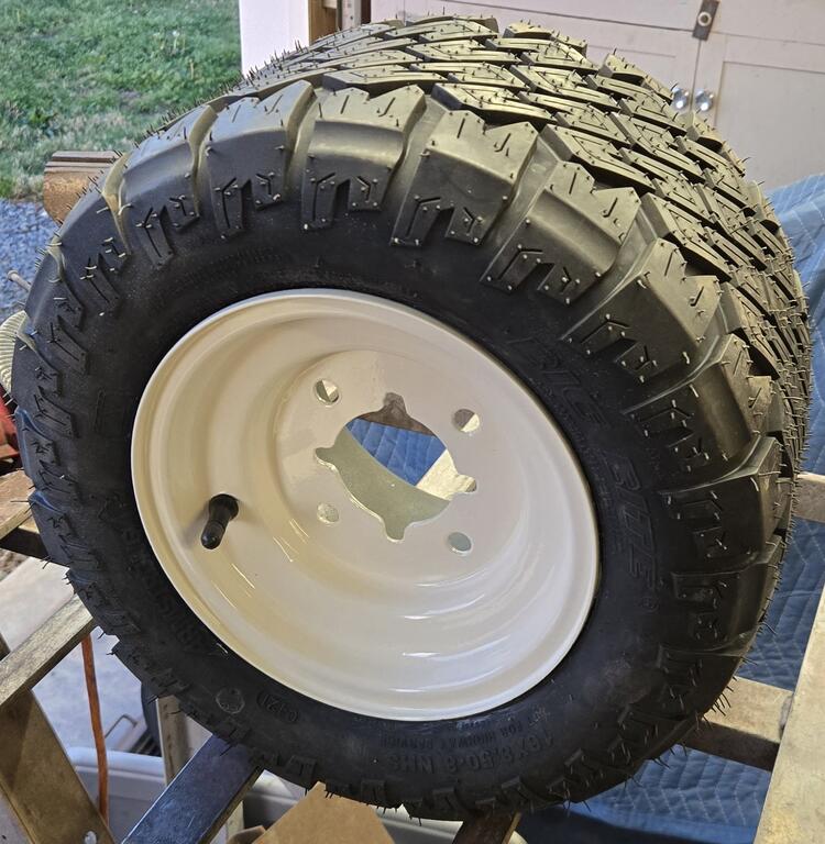

kpinnc 18,721 #50 Posted April 24 Mounted the first rear tire just for giggles. The inside of the wheel was primed and painted but still gotta finish the outside. These things are rather knobby! Used a tube just in case. And a boat load of talcum powder. If it pops there will be a white dust cloud. But it really makes the entire process of mounting the tire and tube so much better. Also there is a comparison of front and rear tire size in the last two pics. I really like this set of tires! 1 8 Share this post Link to post Share on other sites
