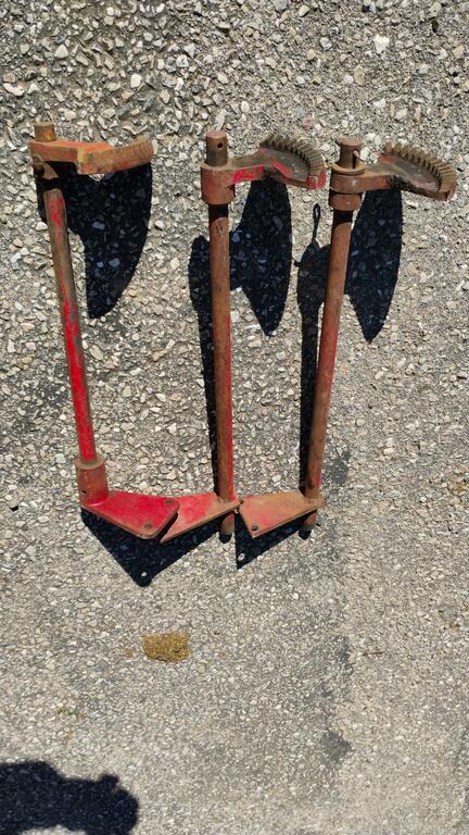

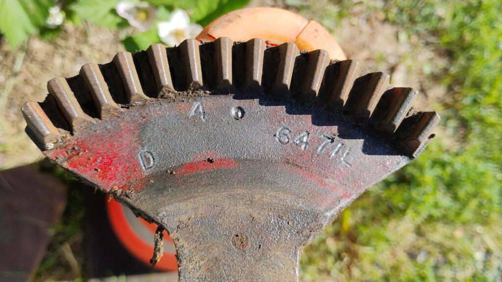

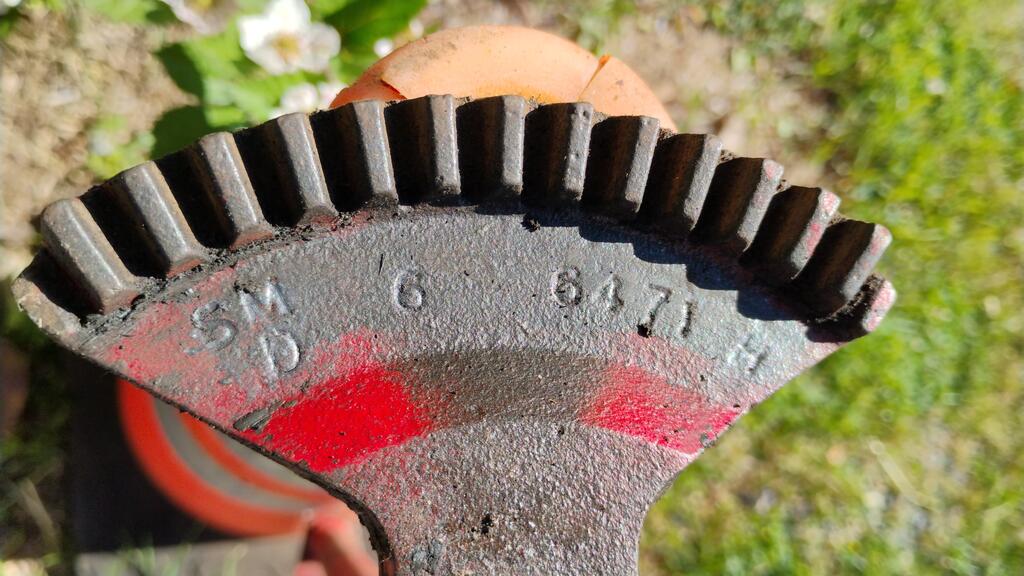

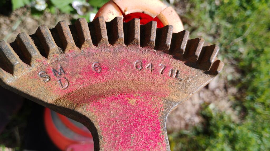

Blaine 276 #176 Posted June 1 (edited) 8 hours ago, Ed Kennell said: I'm not sure if they will fit, but there will be plenty of experts at the show that will know. Take some close up pics and some measurements to compare. I'll be there Thur-Sat. I may be coming to Dover before the show. My son lives near Pinchot Park. If I come your way, I'll get your address and bring them along. Thanks for making me take another look. It’s a 4413, not 3924. I was looking at the wrong thing in the parts diagrams. Apparently the 4413 fits some rangers, and probably other models as well. 13 full teeth and the number is just below them. The one in your bucket looks like a good possibility. Edited June 1 by Blaine Share this post Link to post Share on other sites

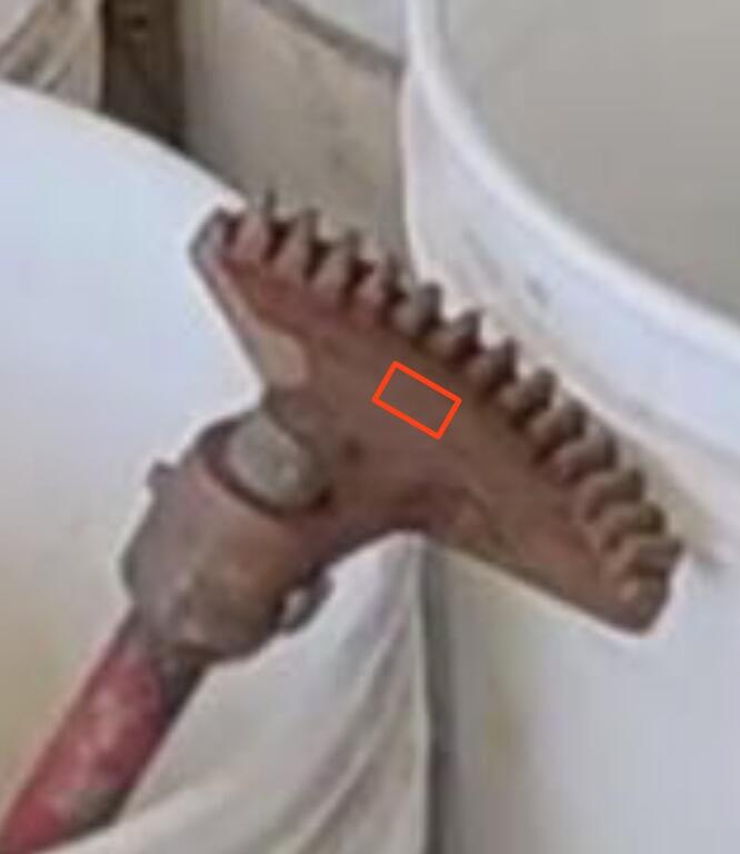

Ed Kennell 47,791 #180 Posted June 2 17 hours ago, Blaine said: It’s a 4413 Here are the three that I have. Share this post Link to post Share on other sites
702854boy 1,199 #181 Posted June 2 2 minutes ago, Ed Kennell said: If @Blaine doesn't need the one on the left, how much do you want for it? 1 Share this post Link to post Share on other sites

Ed Kennell 47,791 #186 Posted June 2 1 hour ago, 702854boy said: If @Blaine doesn't need the one on the left, how much do you want for it? $20 delivered to the Big Show. Oh, Red Square Supporters always get a 50% discount. = $10 2 2 1 Share this post Link to post Share on other sites

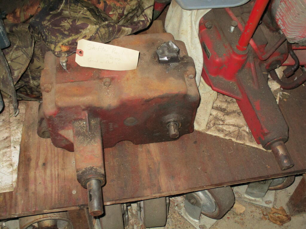

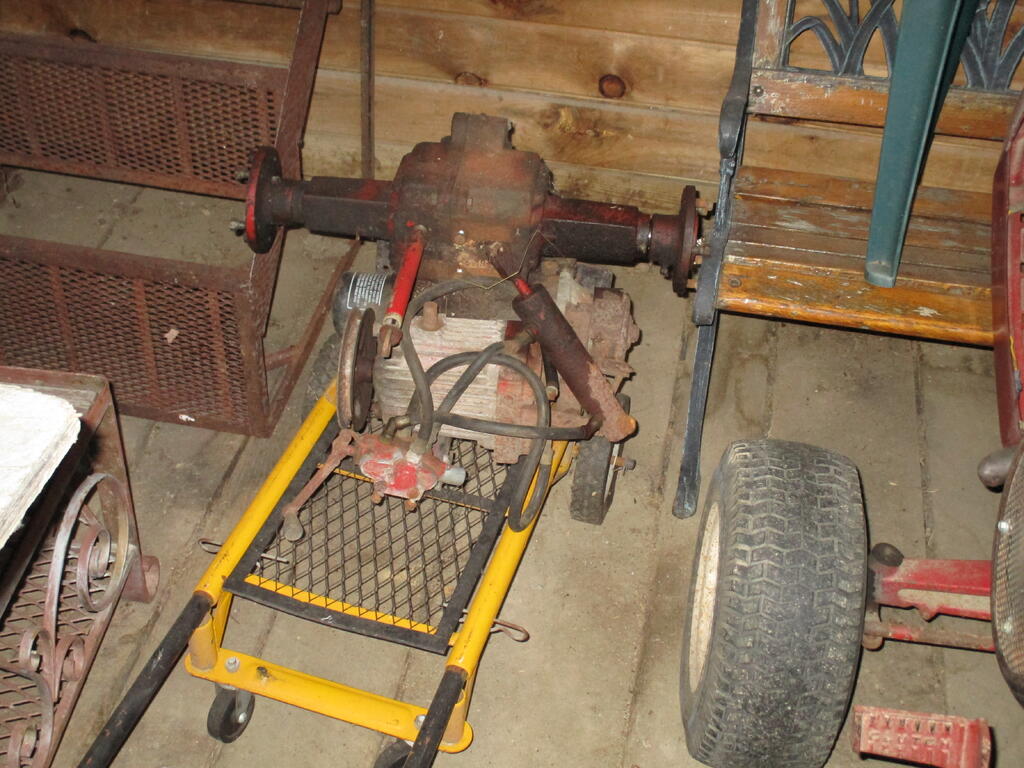

pfrederi 21,276 #195 Posted June 2 3 spd tranny 1" axle. Was working ok but pulled out of service because she would get stuck in two gears. Never got around to grinding a flats on the shift rails to fix it. $10 piston to piston sunstrand picked up years ago no idea of condition but it does have the hydro cylinder, control valve and implement relief valve $ 20 1 Share this post Link to post Share on other sites
squonk 48,303 #196 Posted June 2 Paul I'll take that 3 spd. Share this post Link to post Share on other sites

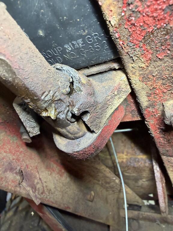

Blaine 276 #197 Posted June 3 (edited) 12 hours ago, Ed Kennell said: Here are the three that I have. I found this bulletin. It leaves the question “but what about the 6471?” I never lifted the 702 to see exactly what happened as i could see from the top side that it had obviously snapped. I just got done having a closer look at things. Apparently the 4413 was an issue. The bore area is only about an inch long, so it got loose on the shaft. Someone partially welded it to the shaft, then the pin eventually walked out only holding on one side and snapped the bore out. So it looks as though WH lengthened the bore area and increased the roll pin to 5/16”, then eventually welded the sector to the shaft as an assembly, (for models that use 2 tie rods) but no welded assembly for models that use a single tie rod, that i can find anyway. Being that my shaft is worn and torn up pretty bad, i may be able to use one of the welded ones, if the total shaft length is at least 17-3/4. My shaft is actually about 17-1/8”, but it only sticks through the sector maybe an inch, like the one to the left in of your picture. So if one of the welded ones are about 16” from the flat of the bore area on the toothed side of the sector to the other end of the shaft, i should be able to make it work. I’m assuming that the shaft on the right has what looks like a spacer/washer on top and it is not an extension of the sector casting. If it is part of the sector, i’ll take the one in the middle. If the two hole steering pivot falls at the right area, i could drill a hole between them where needed, if not i can remove it and use my single hole steering pivot. If the shaft isn’t long enough, i have some 3/4” i.d dom tubing to fix that too. Edit: Which one does NOT have the extra half teeth on the ends? I don’t know if they’re needed but mine has them. Edited June 3 by Blaine 3 Share this post Link to post Share on other sites
pfrederi 21,276 #198 Posted June 3 4 hours ago, squonk said: Paul I'll take that 3 spd. You got it. Share this post Link to post Share on other sites
adsm08 5,233 #199 Posted June 3 5 hours ago, pfrederi said: piston to piston sunstrand picked up years ago no idea of condition but it does have the hydro cylinder, control valve and implement relief valve $ 20 Not sure if I can use it for any of my projects, but for $20 I'll bite. Share this post Link to post Share on other sites
pfrederi 21,276 #200 Posted June 3 10 hours ago, adsm08 said: Not sure if I can use it for any of my projects, but for $20 I'll bite. Its yours Share this post Link to post Share on other sites
