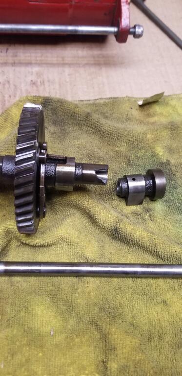

gt14rider 1,278 #7 Posted March 4 @WHX?? the tractor was running, had a tick and geting loader. Pulled apart and found this, chunk of cam missing, found it in the pan. 20260114_101853.mp4 4 Share this post Link to post Share on other sites
WHX?? 58,143 #8 Posted March 4 11 hours ago, gt14rider said: had a tick Ah I think you mentioned this before Rider. Here i was worried a rod snapped, holed the block and all that carnage. Odd that it broke must have been just a weak spot in the cam? Share this post Link to post Share on other sites
gt14rider 1,278 #9 Posted March 4 @WHX??Had another post (k181 ticking sound). Well I started peeling the onion, new rings,dingleberry hone,both valves, new valve spring,glasses the head and deck,new bearings, seals,and carburetor and fuel pump rebuild. Had crankshaft and block checked, .0015 tapper on crankshaft (in spec) .0025 in the middle of the bore ( should be ok new Kohler .020 over rings ). I got it apart might as well get it done. That's why I asked about the rotators, I would have to replace the springs if I use the rotators. Like @Achto said it ran 50+ Year why mess with it. 2 Share this post Link to post Share on other sites

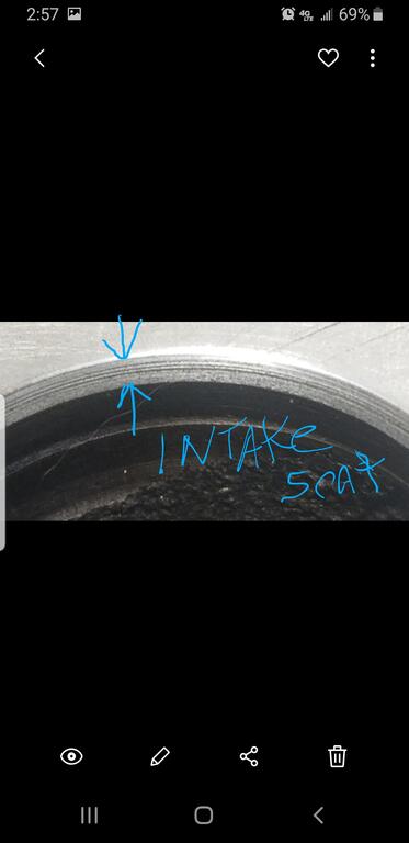

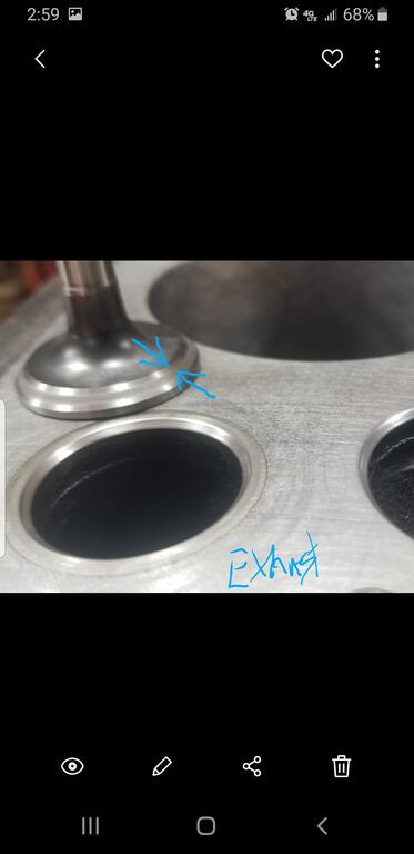

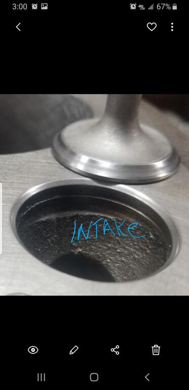

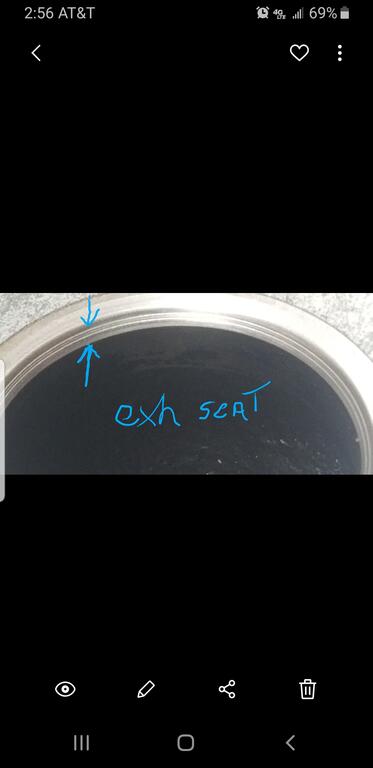

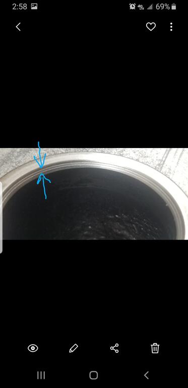

gt14rider 1,278 #12 Posted March 8 (edited) Good afternoon, been waiting for parts and clean up. Got new valves and lapping the valves. Question (see pics) take a look at valve and seat not pitted, they looks good from a foot away, but look close , they have rings on the seats. Valves seem to be centered on the seat. So do I keep lapping ? Thanks Edited March 8 by gt14rider Share this post Link to post Share on other sites
lynnmor 9,040 #13 Posted March 9 The service manual is available here. Here is the information on valve seats: It is best to grind the valve till it cleans up and then cut the valve seat to get the proper contact area. After doing that, lapping should be kept to a minimum. 1 Share this post Link to post Share on other sites
