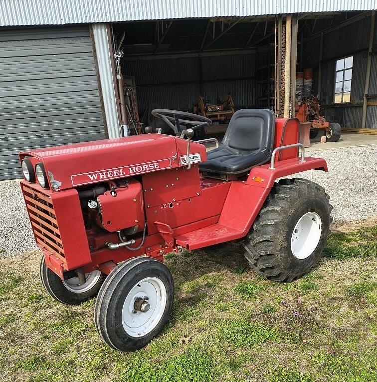

tractorhogg 656 #1 Posted March 2 Found a great deal on a nice D-200 and since my D-160's kohler single bit the dust. The two bolts that secure the steering column to the support bracket and are loose. I tried to get in there to tighten them, but my ratchet doesn't want to to turn the bolt enough to "catch" or the bolts maybe too short, but needless to say there's very little room. A long handle 1/4" or 3/8" drive ratchet might help. I wish I could get a air or battery powered ratchet on the bolts, not sure if there's room. I may have to remove the mid mount lift bracket to get in there, any other hints or ideas, does anyone know the size/length of the bolts? 3 Share this post Link to post Share on other sites

Sparky-(Admin) 25,847 #3 Posted March 3 Can you determine length and size 1 hour ago, tractorhogg said: Found a great deal on a nice D-200 and since my D-160's kohler single bit the dust. The two bolts that secure the steering column to the support bracket and are loose. I tried to get in there to tighten them, but my ratchet doesn't want to to turn the bolt enough to "catch" or the bolts maybe too short, but needless to say there's very little room. A long handle 1/4" or 3/8" drive ratchet might help. I wish I could get an air or battery powered ratchet on the bolts, not sure if there's room. I may have to remove the mid mount lift bracket to get in there, any other hints or ideas, does anyone know the size/length of the bolts? Can the size/ length be figured out on the motor less D series in the background? 1 1 Share this post Link to post Share on other sites
tractorhogg 656 #4 Posted March 3 39 minutes ago, Sparky said: Can you determine length and size Can the size/ length be figured out on the motor less D series in the background? I may try to remove the mid mount lift linkage, that way I can get to it and easily remove or attempt to tighten the bolts, It is possible someone used bolts to short when they restored it years ago. Thanks Share this post Link to post Share on other sites
oliver2-44 11,610 #5 Posted March 3 What is the loader tractor in the background/ 1 Share this post Link to post Share on other sites
tractorhogg 656 #6 Posted March 3 2 minutes ago, oliver2-44 said: What is the loader tractor in the background/ 1981 Kubota B7100 HST 4 X $ 2 1 Share this post Link to post Share on other sites
tractorhogg 656 #7 Posted March 4 I was able to get my hand/fingers and ratchet up above the mid lift and tighten the two bolts, all is well now. On a side note I got my front dozer blade cleaned, sanded, primed, and painted 1 2 Share this post Link to post Share on other sites
