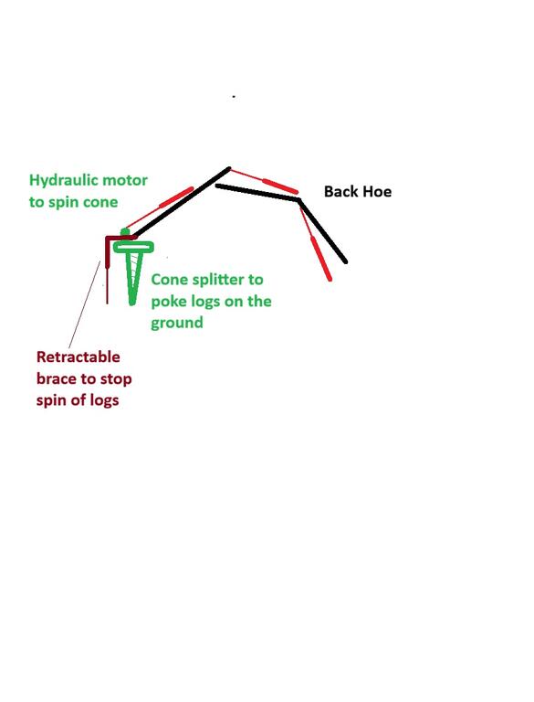

wallfish 19,752 #12 Posted February 28 I don't burn wood but still wanted to build a cone splitter for the hoe when it was mine. Basically just poke the logs right on the ground one right after another 3 Share this post Link to post Share on other sites
adsm08 4,360 #13 Posted February 28 I know I'm the young buck around here, but I don't see the lack of a vertical as a huge drawback. I find it easier to let the split pieces pile up around the splitter as I work in horizontal mode. I have the same splitter Ed does, and I've only used in vertical once, when I was working with 4ft diameter sections of oak. I'm not sure the dual action is going to be that useful. Like Don said, it will not be as strong in one direction, and I usually need the full retract time to reload. 2 Share this post Link to post Share on other sites
adsm08 4,360 #14 Posted February 28 3 minutes ago, wallfish said: cone splitter for the hoe I think they make those already. 1 Share this post Link to post Share on other sites
wallfish 19,752 #15 Posted February 28 8 minutes ago, adsm08 said: I think they make those already. They make back hoes too but that didn't stop me from building one. 1 7 Share this post Link to post Share on other sites
