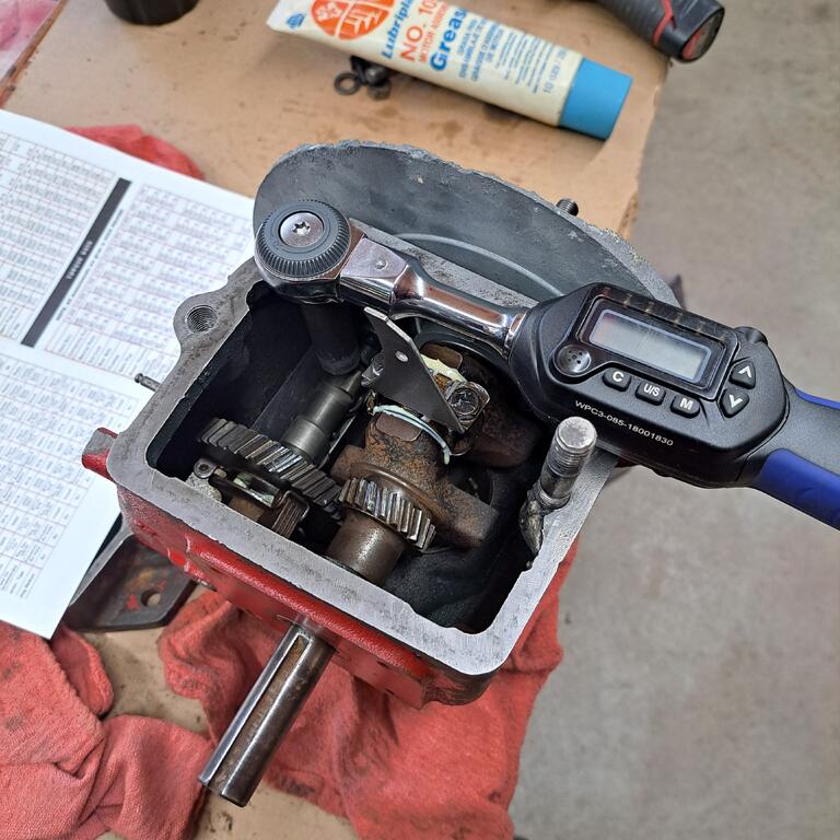

WHX?? 58,125 #1 Posted February 25 No relation to @19richie66 I'm sure but every time I use it I think of him. It was FREE from a wholesaler for selling mini split air conditioners. Thought what good is it with a stupid metric crescent wrench head in our line of work. Supposed to be used for torqueing flare nuts for proper install of aforementioned ACs. 'Till I found they offer a 3/8 ratchet head. Found in the jungle no less. Bad news it only goes to 60 ft lbs but still. Measures in inch lbs as well. Has a visual & tone when torque setting is reached. Very handy for rod caps on a Clinton. 8 2 1 Share this post Link to post Share on other sites

19richie66 17,935 #5 Posted February 25 Very handy indeed but I see nothing Ritchie on it. But if it makes you smile every time you use it, I’ll be there for you! I got ya brother! 3 Share this post Link to post Share on other sites
WHX?? 58,125 #6 Posted February 25 (edited) 19 hours ago, JoeM said: was hosed with JIC hoses and nuts. One issue was leaking due form over tightening hose ends on the flares Yep and I did use it for that on the FEL. Book said only 20 ft lbs on 3/8". Didn’t seem like much but book also said #1 leak JIC is over tighten. Watching Dan assemble a tractor and he used a torque wrench on every thing. He says most guys have a bad habit of over tightening everything. Guilty as charged. 15 hours ago, 19richie66 said: see nothing Ritchie on it. Forgot to mention Yellow Jacket is a Ritchie Engineering brand for their HVAC products. So don't get a big head... Edited February 26 by WHX?? 1 Share this post Link to post Share on other sites
