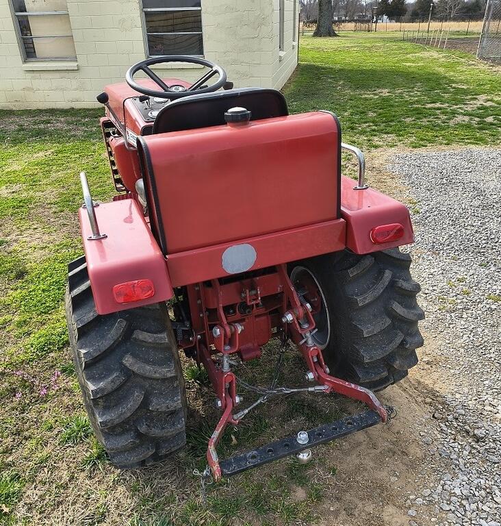

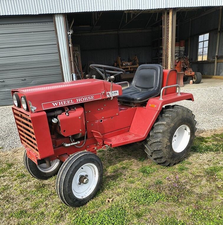

tractorhogg 667 #1 Posted February 24 My engine gave up the ghost, a trusted repair shop says the piston/rings are worn and the cylinder is out of taper and out of round. They also said the crankshaft, bearings, and oil seals need to be replaced, both ends have play in them. It will also need a new connecting rod, both valves, springs and valve guides. The repair shop doesn't think I should use aftermarket parts, but with labor and material I'm going to be well over 3k in this rebuild, that's not in my budget. I am open to buying a decent used K341a (spec 71141) or buying NOS parts from members or sellers here. I really hate to use a newer replacement engine, I wont ever buy a predator engine, but I'm open to a Honda, Briggs, Kohler 20-24 hp. I'd also be open to a kohler k482 or magnum 18-20 hp if they were in good shape. I really appreciate any input or idea Share this post Link to post Share on other sites

tractorhogg 667 #8 Posted March 1 On 2/24/2026 at 9:08 PM, kpinnc said: Which engine are you referring to? All the faults you describe are common to an engine that is just worn out. The price range you describe sounds a bit high, even if it is an Onan. 16 horse Kohler single, It ran good a month earlier, no smoke or no use of oil, plenty of power. I'm going to sell the tractor, I bought another one Share this post Link to post Share on other sites
tractorhogg 667 #9 Posted March 1 I've decide to sell the D-160 and let someone either repower it or put the engine back together. I'll list it locally and on the classifieds here. The shop said it was .003 out of round/taper, but it did not smoke or use oil. I've bought another D series for 2000.00, seemed the better deal 2 Share this post Link to post Share on other sites
