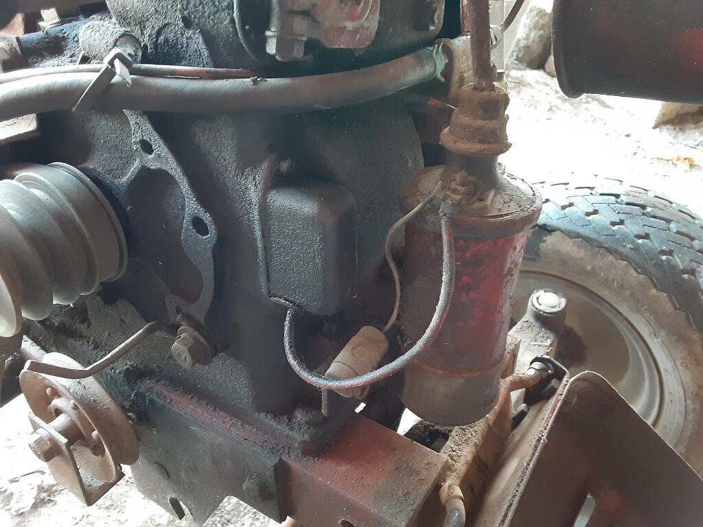

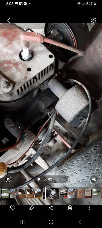

Jason Miller 24 #1 Posted February 17 Question, My 856 stopped running the wire on top of the spark plug is loose won’t stay on should snap or click on top of the spark plug buts original and wore out. Help where can I get one and what kind? Jason Share this post Link to post Share on other sites
WHX?? 58,388 #2 Posted February 17 Auto parts stores can make you one. Otherwise @squonk has them. 2 Share this post Link to post Share on other sites
ri702bill 13,392 #3 Posted February 17 (edited) I use the coil wire from a 1960's to 70's Ford Econoline 6 cylinder. Right length, fits well... Edited February 17 by ri702bill 2 Share this post Link to post Share on other sites

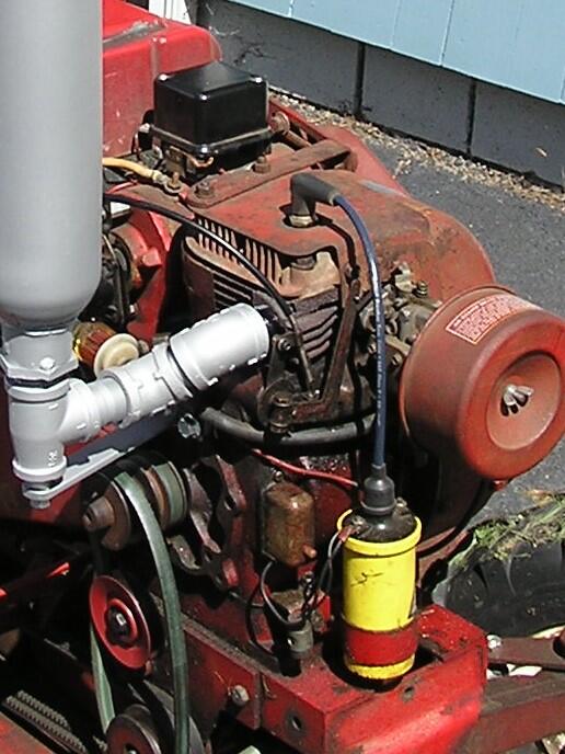

Easton Rich 1,292 #7 Posted February 17 Im using a coil wire from a late 60's early 70's small block chevy 2 Share this post Link to post Share on other sites

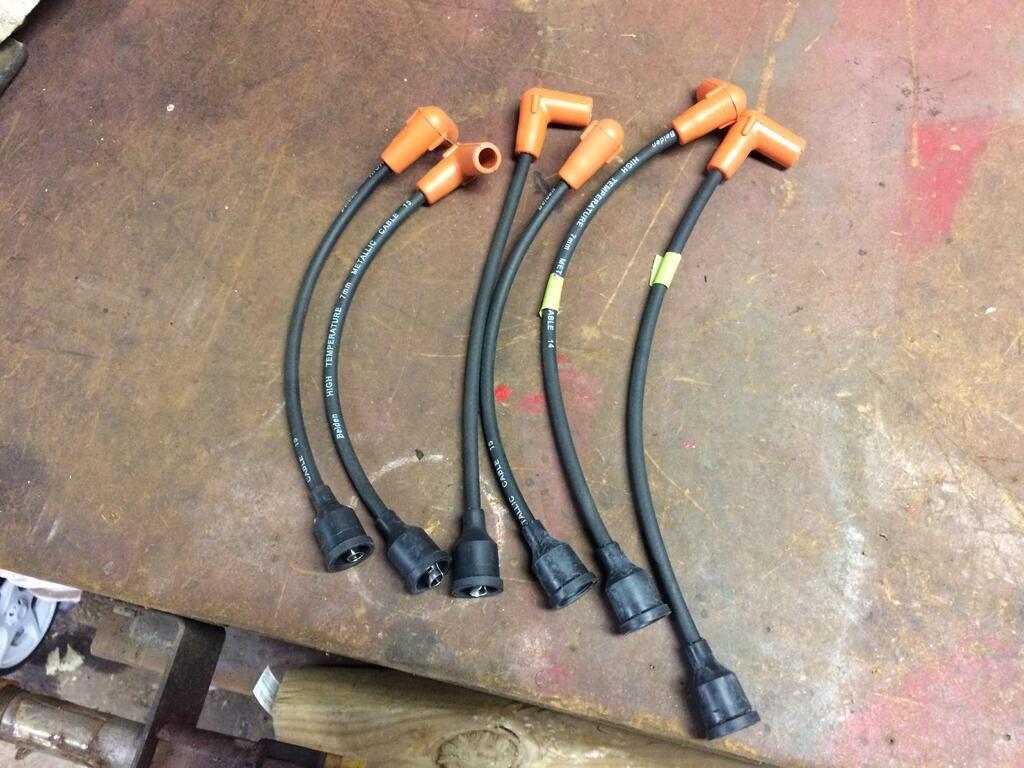

Achto 32,963 #8 Posted February 18 Given the fact that I have a handful of tractors, I buy a set of wires from TSC and cut them to length. One kit covers 7 single cylinder Kohlers. https://www.tractorsupply.com/tsc/product/tisco-spark-plug-wire-set-sws260 2 1 Share this post Link to post Share on other sites
Retired Wrencher 7,043 #9 Posted February 18 I believe the original wires were 7 mm. I bought some recently. They were an off brand on eBay. I have them on two different tractors. They seem to be working well. 1 Share this post Link to post Share on other sites
Retired Wrencher 7,043 #10 Posted February 18 10 hours ago, Achto said: Given the fact that I have a handful of tractors, I buy a set of wires from TSC and cut them to length. One kit covers 7 single cylinder Kohlers. https://www.tractorsupply.com/tsc/product/tisco-spark-plug-wire-set-sws260 Where those 7mm wire Achto? 1 Share this post Link to post Share on other sites
Achto 32,963 #11 Posted February 18 30 minutes ago, Retired Wrencher said: Where those 7mm wire Achto? Not sure, never measured the outside casing. They are copper core wires not graphite core. Share this post Link to post Share on other sites
Retired Wrencher 7,043 #12 Posted February 18 1 hour ago, Achto said: Not sure, never measured the outside casing. They are copper core wires not graphite core. Ok thanks. I will have to run down and check them out at T/supply. 1 Share this post Link to post Share on other sites

squonk 48,427 #16 Posted February 23 On 2/18/2026 at 5:50 AM, Retired Wrencher said: Where those 7mm wire Achto? Most universal tractor wire sets are 7MM Share this post Link to post Share on other sites
squonk 48,427 #17 Posted February 23 I buy solid core Belden High Temp wire in bulk along with high temp silicone rubber plug boots. Belden terminals and coil nipples 1 2 Share this post Link to post Share on other sites
sqrlgtr 4,225 #18 Posted February 23 2 hours ago, squonk said: I buy solid core Belden High Temp wire in bulk along with high temp silicone rubber plug boots. Belden terminals and coil nipples Same here but maybe different name brand. I got tired of not having the right length wires and started making my own. Little upfront investment but crimp tool and supplies have already paid for themselves. 1 Share this post Link to post Share on other sites
