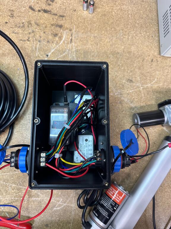

i did and to be honest, the heat output probably won’t make much of a difference in the cab. I put my digital multimeter on the battery and turned everything on one by one and it did draw down to just under 12 volts when I turned the heater on with all the lights on. The heater was free with the package as part of a promotion they were running at the time.
I do plan upgrading to a digital volt/amp gauge on the tractor.
Also will be looking for a reduction steering kit to put on it. I believe everything from a 520-H system should fit on a 418-A with little modification. I’m planning on the cab being a permanent install and didn’t want to put it on the 520-H that I have because that reactor was my Dad’s and has sentimental value and enjoy using it for mowing and other things.

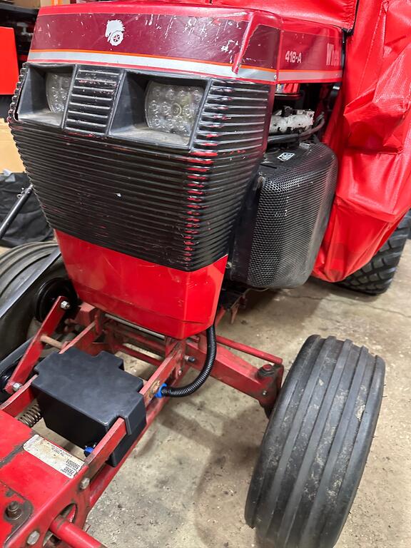

I did pick up my 12 volt power from the accessory line prior to the fuse, since I installed separate fuses for everything I installed, and just getting those wires routed was very tight. The junction box in the pic below that I mounted forward of the fuses came with the kit.
1 hour ago, WHX?? said:
Not familiar with a 418 electrical sytem Andy but yes be careful of a the accesories. I did draw measurements on the high powered lighting I put on but blew the nine pin out on every 520 I modded.  Now that everyday is Saturday never blow at night anymore. Don't have to worry about blowing early AM or when I got home from work in the dark.
Luckily, no 9 pin on the 418-A. Much simpler electrical system.

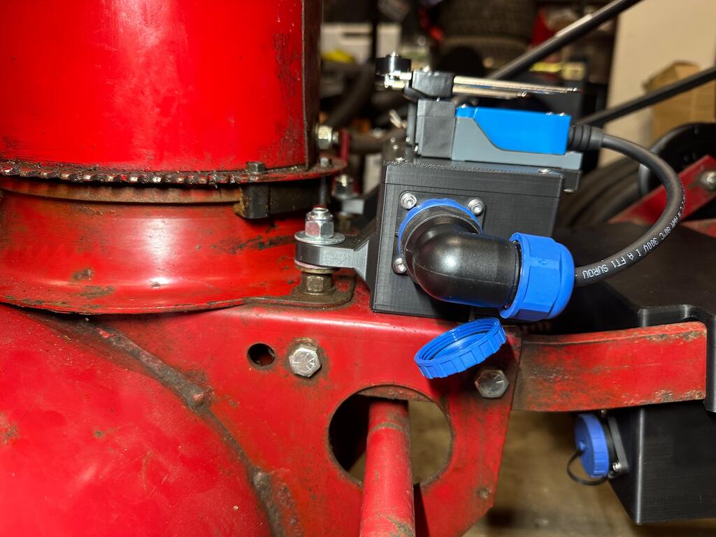

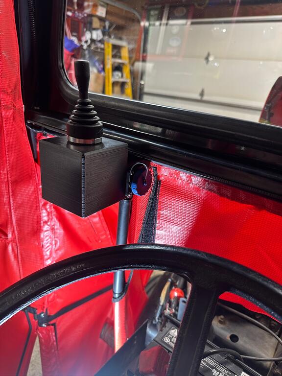

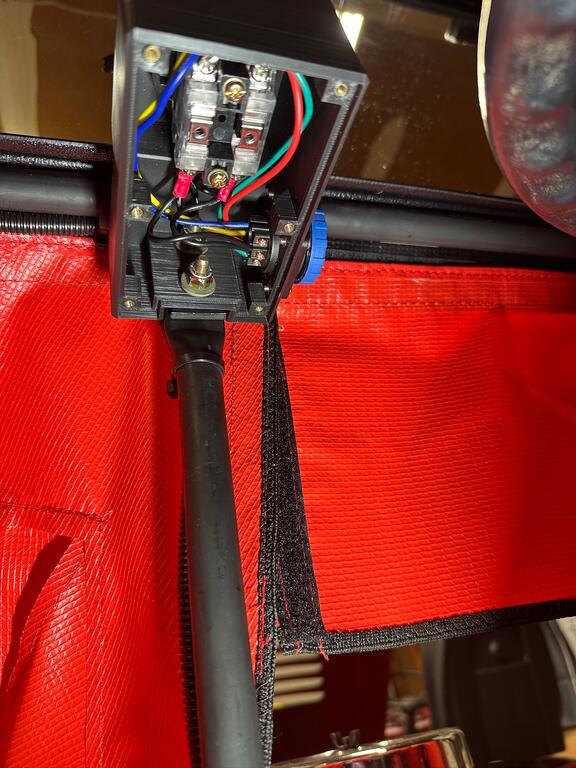

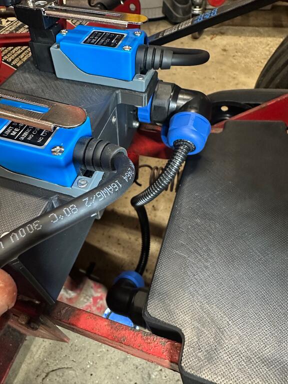

I like the idea of a joystick over using smaller switches.
Adding a small flap of rubber or some weather strip under the bottom edge of the deflector will stop the back flow of snow when it is pointed down. That back flow snow will cover the limit switches
