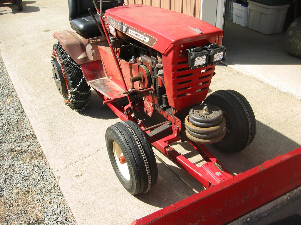

Sparky-(Admin) 26,360 #1 Posted February 7 Hey guys, buddy of mine was asking about front end traction and I mentioned the bike/motorcycle chain idea. Can I get a couple pictures from you that have done it to send his way. Thanks! Share this post Link to post Share on other sites
ri702bill 13,067 #3 Posted February 7 Those do tend to scuff up a sealed asphalt driveway... How about fluid filled front tires & front wheel weights instead as an alternative? Share this post Link to post Share on other sites

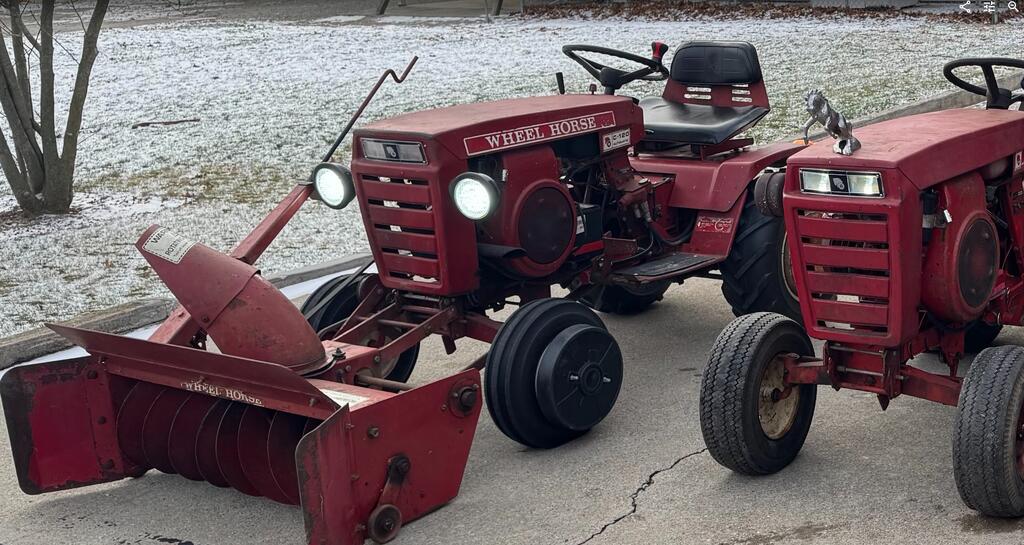

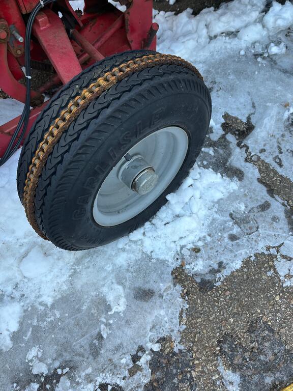

Ed Kennell 47,344 #4 Posted February 7 Not the bike chain, but I have these 2 links on my 520H. Also noticed the rear weights are actually 75 pounders. 4 1 Share this post Link to post Share on other sites

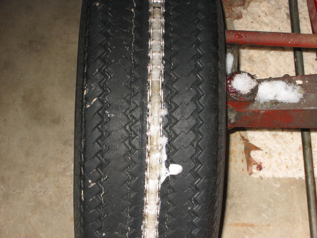

pfrederi 21,150 #5 Posted February 7 (edited) Been using them for several years only fell off twice...let the tire get too soft. Edited February 7 by pfrederi 5 2 2 Share this post Link to post Share on other sites

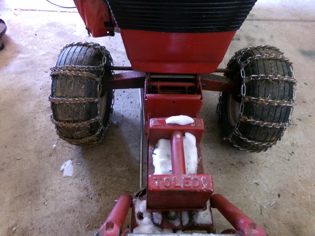

rjg854 13,359 #7 Posted February 7 Mine has the same setup as Paul's 4 1 Share this post Link to post Share on other sites

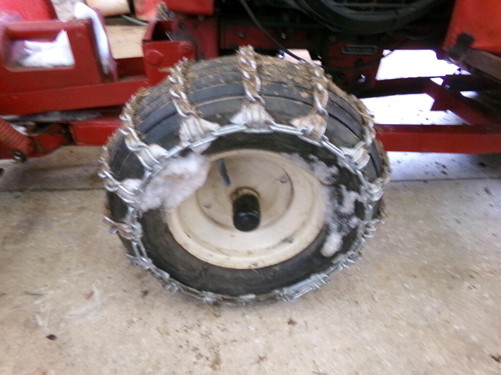

Wayne0 1,634 #8 Posted February 7 2 hours ago, pfrederi said: Been using them for several years only fell off twice...let the tire get too soft. I've got double #50 on mine. I had it on hand. 520H with a 2 stage blower. 2 1 Share this post Link to post Share on other sites

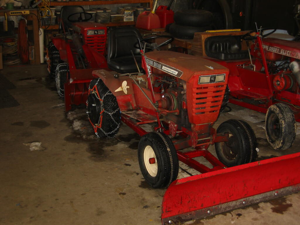

Bar Nuthin 3,238 #10 Posted February 7 Not as aggressive as chains, but I get along pretty well with tri-ribs and front weights on blacktop. 7 1 Share this post Link to post Share on other sites

jsoluna 514 #19 Posted February 11 Good view of the front #40 chains on the front of our Raider 10 here. They made a significant difference in front traction. 1 Share this post Link to post Share on other sites
