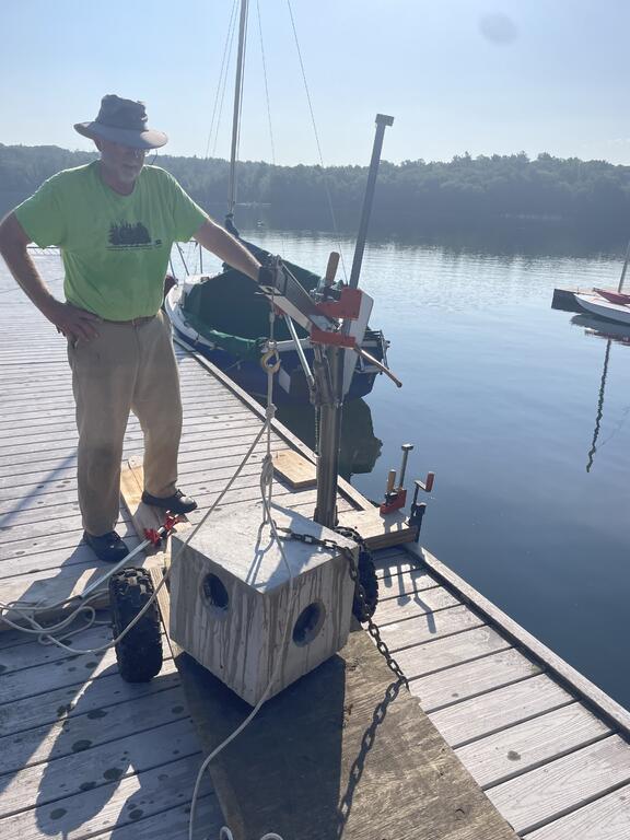

CCW 1,519 #28 Posted February 7 Used this crane last spring to lift and place six 350 pound blocks of concrete for a dock anchor. Planning on the same job again this spring on another dock. Worked perfectly and no strain on my back. Then mounted in my trailer to move a recliner I purchased. It is worth every penny of the $200 it cost at HD. 6 Share this post Link to post Share on other sites

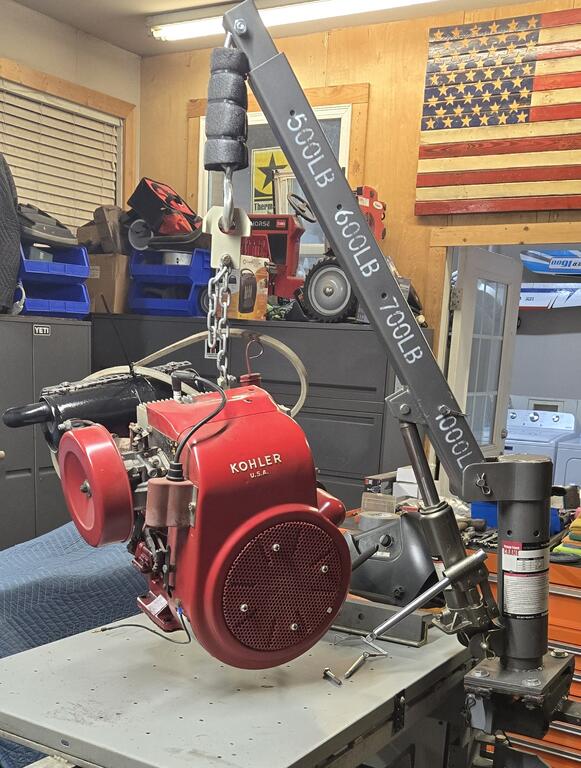

kpinnc 18,967 #29 Posted February 8 Well I used my setup for it's intended purpose today, and it worked like a champ. K321 now has a new oil pan gasket and I lifted nothing. This thing is awesome! 2 4 Share this post Link to post Share on other sites

kpinnc 18,967 #34 Posted February 12 Too late for a test run tonight, but all back together. This lift has helped so much. I never knew how bad I needed this! It lowered the engine gently down and all I had to do was nudge one way or the other until the engine settled in place. Neither the lift nor myself ever broke a sweat! Every once in a while, I fab up something that works! All too often a given project goes back to the scrap pile. 9 Share this post Link to post Share on other sites

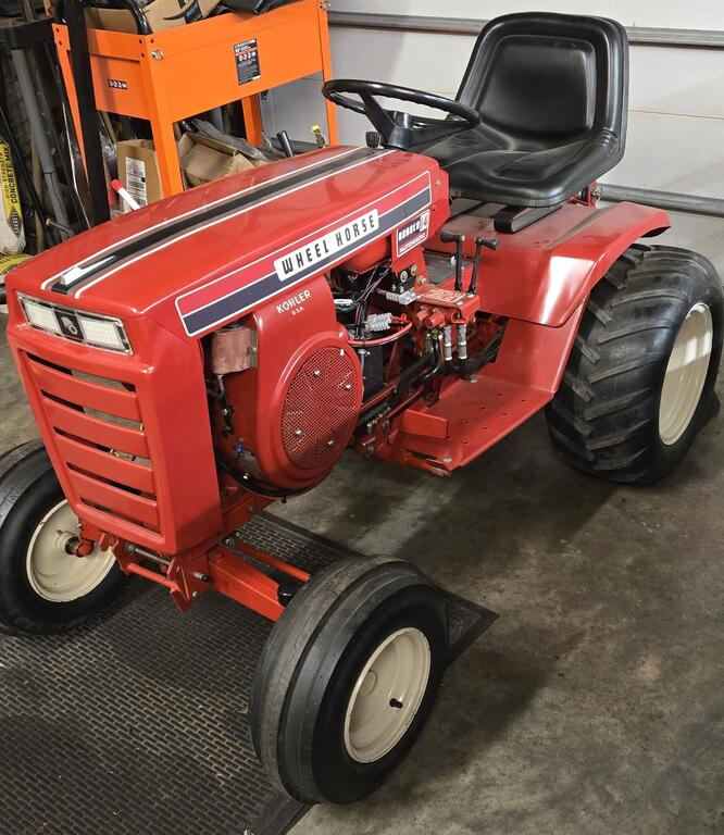

c-series don 12,453 #35 Posted February 13 @kpinnc Every time I see that tractor I love it! It just looks bad ass! Duel spool valves, and a 3-point hitch 👍🏻Where are the front weights? 1 Share this post Link to post Share on other sites
kpinnc 18,967 #36 Posted February 13 1 hour ago, c-series don said: @kpinnc Every time I see that tractor I love it! It just looks bad ass! Duel spool valves, and a 3-point hitch 👍🏻Where are the front weights? Thank you sir. It is definitely a keeper. Has a few scratches and spots that need a touch up, but definitely one of my favorites. The front weights are about 4 feet away from it. I'll stick them back on when I finish it up. I thought it was all done but the electric clutch wobbles really bad and when driving it around today it started spitting oil from around the fuel pump. So this weekend it's getting an electric pump. The clutch can wait... 2 Share this post Link to post Share on other sites

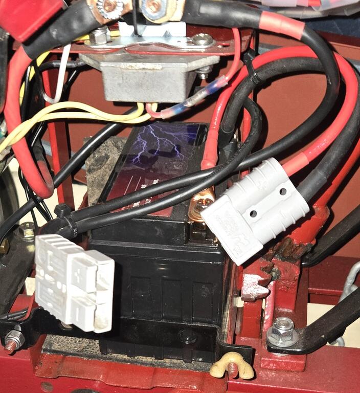

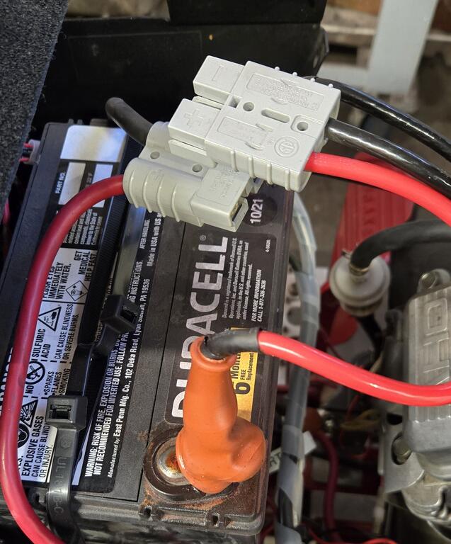

19richie66 17,935 #38 Posted February 13 On 2/11/2026 at 11:00 PM, kpinnc said: Too late for a test run tonight, but all back together. This lift has helped so much. I never knew how bad I needed this! It lowered the engine gently down and all I had to do was nudge one way or the other until the engine settled in place. Neither the lift nor myself ever broke a sweat! Every once in a while, I fab up something that works! All too often a given project goes back to the scrap pile. How about a closeup on the battery cables. I have some of those 50A Anderson plugs I want to put to use. Just wondering how you did yours. I want to be able to trickle charge the battery and that looks the part. Hope to have my Bronco 14 going soon. That’s inspiring 😁 Share this post Link to post Share on other sites
kpinnc 18,967 #39 Posted February 13 (edited) 3 hours ago, 19richie66 said: How about a closeup on the battery cables. All of my tractors have those. You can swap a battery in seconds. I also prefer to disconnect all my machines when they are not being used. Some have brackets holding the chassis side, some don't. And yes, trickle charging is simpler too. I've also never found a dead battery since I started using them a few years ago as there are no drains to bleed down. It's also nice to be able to wrench on a tractor without worrying about touching a hot spots. Some examples: Edited February 13 by kpinnc 1 1 1 Share this post Link to post Share on other sites
19richie66 17,935 #40 Posted February 13 23 minutes ago, kpinnc said: Thanks Kevin. Exactly what I wanted to see. Going to slap some on the herd. 1 Share this post Link to post Share on other sites
