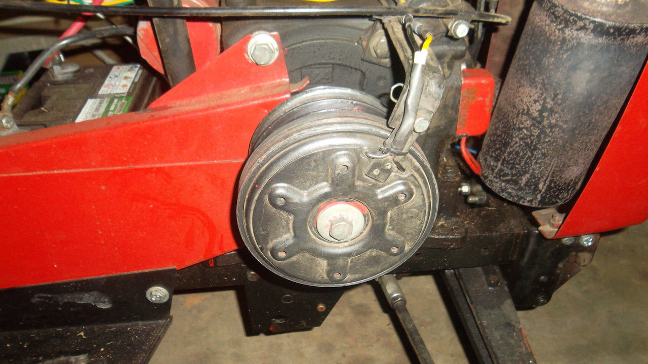

horseman with no horse 68 #1 Posted February 2 (edited) im trying to get the pto stopper on my onan but i can seem to get it to clear the exhaust, i had to buy a different one because i lost the original. the problem im having is the new stopper has a little shoe on it and i cant rotate the bracket as it hits the exhaust Edited February 2 by horseman with no horse Share this post Link to post Share on other sites

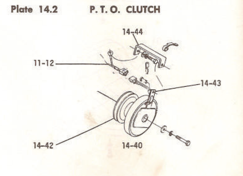

horseman with no horse 68 #2 Posted February 2 (edited) my old one looks like the one in the breakdown but the new one looks like this Edited February 2 by horseman with no horse Share this post Link to post Share on other sites
horseman with no horse 68 #3 Posted February 2 (edited) could i possibly get away with grinding down the little plate? or is it just possibly the wrong one entirely? the part numbers are the same and i cant seem to find anything online about an "onan specific" stopper Edited February 2 by horseman with no horse Share this post Link to post Share on other sites

horseman with no horse 68 #6 Posted February 2 its a c120 special with an onan p218 on it, im running the electric clutch. i have my snow blower mounted to it and the exhaust flipped to vent exhaust forward but it doesn't really change the bracket being in the way im gonna take a good video and post a link in a little while Share this post Link to post Share on other sites
Lee1977 7,803 #7 Posted February 3 This one on a 12 Kohler. If it's locking up the clutch I would grind the weld down and remove it. Share this post Link to post Share on other sites
Handy Don 17,557 #8 Posted February 3 The. bracket’s jobs are to support the wiring and prevent the electromagnetic coil from spinning on the engine shaft. I agree with @Lee1977, modify as needed. 1 Share this post Link to post Share on other sites
