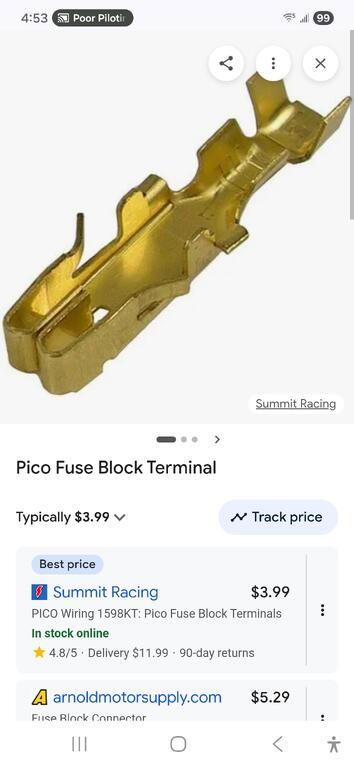

gwest_ca-(File Mod) 12,554 #2 Posted February 1 Does it have these terminals? Click on the picture for more. 1 1 Share this post Link to post Share on other sites

Bill D 3,212 #4 Posted February 1 This is the terminal you have/need. Note the little tabs that lock the terminal into the fuse block. You need to bend those in with a small pick to release the terminal. I'd recommend replacing the 9 pin with a 5 pin and 2 pin Packard 56 connector. The 416 only uses 7 of the 9 pins. I'd also recommend running a 14 gauge wire from the battery positive in the starter to the positive terminal on the voltage regulator. That with eliminate future fuse block issues. 3 Share this post Link to post Share on other sites

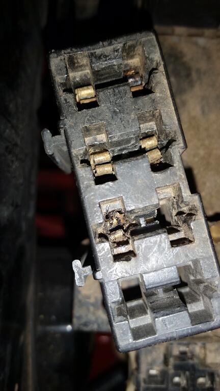

WHX?? 58,386 #8 Posted February 3 (edited) 3 hours ago, c-series don said: only use this tractor to mow with Hopefully that ain't too far off Don. This winter BS gets a little old come February & jonesin for the smell of fresh cut grass. On a 416H I had what I ended up doing was getting new terminals and moving the wires to the empty/spare location. If you notice the top slots had some issues goin on too so I shoulda went the Sqounky route. This tractor was going to my stepson where machinery goes to die anyway. @Achto knows! If was to keep this one I woulda took a stab at replacing the whole block just for the challenge. Edited February 3 by WHX?? 2 Share this post Link to post Share on other sites
