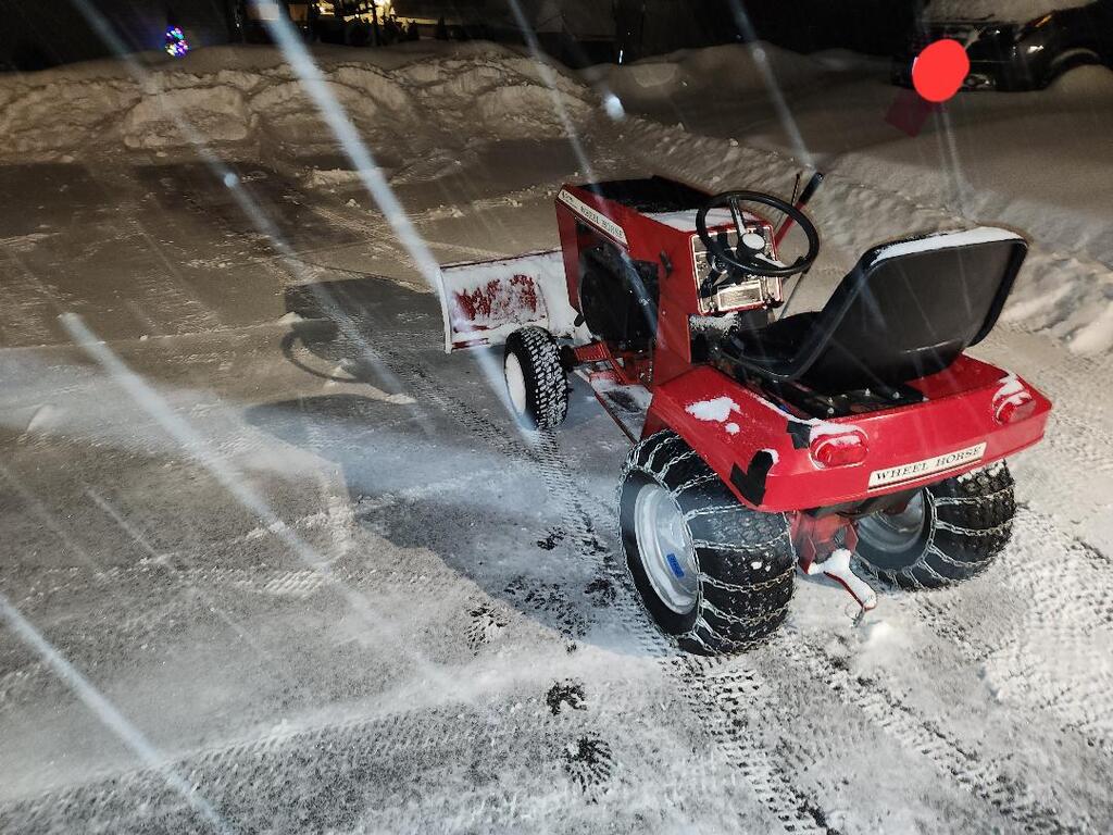

Chris689 323 #41 Posted February 4 Believe me when I say I understand money being tight. Everyone’s been there. Chains are a great, inexpensive way to go. I went through last winter using chains and I believe 50# generic weights on my turfs with a snow plow. Drastic improvement over not using chains at all. However, at some point the chains shifted and ripped a lug causing a pretty bad leak. I may not have had them tight enough but at the same time the tires were also dry rotted so just keep the condition of your tires in mind. I saved up and bought some AGs off eBay for $160 roughly. This past storm CT got, I had anywhere between 8-15 inches of snow. I ran just my AGs with the same weights as last year and I used a snowblower attachment. 2nd gear low range and the machine just chugged along and ate the snow no problem. In the end use what’ll work best for you. Either route is better than just turfs. 1 1 Share this post Link to post Share on other sites

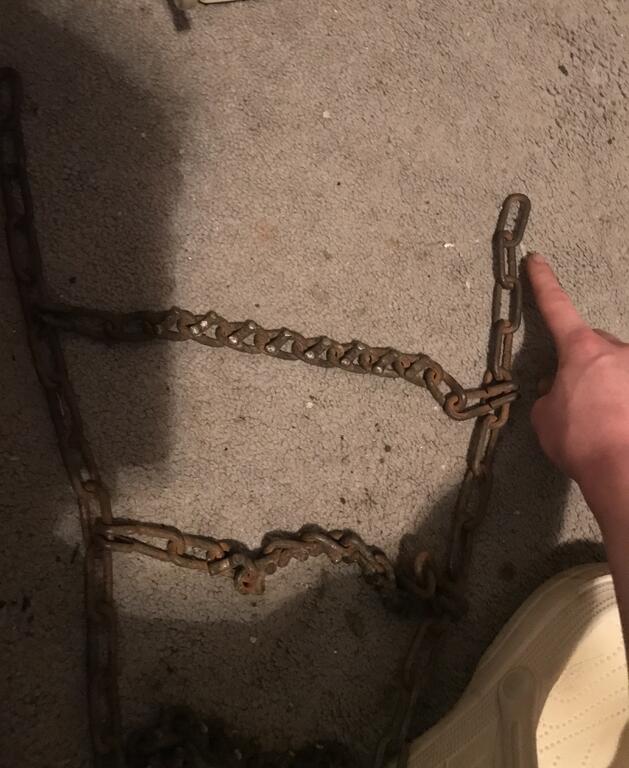

horseman with no horse 68 #42 Posted February 5 seems loose? got the chains on and they see a bit loose? Share this post Link to post Share on other sites
Ed Kennell 47,362 #43 Posted February 5 29 minutes ago, horseman with no horse said: seems loose? got the chains on and they see a bit loose? If they are too long to be able to tighten them, just remove the last cross chain so you can tighten them. 1 Share this post Link to post Share on other sites
horseman with no horse 68 #44 Posted February 5 you said to take off a cross link, i think that if i take off that much then it till be too tight, would taking off one or two of the side chain links on each side work? or would that mess up where they sit? Share this post Link to post Share on other sites
pfrederi 21,151 #45 Posted February 5 First lets make sure we are talking about the same things. Your finger is pointing at the side chain. (Cross links are the ones with Vs) The other end of the chain you are pointing at should have hook of some kind. If chain is too loose move the hook up to the second or third link fro the end where your finger is. Do the same for the other side chain. One side may have a couple different connectors depending on the brand Take a picture of the other end of the chain ..both sides 1 1 Share this post Link to post Share on other sites

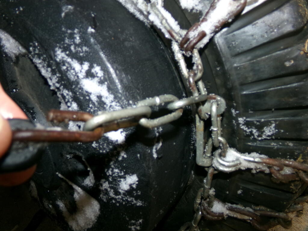

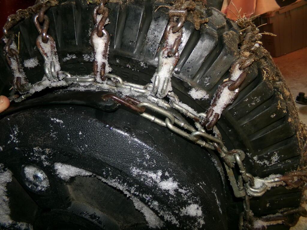

Ed Kennell 47,362 #46 Posted February 5 1 hour ago, horseman with no horse said: you said to take off a cross link, Yes, I said that because I assumed you had hooked the side chains in the link adjacent to the side chain and they were still too loose. Like Paul said, hook the side chain in a link near the cross chain. Then If they are still loose, remove that side chain so you can hook it shorter. The excess side chain links can be cut off or just secured with the chain tightener or a heavy tie wrap. The side chain does not have to be hooked in the end link if fact most are not. Use the link that makes the chains as tight as possible. Here is a picture of the not hooked in the end link And the excess links secured with a rubber chain tichtener. Hope this helps. Share this post Link to post Share on other sites
