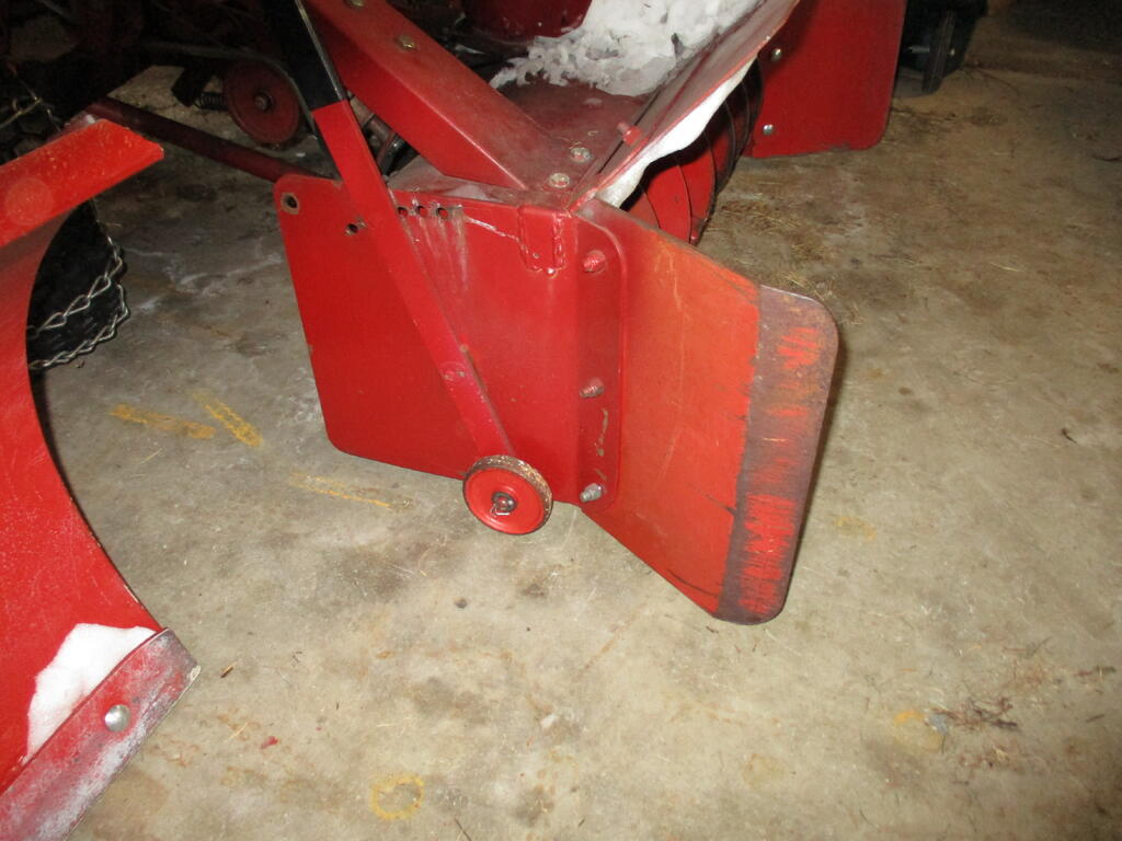

pfrederi 21,342 #21 Posted January 30 (edited) You are missing the steel wheel that goes on the blower is there one missing on the other side also. That is going to make it harder to shove the blower ahead if it is down. Edited January 30 by pfrederi 3 Share this post Link to post Share on other sites
