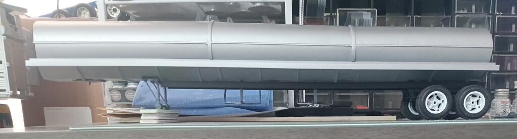

ebinmaine 80,067 #159 Posted April 5 Wheels & tires are on. Stance is good. Have to leave the front a little higher than I'd like for a day so the back set of wheels will dry straight. The 3D printed back end has been coated with Tamiya filler and wet sanded once. Now covered with filler again. Also been experimenting with fenders. At the back I've decided to use a stock styrene set from another kit. The fronts are longer and need a straight front corner to go up over the truck tires. I'll use a set from @Wheel Horse 3D for that. They have a corrugated wave, unlike the smooth rear set, but that's not the least bit abnormal for a road trailer. 3 1 Share this post Link to post Share on other sites
ebinmaine 80,067 #160 Posted April 19 I've been working on adding layers of filler and primer, then sanding them to get the tank end smoothed up. I sprayed a coat of silver paint on that today. Pics later. Here, the left rear fender has been attached. 2 2 Share this post Link to post Share on other sites

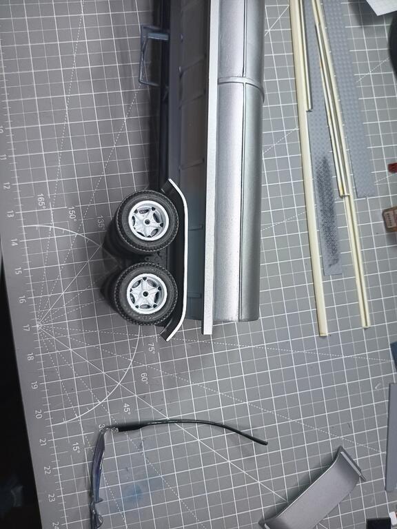

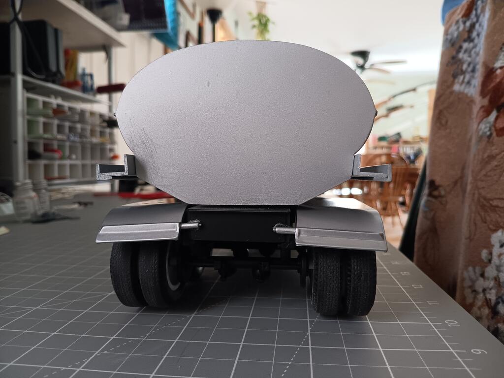

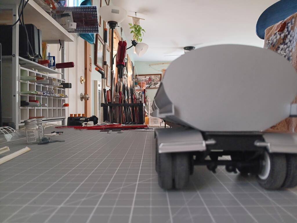

ebinmaine 80,067 #163 Posted April 24 Took some setting and resetting and patience... and I got the rear fenders where I wanted em. The pics don't quite show the angles right. They do sag to the outside away from the trailer. That lean is real. And on purpose. Some full scale trailers are built that way. I did catch that the fenders are a slightly different tilt. Decided to leave it. Sometimes life and machinery get tangled up and things get bent. I think the differing tilts adds to the realism of a working trailer. 6 Share this post Link to post Share on other sites
