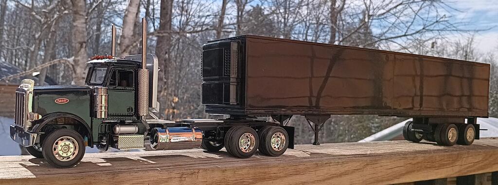

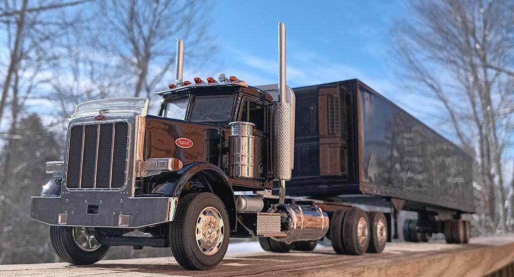

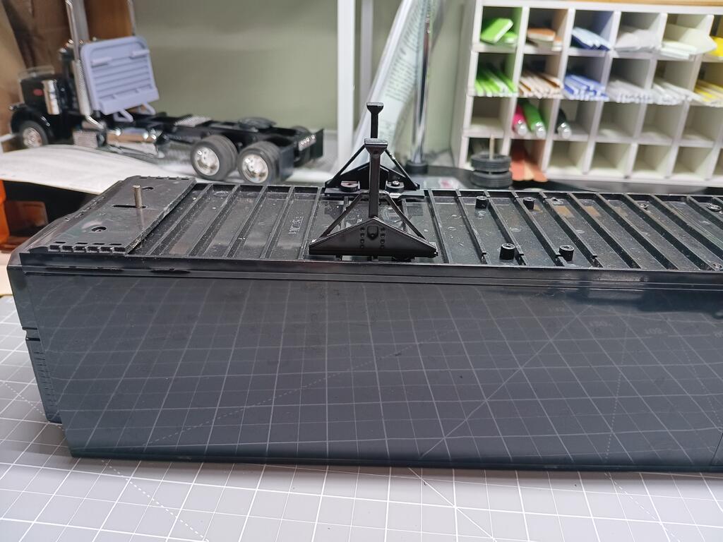

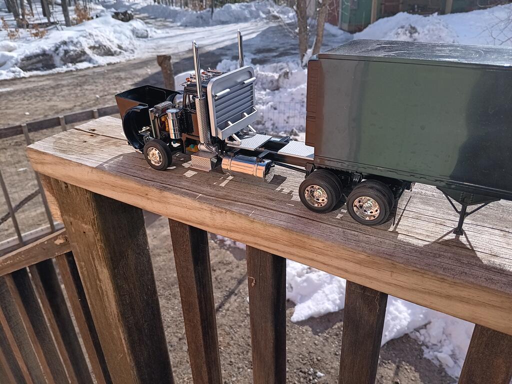

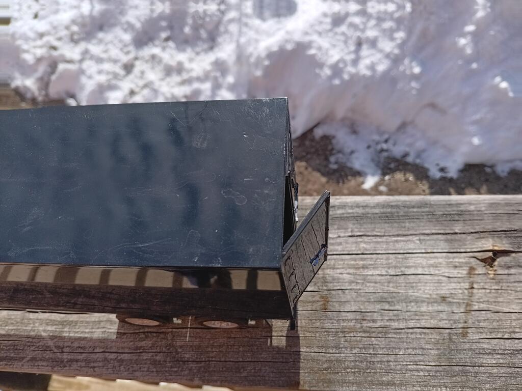

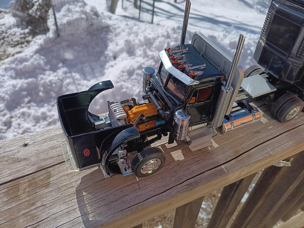

ebinmaine 80,695 #80 Posted February 21 Several things going on today. I got a coat of flat black on the trailer suspension of the tanker. On the Peterbilt I moved the bright chrome plate to the rear. Added the two silver ones. The cab guard will be setting on the front plate. That'll block off the former sleeper mounts from view. Been working on the matching trailer too. The axles and landing gear were in the wrong locations. The red pencil pointer shows the old places. I moved the axles back, relocated the mud flaps & rear bumper, painted the rear lamps. Also moved the landing gear forward to a more realistic place. The clamp with the white plastic was a couple base plates I made up so the landing gear would set flat in its new location. 5 1 Share this post Link to post Share on other sites

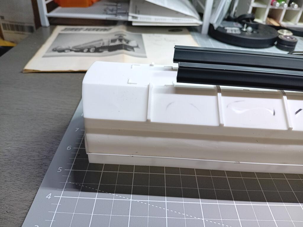

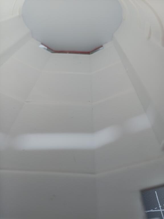

ebinmaine 80,695 #82 Posted February 22 Got the project tanker trailer back on the desk this morning. Last week I used a black marker to accent where all the visible defects and mold lines were in the plastic. Wet sand those marks off. Wash & dry, then recheck the surface. Mark more if needed. I found this method on YT. Seems similar to the way @Achto uses different primer colors to find highs and lows. Works excellent. 2 Share this post Link to post Share on other sites

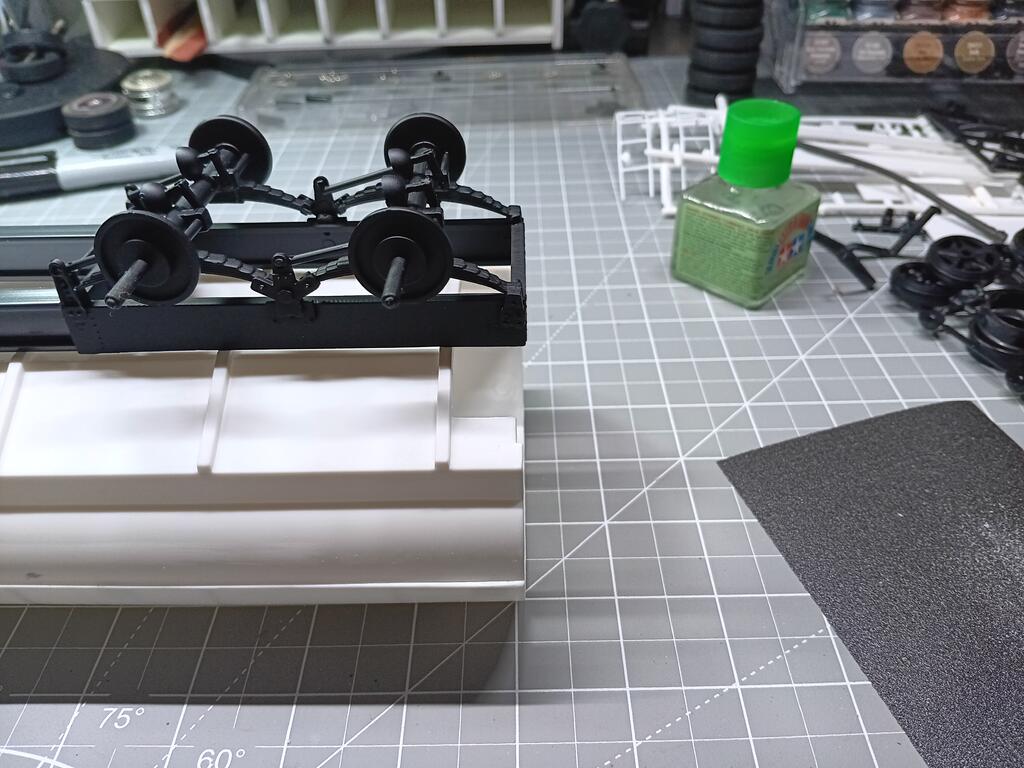

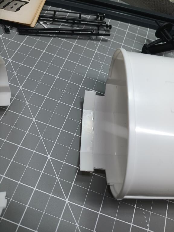

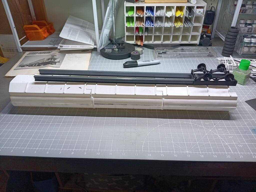

ebinmaine 80,695 #83 Posted February 22 Some progress pics of the tanker. The wet sanding went well for stage one. After this pic I used the flat sheet od sandpaper to "adjust" the line-up of the front and middle sections and glued them together. Here I'm doing a simple mockup for the rear suspension position and the frame rails I'll be adding on. Not sure exactly where the whole thing is gonna set just yet. 2 Share this post Link to post Share on other sites

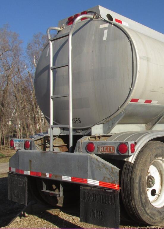

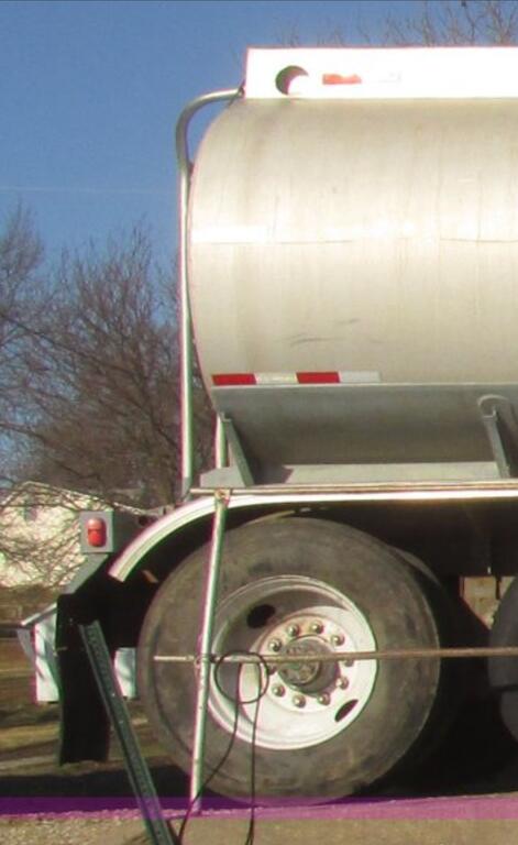

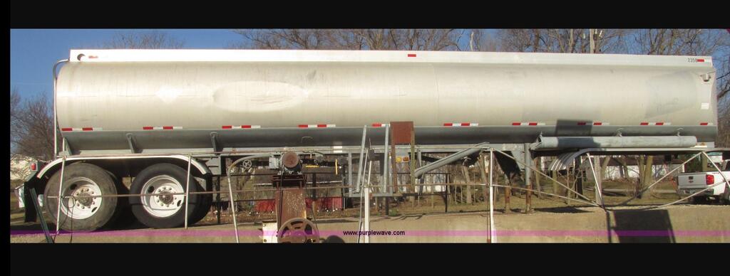

ebinmaine 80,695 #85 Posted February 24 More reference pics of the tanker as I remember it. Note that the rear axle is definitely past the rear of the actual tank. 2 Share this post Link to post Share on other sites

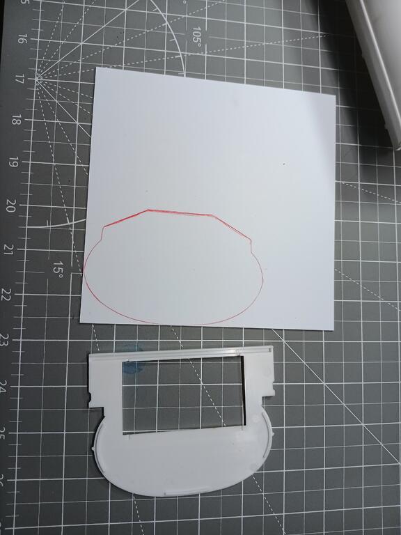

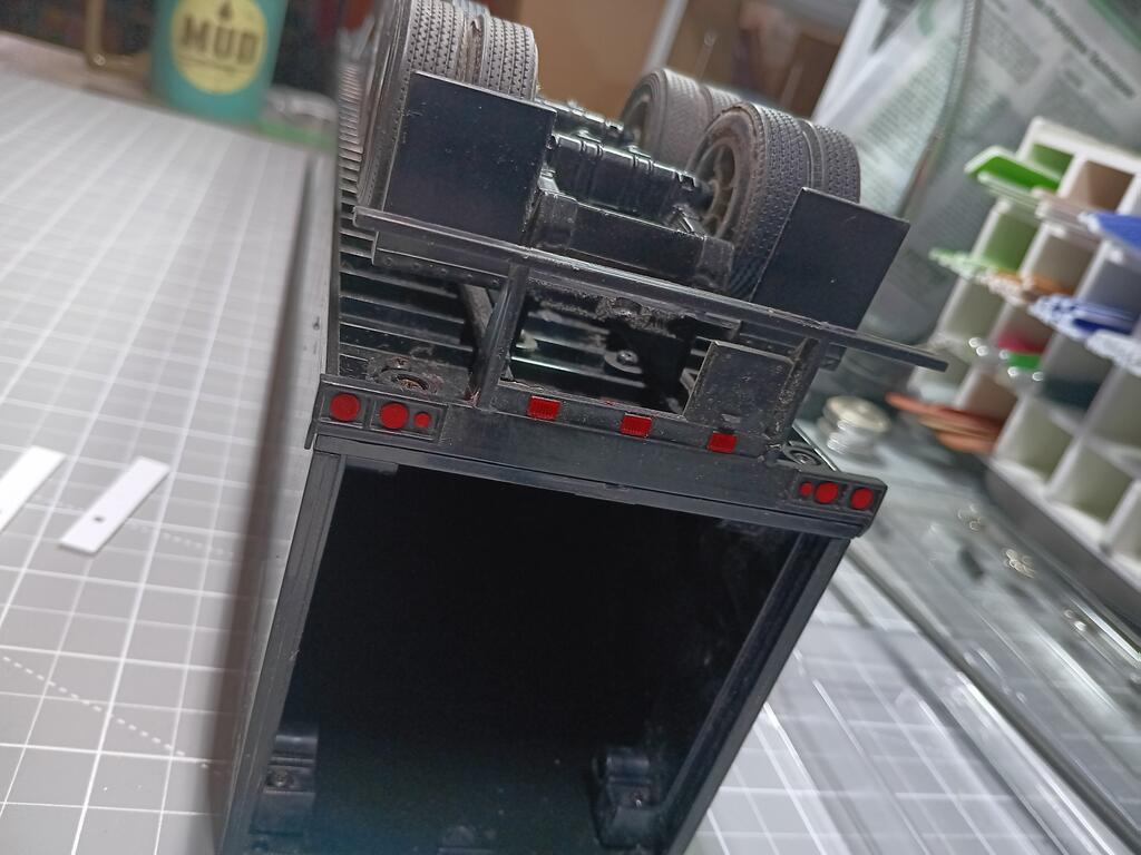

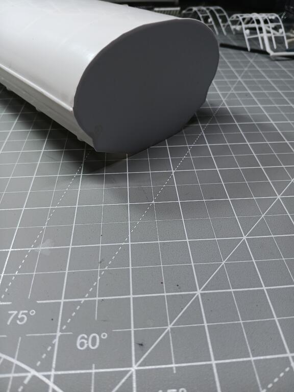

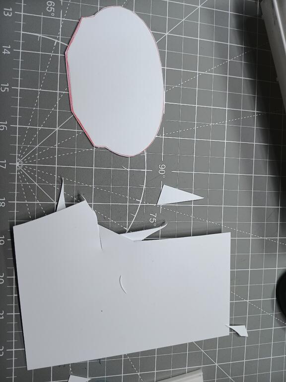

ebinmaine 80,695 #90 Posted February 26 This evening I worked on adding a back panel to the tank. The model kit I'm using is a "peddle truck". What I'm building is a bulk delivery rig. The back would be entirely different. Peddle trucks have the pump and hose housed at the rear. Think of a home heating oil truck. Bulk tanker would have the outlets for larger hoses only. Usually centered on the bottom. Not always. Many have rear or even front outlets. Think fuel station delivery truck. I've been mulling how to create a rounded look at the rear and haven't come up with a method that's within my current skill set. So, flat backed it is. I traced the tank onto a slab of thin sheet styrene. Glued that on. After that I was ready to attach the second rear section to the rest of the tank. Here's the interior center holder from the kit. The line up of the 3 pieces is absolutely horrible. Not exactly a huge surprise considering the molds were made back in the mid 1960s. Also, two different companies made these kits. Also, I'm doing something they weren't built for. It'll take some serious filler, sanding, patience, repeat... It'll eventually resemble a bunker tank. 1 2 1 Share this post Link to post Share on other sites
Handy Don 17,474 #91 Posted February 26 Too late, but I might have tried heating a thin styrene sheet with a heat gun and molding it over something with the right bulge/curve. Once cooled and hard, then trace and cut to match the tank’s end. 3 Share this post Link to post Share on other sites
8ntruck 9,296 #92 Posted February 26 Got an old Mattel Vac U Form? 2 Share this post Link to post Share on other sites
ebinmaine 80,695 #93 Posted February 26 8 hours ago, Handy Don said: Too late, but I might have tried heating a thin styrene sheet with a heat gun and molding it over something with the right bulge/curve. Once cooled and hard, then trace and cut to match the tank’s end. 6 hours ago, 8ntruck said: Got an old Mattel Vac U Form? One of the advantages of using styrene is that "too late".... isn't. I can definitely add another piece to the back here. I knew about the ability to mold the sheets (That's likely how I'll make the front and rear fenders) but not what to "wrap" on to. I'd need to create something with a different convex in the up/down and left/right directions. It would also need to be such a slightly and thin taper I'm not sure how to accomplish the task. Wood would be to thin I think 🤔? Perhaps it's a @Wheel Horse 3D job? 3 Share this post Link to post Share on other sites
8ntruck 9,296 #94 Posted February 26 4 hours ago, ebinmaine said: Perhaps it's a @Wheel Horse 3D job? This would be a good job for a 3d printer. Most of the work would be in building the CAD model. From what @Wheel Horse 3D has posted, I think he has some CAD software that is designed for 3d graphics work that could 'sculpt' the contours needed fairly easily. I wonder if he can print styerene? If you went the heat formed sheet method, you would need to make a 'plug' to form the plastic over - wood would work fine for that. 1 Share this post Link to post Share on other sites
