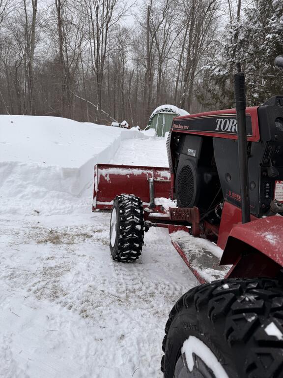

Alrashid2 476 #39 Posted January 30 (edited) THE CARLISLES ARE IN! Wow, they are beefy! Cannot wait to try these out. The front tires are supposed to be delivered Sat. My shop opens Mon but not sure if I can drop off during their hours or not... If so I bet I get the wheels back by next Fri and can test out! Ps: looks like I can't upload photos because my "attachments are full". If I go into my attachments and delete them all, will that delete them from my original posts/replies too? Edited January 30 by Alrashid2 Share this post Link to post Share on other sites

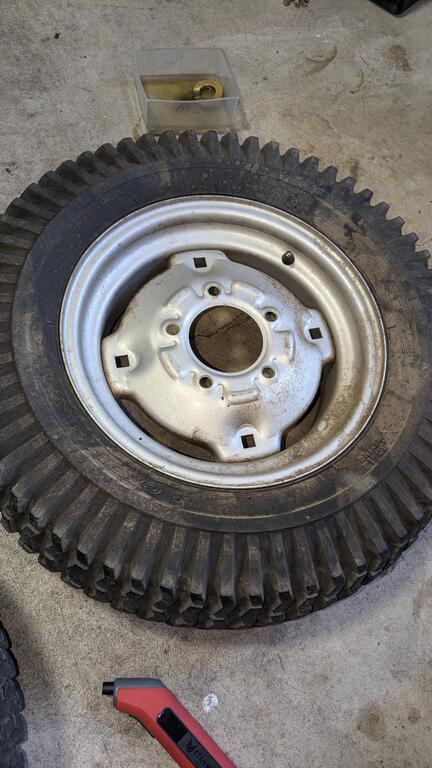

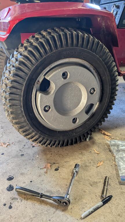

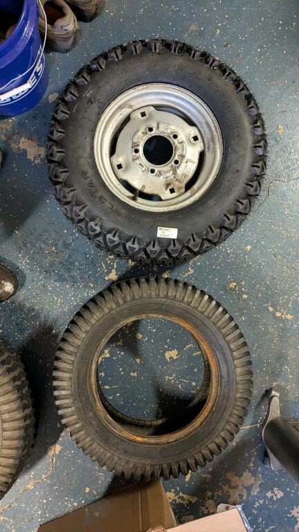

Alrashid2 476 #46 Posted February 6 (edited) Welp, tractor was down 40 yards in the shed, and with this SnowCrete I was not getting it up to the garage. So, went down into the shed with my floor jack, jack stands, some lights and tools and got all 4 wheels off! Took them down to my local shop. I do almost all of my work on my small engines myself, so I only go to the shop once a year, maybe once every 2 years. Get there and find out it's under new ownership! Didn't get the best first impression. Owner acted like I was bothering him by coming by to get the tires replaced. As soon as I bring the old and new wheels in, he goes "You bought the wrong tires, these won't fit". Told him they should fit fine and that guys online with same rims/tractors (aka you guys) have made it work fine. He says he'll try his best but can't make any guarantees. Want to make sure I'm not missing something here. For those of you who have the Carlisle All Trails in 23x8.00-12 ( @Sparky and any others ) I'm not crazy right? What tractors do you have your All Trails on? Do we have the same rims? Here's a photo of one of my rear tires and my rim. Edited February 6 by Alrashid2 Photos Share this post Link to post Share on other sites
Sparky-(Admin) 26,898 #47 Posted February 6 28 minutes ago, Alrashid2 said: Want to make sure I'm not missing something here. For those of you who have the Carlisle All Trails in 23x8.00-12 ( @Sparky and any others ) I'm not crazy right? What tractors do you have your All Trails on? Do we have the same rims? Here's a photo of one of my rear tires and my rim. You’re fine, the 23x8’s will mount up just fine on your rear wheels. Looks like you have 22x7.50’s? The new ones are only .5 (1/2”) wider Share this post Link to post Share on other sites
Alrashid2 476 #48 Posted February 6 (edited) Thanks @Sparky - that's what I was thinking too. He started talking about how the new tire was flat on the treads, while my old tires/rims were "rounded" more. I figured that was just because the tires are not on a rim and not inflated yet... Hope he doesn't pull anything weird. He said he's swamped with snowblower work right now so he won't have them done until mid next week. Works for me because he's only open 7AM-4PM and I work all week, so probably won't pickup until next Fri anyway! Have a busy weekend coming so may not be able to test out until 15 Feb onward... will report back with updates! Thanks PS: Totally forgot to mention. I tried to get the tractor up to the house and got stuck just rolling out of the shed! The SnowCrete is wild - never seen anything like it in my life. In the back and forth trying to move forward/reverse and get traction, I held the brake while the wheel was spinning and didn't even realize, and caused my brake lining to rip right off! It's still intact luckily so while i had the wheels off, I pulled the brake lining part and will re-glue it over the weekend... fun! Edited February 6 by Alrashid2 Share this post Link to post Share on other sites

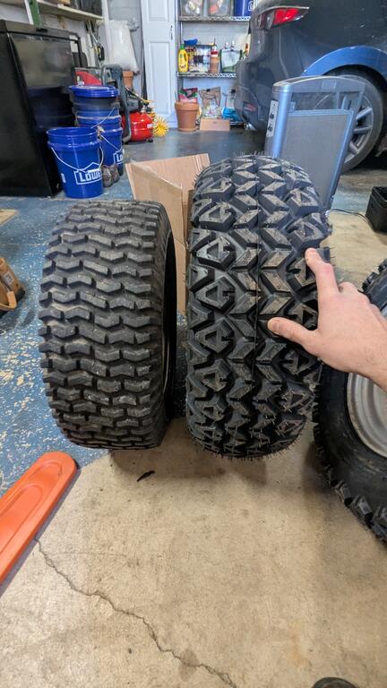

Alrashid2 476 #49 Posted February 13 (edited) TIRES ARE BACK! Man, they look good! I won't have time until Sun or Mon to actually install them, but they look good at least! Since my tubes in my old tires were only a year old, he reinstalled them with the new tires. Gave me the old ones back: wow, the old ones were 22s and the All Trails are 23s, but theyre actually 4" taller! I'm stoked to try these out. Will report back soon Edit: I actually have a question for you guys. I noticed the new tires' tread is much more bulged and rounded, where the center will make contact more than the edges. As you can see my old tire was much flatter. Is that normal with a larger tire size on the same rim? Maybe the tubes do this? My shop had them at 18 PSI so I dropped to 10 PSI but they look about the same Edited February 13 by Alrashid2 Photo Share this post Link to post Share on other sites
pfrederi 21,342 #50 Posted February 14 Bulging happens when you put fat tires on skinny rims... 1 Share this post Link to post Share on other sites
