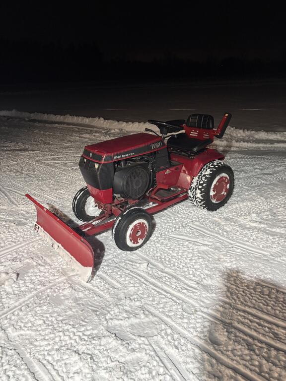

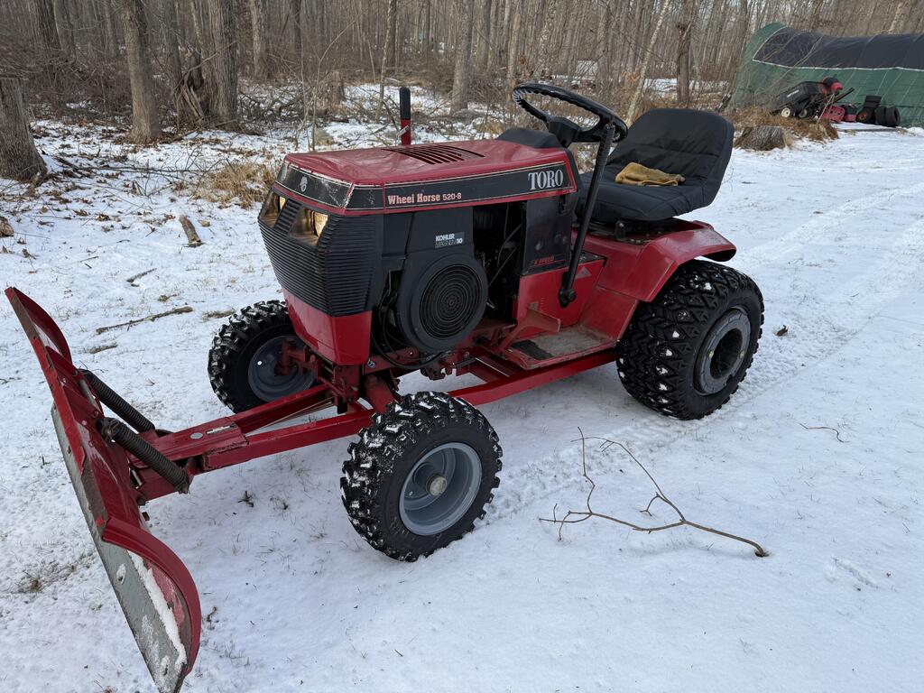

Hey yall! I had a discussion going about rubber tire chains and I've ultimately decided I'd like to try getting new tires for my Wheel Horse 312-8, and wanted to get some advice.
My situation:
  • Use the horse for plowing a steep driveway and moving firewood up the house
  • Driveway is asphalt, 15% grade, 200+ feet long
  • Moving firewood from my racks to the house is about 40 yards (120 feet), uphill 15-20% grade, in the woods. Trail is just dirt and leaves.
  • Currently have very basic Turf Saver tires on the horse, 22x7.50-12
  • Have had zero problems plowing with these tires or driving around the woods in the summer for the most part
  • Only issue I'm having is going up that steep, forest hill when there is snow on the ground! Tires just spin in the mud

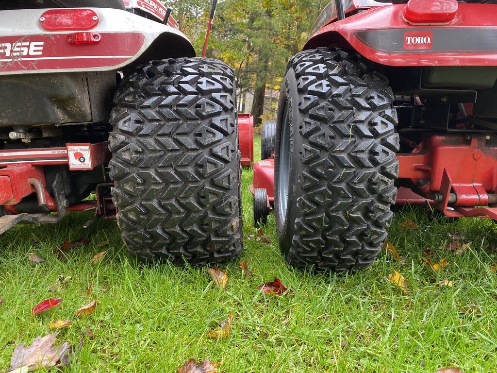

I’m partial to this tread (yes, these are my tractors).
  Brand: Carlisle All Trails
 The ones on the right are 23 x 8.0x12’s and would fit your current wheels and clear your fenders just fine.
  • Like 3
  • Excellent 2
  • Heart 1
Brother, too funny I literally just saw your post on the Tires megathread and was looking at the 8" width ones you posted! I do think those would work really well for me, and I was able to find a set for under $200 which I can live with.
Thanks for posting! Can I ask, have you tried these tires plowing on asphalt in the snow? How about going uphill in the mud or snow?

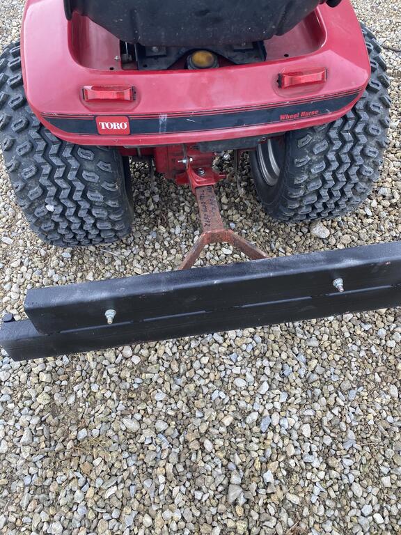

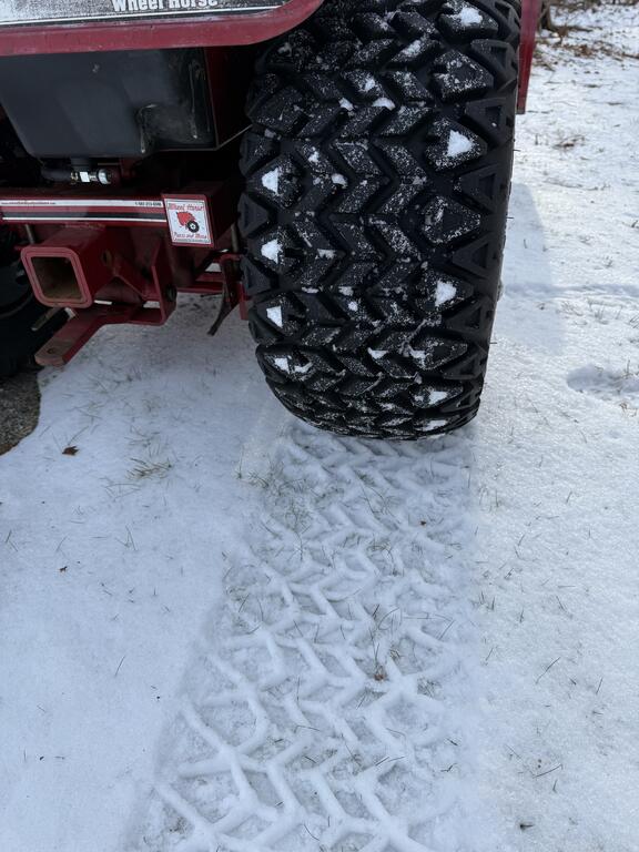

 The wide ones are on my snow-plow machine, with 75#’s pounds of cast weight on each. They work great and I don’t run chains on my paved drive. I do keep the air pressure low, keeps the tire more squishy and pliable.
  The narrow set are on a tractor that mainly sees mowing duty. They are great for that and DO NOT tear up my lawn. I have used this machine occasionally to haul firewood from the woods in “mud season” and they are better than turfs, but can get mud packed and then they are like racing slicks. The sticky mud does not eject well from the depths of the tread.
  These pics are the wide ones on my plow tractor.
  • Like 2
