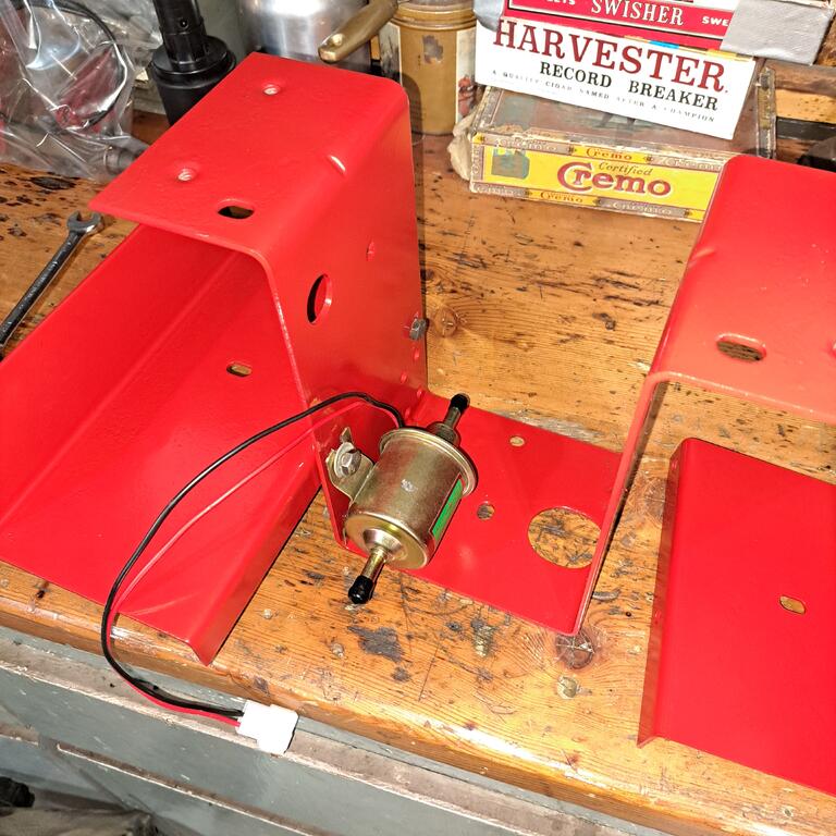

WHX?? 57,635 #2 Posted January 27 (edited) We sure have been talking about these a lot lately. I use the offshore 9.98 ones with no problems but any low pressure 2-4 or 5 psi will work. Search on electric fuel pump to find those threads. Just installed a cheapy on a 520 that was a notorious hard starter. Started right up the other day at -15 out. Another one in progress. Edited January 27 by WHX?? 1 2 1 Share this post Link to post Share on other sites

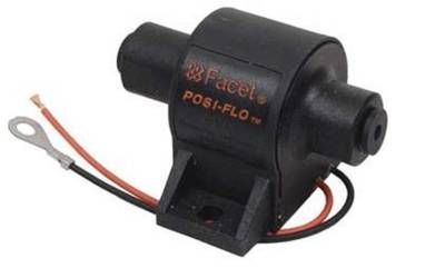

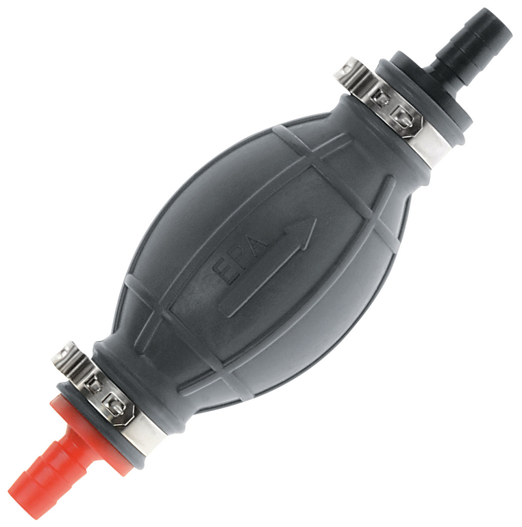

kpinnc 18,851 #3 Posted January 27 (edited) In the short term, a primer bulb will help greatly. They certainly save batteries and starters when the fuel tank is that far back. I like my electric pumps, but I keep a couple primer bulbs on hand as well. The cheaper electric pumps can croak on you at the worst possible time... Facet low pressure (1-2 psi) electric pumps are best but they are expensive. Edited January 27 by kpinnc 1 1 Share this post Link to post Share on other sites
Stan50 213 #4 Posted January 27 (edited) 7 hours ago, kpinnc said: Facet low pressure (1-2 psi) electric pumps are best but they are expensive. I found something familiar link . PSI probably 4.5-7, there is some differences in psi description. Edited January 27 by Stan50 Share this post Link to post Share on other sites
squonk 47,726 #5 Posted January 27 I've seen too many of those cheapie and cube pumps fail prematurely in my auto parts store days. Use a Facet Posi Flo, Carbole, Mr. Gasket, Napa Balkamp. All the same pump in a different box. 4 Share this post Link to post Share on other sites
kpinnc 18,851 #6 Posted January 27 9 hours ago, Stan50 said: there is some differences in psi description. Lower PSI (1-3psi) is better. Otherwise you'll overpower the carb float and flood the crankcase. Very dangerous and also can destroy the engine. 2 Share this post Link to post Share on other sites
Stan50 213 #7 Posted January 28 I was wondering if someone using them. As of now I stacked 2 mechanical ones and I bought CarBole 2-3.5 psi, I'm waiting for delivery . I did fab 1/8 block off plate, just in case, I'm going to try another aftermarket plastic one first. Share this post Link to post Share on other sites
midpack 1,148 #8 Posted January 28 On 1/26/2026 at 8:07 PM, WHX?? said: We sure have been talking about these a lot lately. I use the offshore 9.98 ones with no problems but any low pressure 2-4 or 5 psi will work. Search on electric fuel pump to find those threads. Just installed a cheapy on a 520 that was a notorious hard starter. Started right up the other day at -15 out. Another one in progress. I have a couple of that type in machines, one has been in service for almost a decade. I used another one to build an electric pump to drain my maxhines for off seasonal storage. I ended up giving that one to my FIL because he put gasoline in a diesel tractor. He was able to get the contaminated fuel out easily. I let him keep it so he wouldn't have to lift and pour fuel containers. he's 88 yo and refuses to stop! We should all be so lucky Share this post Link to post Share on other sites
WHX?? 57,635 #9 Posted January 28 (edited) 2 hours ago, midpack said: been in service for almost a decade. Probably the luck of the draw. You get one that lasts for years or one that works a week. 2 hours ago, midpack said: build an electric pump to drain my maxhines for off seasonal storage. Good idea 2 hours ago, midpack said: able to get the contaminated fuel out easily. Another good idea. Maybe rig one up on a iv tank for running & testing motors "on the bench". Of course the big thing with this is observing safety protocols when working with fuels. Edited January 28 by WHX?? Share this post Link to post Share on other sites
pfrederi 20,992 #10 Posted January 28 I bought two of those gold can pumps several year ago. One is still working the other failed after just a few hours. Share this post Link to post Share on other sites
WHX?? 57,635 #11 Posted January 28 6 minutes ago, pfrederi said: other failed after just a few hours. Do you remember if it quit "clicking" or makes that noise and failed to pump? The thing I liked about these (electric) pumps is when you turn the key to run and the pump takes off you can hear, if you have decent hearing, the pump change pitch as the bowl fills and it changes pitch as the float shuts off fuel flow and the pump changes pitch building pressure. 1 Share this post Link to post Share on other sites

tommyg 157 #15 Posted February 15 I ended up going with the Facet pump 1-2 psi. It was a relatively easy install. It's quite and seems well made. But it didn't solve my problem. Something else going on. Even still, I'm glad i replaced it. 1 Share this post Link to post Share on other sites

kpinnc 18,851 #19 Posted February 17 1 hour ago, peter lena said: CARBOLE MICRO ELECTRIC FUEL PUMP , been bombproof verify the pressure you need , personally have the lowest pressure model 2- 3 psi , pete Two of mine are this same model and I like them very much. Available on the jungle site for about $25. The facet pump is very nice and is quieter (I have just one), but the Carbole is 1/3 the cost. So far they have performed about the same so far as I can tell. 1 1 Share this post Link to post Share on other sites
