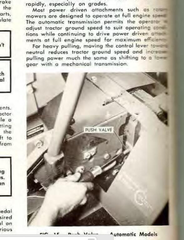

pfrederi 21,267 #2 Posted January 25 Hydro? Sunstrand ... Tow valve tightened up? Did you push the engagement lever all the way down? Belt running ?? Hydro input pully turning 2 Share this post Link to post Share on other sites
Joker72 96 #3 Posted January 25 Yes. Hydro Sustrand. Having trouble finding the tow valve. Going back out to inspect. Share this post Link to post Share on other sites

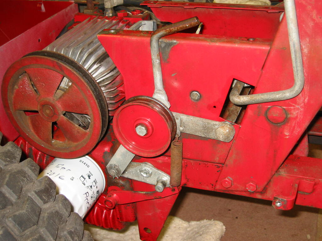

Ed Kennell 47,722 #5 Posted January 25 (edited) Belt tensioning spring broke. Roll pin on left side of the clutch cross shaft. Input pulley key. Edited January 25 by Ed Kennell 2 Share this post Link to post Share on other sites
Joker72 96 #6 Posted January 25 (edited) The push valve is not moving without soaking in PB blaster. I don't see any exposed pullys or belts to tell if it's turning. Did fully engage the lever again just for certainty. Thanks! Edited January 25 by Joker72 Share this post Link to post Share on other sites

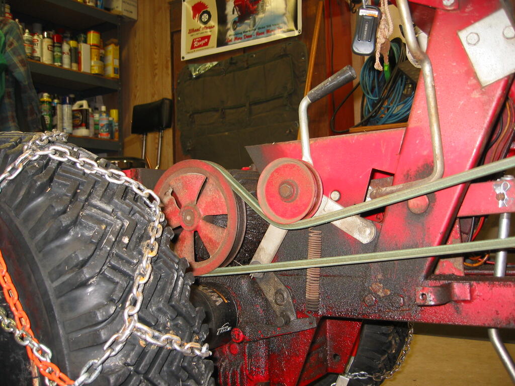

pfrederi 21,267 #8 Posted January 25 (edited) Rusty spring Edited January 25 by pfrederi 3 2 Share this post Link to post Share on other sites
Ed Kennell 47,722 #9 Posted January 25 First, like Paul said, with the engine running and the Hydro engaged, look for the transmission pulley behind the front of the rear right tire. It should be turning. 1 2 Share this post Link to post Share on other sites
