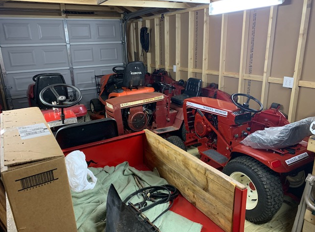

JoeM 10,071 #16 Posted January 20 Here in this corner of Pa., all structures have to have a permit. Temporary structures can not be anchored to the ground. So, I get a temporary structure and fill it with tractors, A man can not be to safe! 1 2 Share this post Link to post Share on other sites
